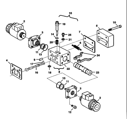

Manual controls or SJC?
It could be the solenoid or coil for that direction on the motor. You can switch the items marked number 2 in the attachment to verify. If the problem moves when you switch them you have found the problem. Take off the plastic caps, slide off the coil, and then unscrew the solenoid stem. Installation is the reverse. You can try just the coils first and then the solenoids. Or just switch it all the first time so you only have to do it once. They are sold as a set anyway.
Thanks, I'll give that a try
Changed the coils and solenoids on the left side …. no difference.

Pump tests good. Motor replaced. Swapping solenoids and coils makes no difference. Only thing left in my mind is the electrical input to the pump controls. Time to test with a meter.
