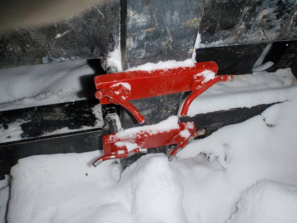

For you guys that live w/ trees that have tap roots, this may be useless, but for our trees is works real well. I can rip out almost any size stump in a few minutes w/ this, and it goes on/off quickly. Once the stump is torn loose, I can usually pick it up w/ the hook and haul it off; some are just so big I'd have to have the forks way too high for safety, but the littler ones are no sweat. Or, if I leave the tree on the stump, you can tear up the roots all the way around and push the tree over quite easily. This is just a big J hook (1 1/4" thick) welded to a box that slips over a fork. There is a stop plate on the back, as the forks always get funky back there, and w/out the stop plate the J-hook was binding; not a lot of fun to pound off, either. The plate on the front is just for that: to take hammer blows if the hook gets too much dirt or a stick jammed in it. Since I added the stop plate, I have not gotten the hook stuck. I found out right away that the fork needs to be secured to the back plate, so I welded four sets of double, 3/4" nuts to the back plate for that. The plates over the fork are approx 2" W x 3/4" Thick. I got tired of carrying a wrench w/ me, so I welded handles onto the 3/4" bolts. It isn't much, but when you have a few hundred trees to take out, it sure makes life simple and fast.

Nice job! I've thought about mounting a ripper shank to a quick-tach plate. How long is the hook? It looks about 2 feet long.

Thanks. Two feet is about right, but that would be on the outside. I could measure it if you'd like. Notice that I did not show any pics from the front? I completely fell asleep when welding it, and welded too much on one side, so the J leans to that side. Really wee'd me off, but then I've made bigger mistakes and survived. Serrations may help. I wonder how you'd keep them sharp? I guess you'd just have to keep grinding now and then. I should have beveled it a tad more when I cut it out, too, to make it sharper. Grinding is molasses slow.

I tried "heating and beating" but was unsuccessful, probably because I could just not get it hot enough. My rosebud pops and blows out if I get it too hot, and that is always a bit spooky with that acetylene bomb only 15 hose feet back. Maybe I need a new rose bud? Maybe I need someone else there to do the whacking while I handle the torch, too. Either way, I just pretend that I made it that way to cut the roots on an angle, so it's easier on the loader.... BTW: The J part is 20" long, 9" along the box that goes over the fork, and 11" across the hook. I should have that bucket extension all tacked together tomorrow. I can't wait to see how much better it works, IF it works.
