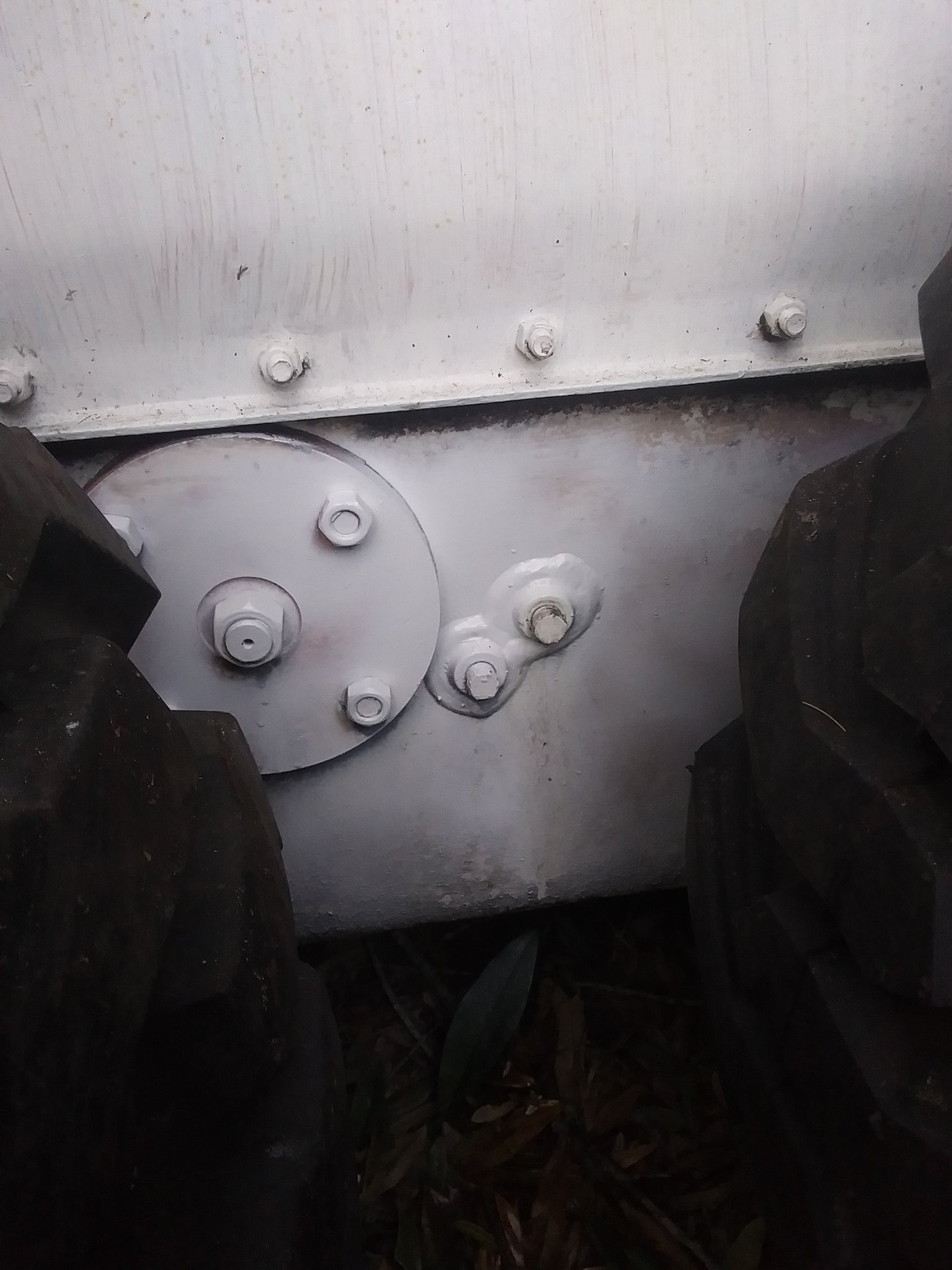

The plugs to check the fluid are to the rt of that circle cover.i open the top one and it was overfilled so i drained it until it was even with the hole.
Those are the high/low check plugs. Look for the chain case drain plugs at the rear in back of the rear tires. The rubber might cause it to be hard to see these plugs. When I drained my 722 I took the wheels off for easy access.
