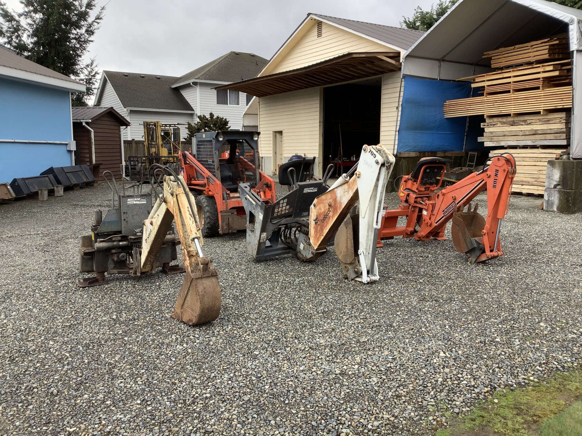

I have 3 backhoe attachments that all do different things for me. New ones are $20,000.00 from Bobcat. Lots of used ones out there, but they can be hard to find. I have wanted one of these for more than 10 years for my Thomas T-133. In March I found one locally and bought it. The Bobcat 709 was very, very well used, all cylinders leak. I have yet to rebuild this one and have named it “Papa”. Then I bought a BH108 from a guy in Canada, a few weeks later, which he delivered to me. I have done many changes to this one and used this to dig a pool for my sister a month ago. It is named “Mama”. The Bobcat 907 is the smallest and it is the ones I remember using in the late 1980’s and early 90’s when renting the 753 Bobcats from rental companies. This one needs a major overhaul including all the hard lines which I have been making with stainless steel tubing and steel ends. This one is named “Baby”.
Now, as far as worrying about the wear and tear on the boom, pins and other parts. I just do not feel it is that big of a deal. Is it going to be used for hundreds and hundreds of hours. Probably not so, if you grease all pivot points twice a day, what little wear on those parts will be minimal.
The 709 has modified stock brackets that attach to the main frame of the 133. The 907 attach ball points have been completely cut off since Bobcat main frames are very narrow and tall, where as the Thomas main frame is wider and shorter than a Bobcat machine. The 907 mounts hit the hydraulic lines on the 133, that is the reason why they were cut off. The BH108 that I used to dig the pool for my sister, only attaches to the boom of the 133 and not the frame of the machine like the 709. It works better being able to move from place to place with the attachment not being attached to the frame. Just my opinion.
Here is a picture of all three attachments.
