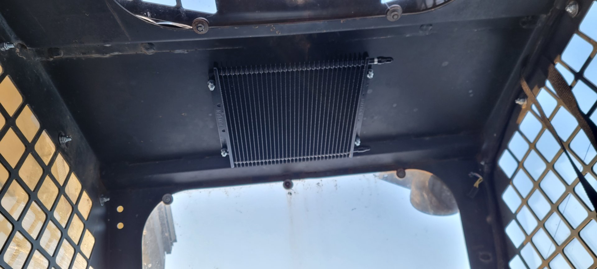

I'm putting my heater up on the van l cab roof of my 632, very similar machine to yours. There is a small hose coming off the thermostat housing and going to the intake above the carb... Tie it in that line.
Attached is as picture of the heater core. It is a transmission cooler for an RV. Suspended from that we'll be a 10“ fan. I'll be installing the switch for that in the switch panel, and wire it up to reverse. Then I'm plumbing the hose through a bypass valve with a control cable, so I can vary the amount of heat I get.
