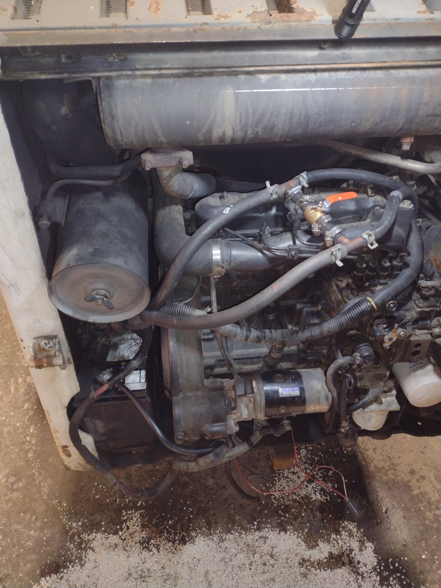

Hey guys I'm new here I've been working on a bobcat 753 there is no heat in the cab however the hoses going to and from the heater core are mostly cold so on these ones there's two hoses one from the thermostat housing in one from I believe the water pump or in that area now those hoses come off and there's a split looks like an H two t splits connected together now those hoses are hot before the split and then a couple inches after the split and then they just start getting cold I have taken out the heater core I've flushed it through the inlet and then again through the outlet still nothing I blew out the hoses going from the heater core not attached to the rest of it just the hose is by themselves still nothing any idea would be greatly appreciated
