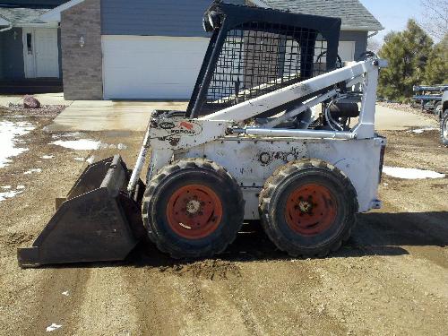

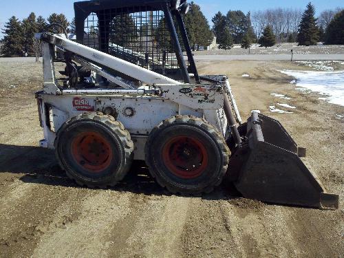

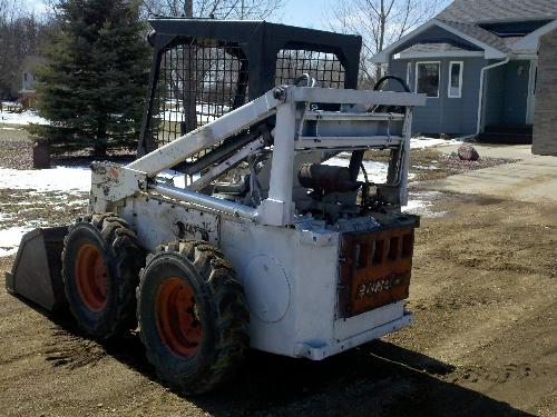

Here are some overall shots - not the prettiest face in the world, but so far starts right up and operates well! Hopefully she continues to do so - for my own sake as well as to keep my wife from killing me on this spur of the moment purchase!
Someone took a can of spraypaint to the back at one time - not the greatest job to be sure. I'd like to repaint it, but have read that it's pretty much a nightmare to do. Get past this first season as-is and go from there I think.

Not a bad looking machine actually, ou see some that look a lot more aged than that :)

That is one of the better looking 600 series machines. Note the original Melroe Bobcat decals. It's also got the early style wire mesh cage too. Later models had stamped steel. It's interesting that the cage doesn't quite come all the way down to the chassis. Definitely a pinch point there!
