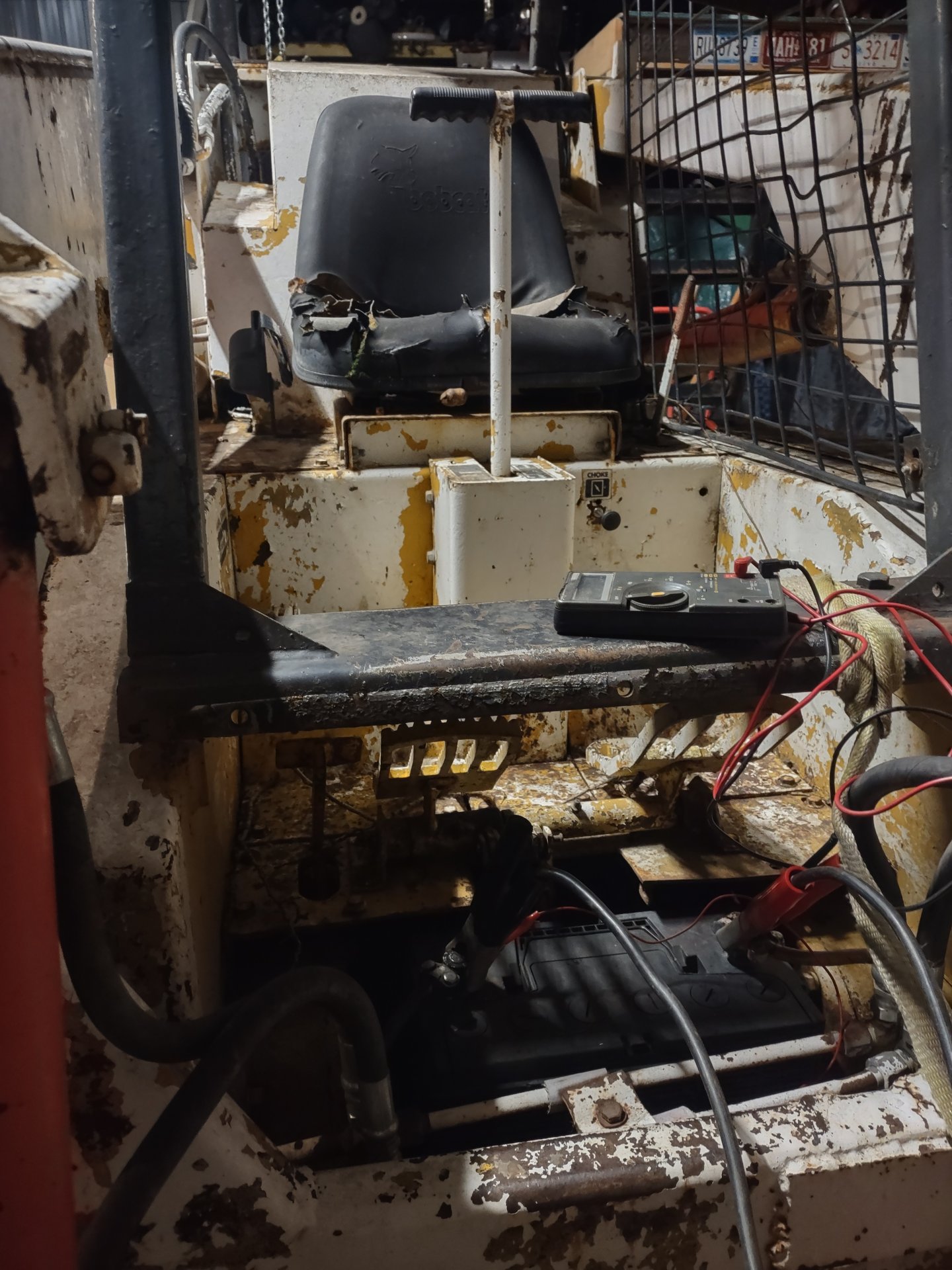

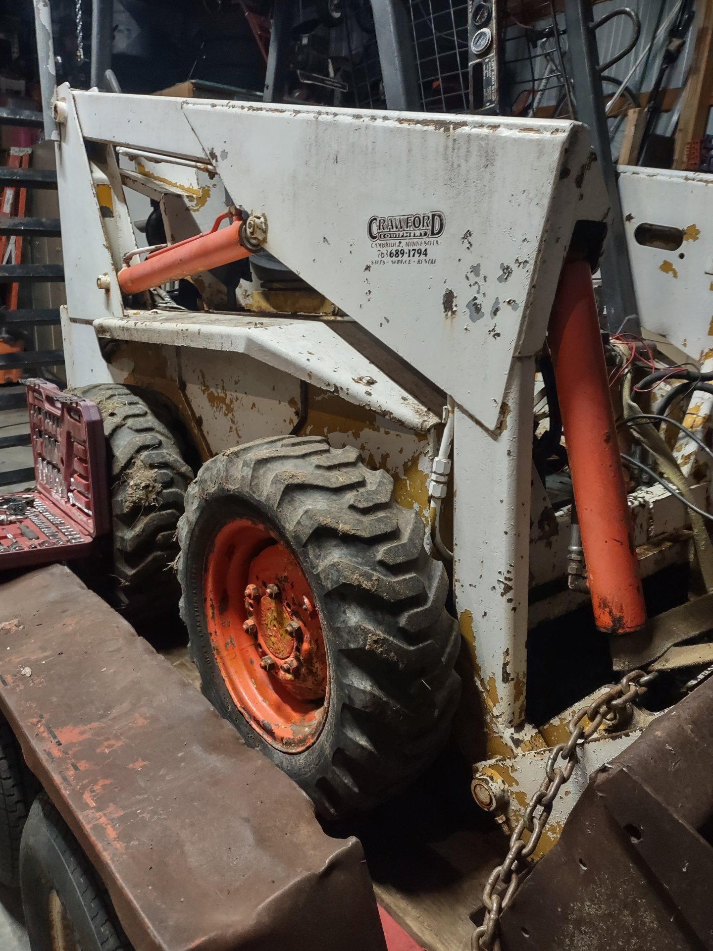

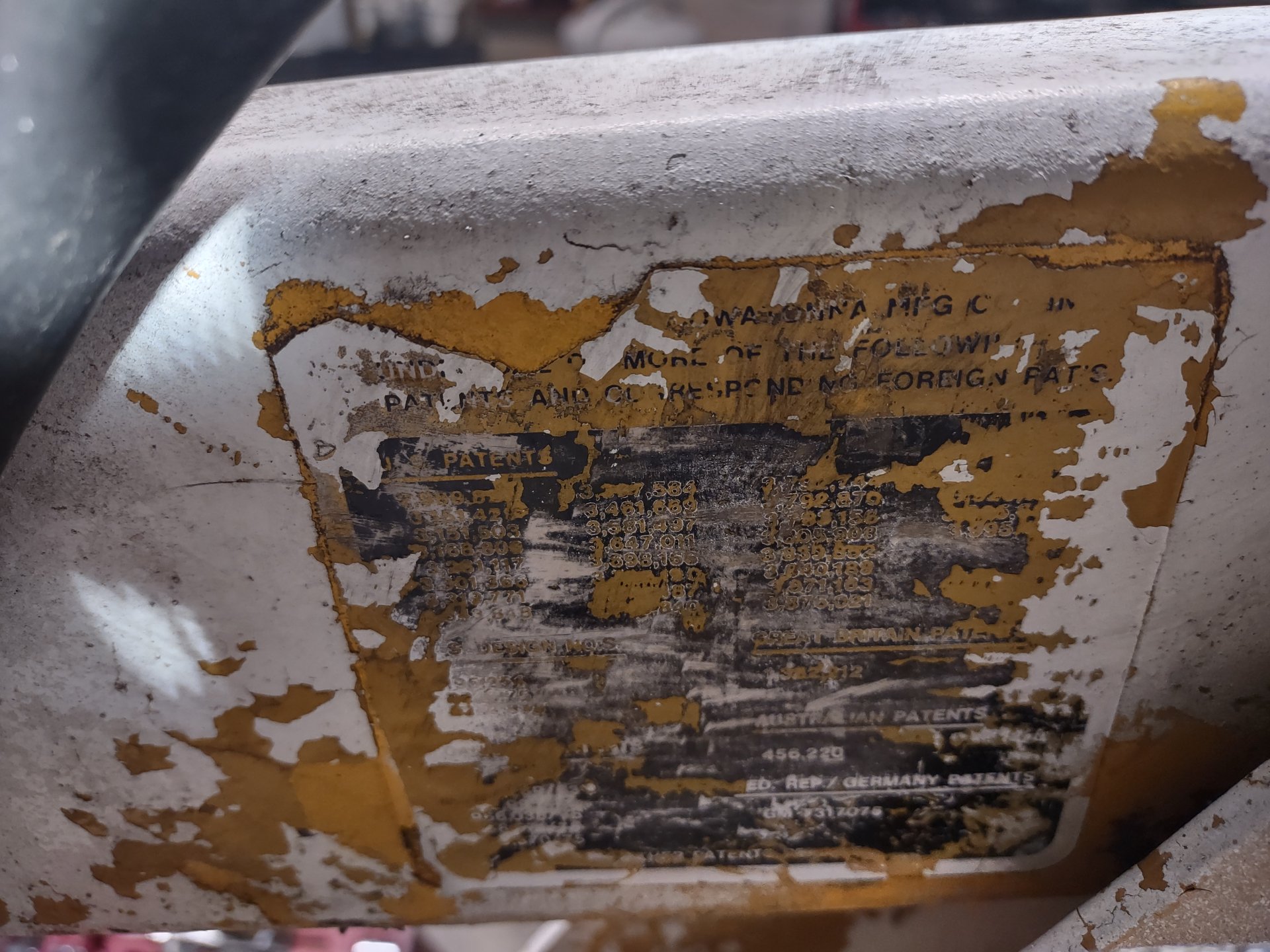

Just purchased this skid for a winter project. Cant read the serial number tag. Been painted over multiple times. If some one knows how to identify this I would be greatly thankful.

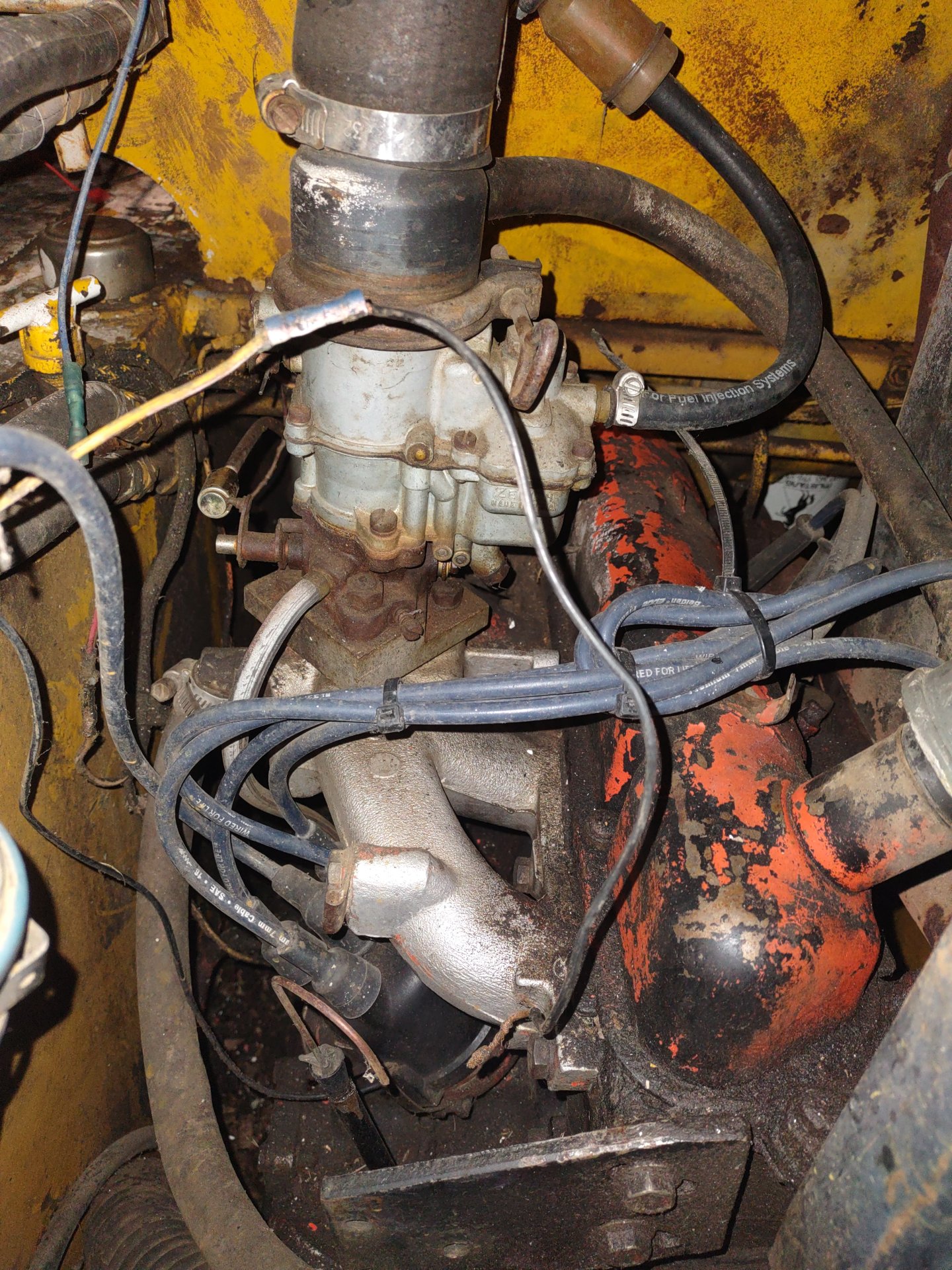

I believe it has the ford 1.6 in it. Previse owner knows nothing about it. Still have not got it running. No spark. No 12v at coil. Wiring has been chewed up. Turns over okay.

Got it running. Bad coil. Used it for about 20 minutes and the hydraulic hose in the bottom of the belly broke. WOW what a project to get at. Anyone out there that could help identify this. PLEASE Help.
it is a 440 made from 1974 -1980, there should be a vin tag on the rt rear tower under the boom pivot area
441 was the same loader but had a perkins diesel in it
Thank you for the reply. That was painted over a number of times. Any idea where I could down load a parts diagram?
