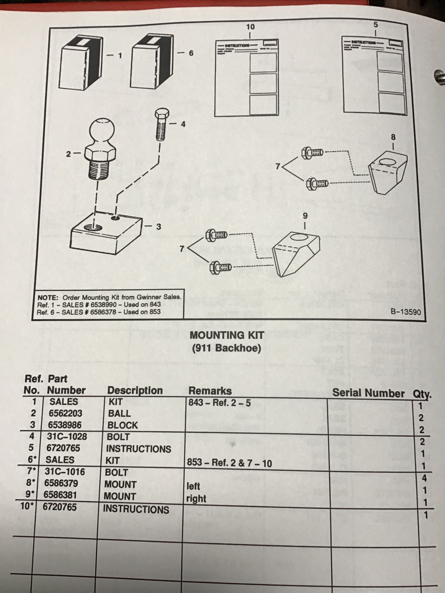

Do you have the mounting kit?
I have a parts catalog for the 911 if you want, I can take photos of the pages for you.

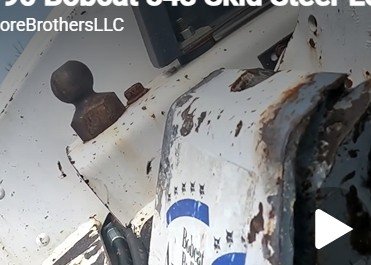

Here is a video that shows the balls on an 843:

Thanks so much! That video was very helpful. I would love any excerpts from the parts catalog as I need to do a lot of work on the machine I think. I wonder how those those balls are mounted and whether I can use regular 2 inch trailer balls. Is there anything else in the mounting kit you referred to?
Here is a photo of the Mounting Kit:

Thanks. I'm trying to guess where all those parts fit into the pic I got from the video you referred me to. Maybe I'm just really dense. Might there be an additional pic showing these parts in context.
The parts diagram is for both the 843 and the 863 mounting brackets. See the “Remarks” column.
The 843 only needs parts 2, 3 and 4.
