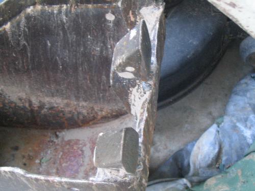

I used a set of old teeth off a 4 in 1 bucket that i cut the base out of to replace it. They are about 2” long anout 1 1/4” wide at the base, its also hard to describe. The bucket is pretty well stuffed and i want to make a few to replace it of vairous sizes. I have a few teeth i bought cheap at auction but i have no shanks for them. I think they may be a little big too, but i can always attack them with a grinder!! I don't want it for commercial work, just around the yard.
The teeth that are on it now are a little worn, but they were the best of what i had. They are MUCH better than what was on there before, 1 tooth and 2 shanks
I'll try and take a few pics of the teeth tonight.

Are the teeth pointed or flat?

They have a flat base and the point is more of a radius as its worn a little, i will try to take some pics
Shows a top and side view.
I'm sure they are far from ideal, but its what i had available one sunday morning.
These tiger or twin tiger, also known as frost teeth work good in hard ground http://www.falconpower.com/ampadv.htm.
Just remember how easy a awl drives into your hand compared to a flat head screwdriver.
I find new teeth just make it work like a new machine. Sometimes if you have a problem keeping a straight edge in the hole you can put the twin tigers on the outside, as they will reach to or past the edge of the bucket, and then put the single tooth in the center. In out area they are about $10.00 each plus another $2.00 for a new pin. I always buy one extra tooth and pin just in case I lose one. Just think of them as fingers. Yours look like they are cut off at the second joint. Imagine trying to work with fingers like that, it works, just a little harder to do.

I will look into that for my new buckets.
I agree, the sharper the point the easier it will be to cut.

Those teeth look worn out.
Eric, they most certainly are. They were off an old 4 in 1 bucket. I need to build a few new buckets that i think will get the correct teeth attached to them. This bucket is in bad shape but works ok for what i'm using it for.
