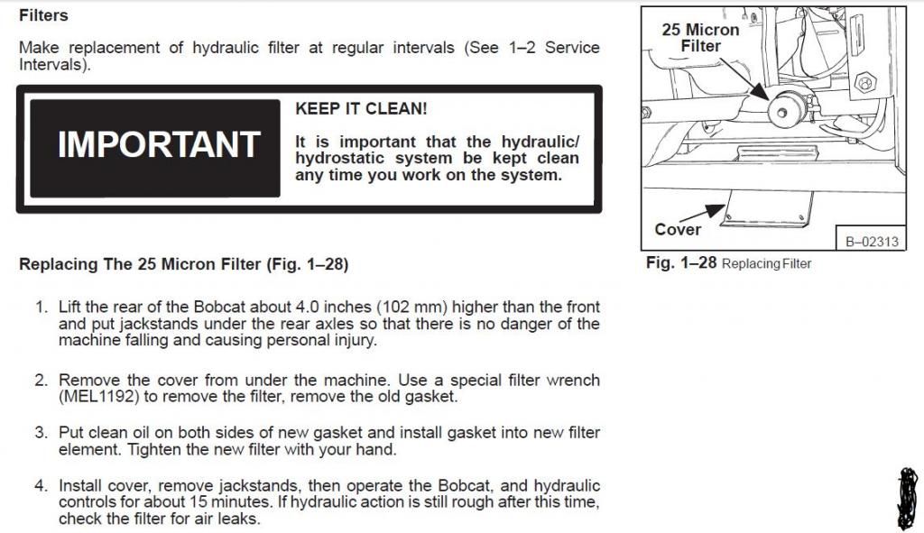

The MEL-1192 filter wrench is just a metal band type that you can use a breaker bar with.

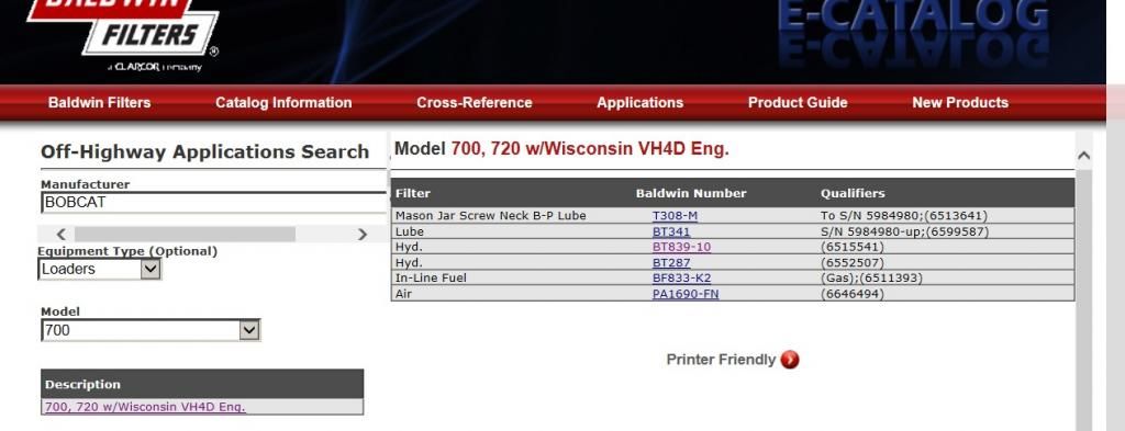

Hopefully you have the filter off by now. Here is the cross reference to Baldwin filters. You can normally cross the Baldwin numbers to whatever brand is available easier than you can the Bobcat numbers.

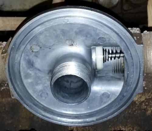

It looks just like an oversized oil filter, 5 inches across. Here's what the mounting side looks like.
Grabbing it as close to the seam with a chain wrench would probably be the best way to get a really stuck one off. The center thread is about an inch and a half, not sure if the pipe nipple will come out with the filter, I've seen it happen on some oil filters so be aware of that and anything that might be behind it. More likely it's just a stuck rubber gasket that didn't get oiled when installed.

Flyerdan, That is a very good picture, Gives me more of an idea if I need to get the chisel after it. My neighbor is coming up this evening with a different band clamp. He works for a company that has larger equipment. Again thanks for all the help. Dwight Iowa

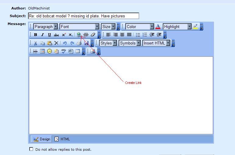

Here's your picture. To add a image to your posts just copy and paste it. Right click in a image stored somewhere on the internet and click copy, then in your post right click and paste where you want it.
Also for links to be active you need to hit the space bar after them or use the "Create Link" button on the Editor.

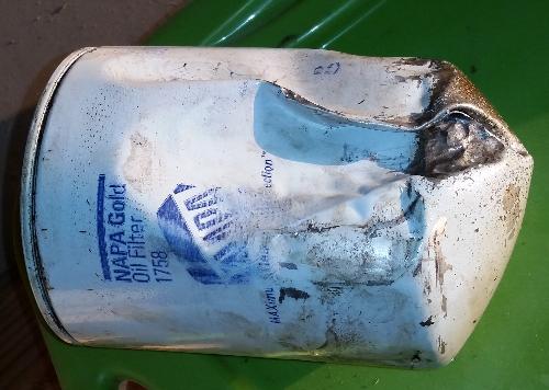

Here is a pic of the mangled filter too.
