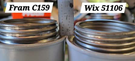

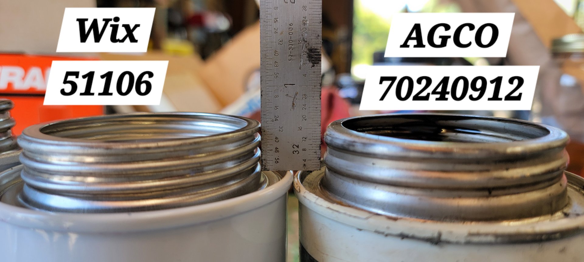

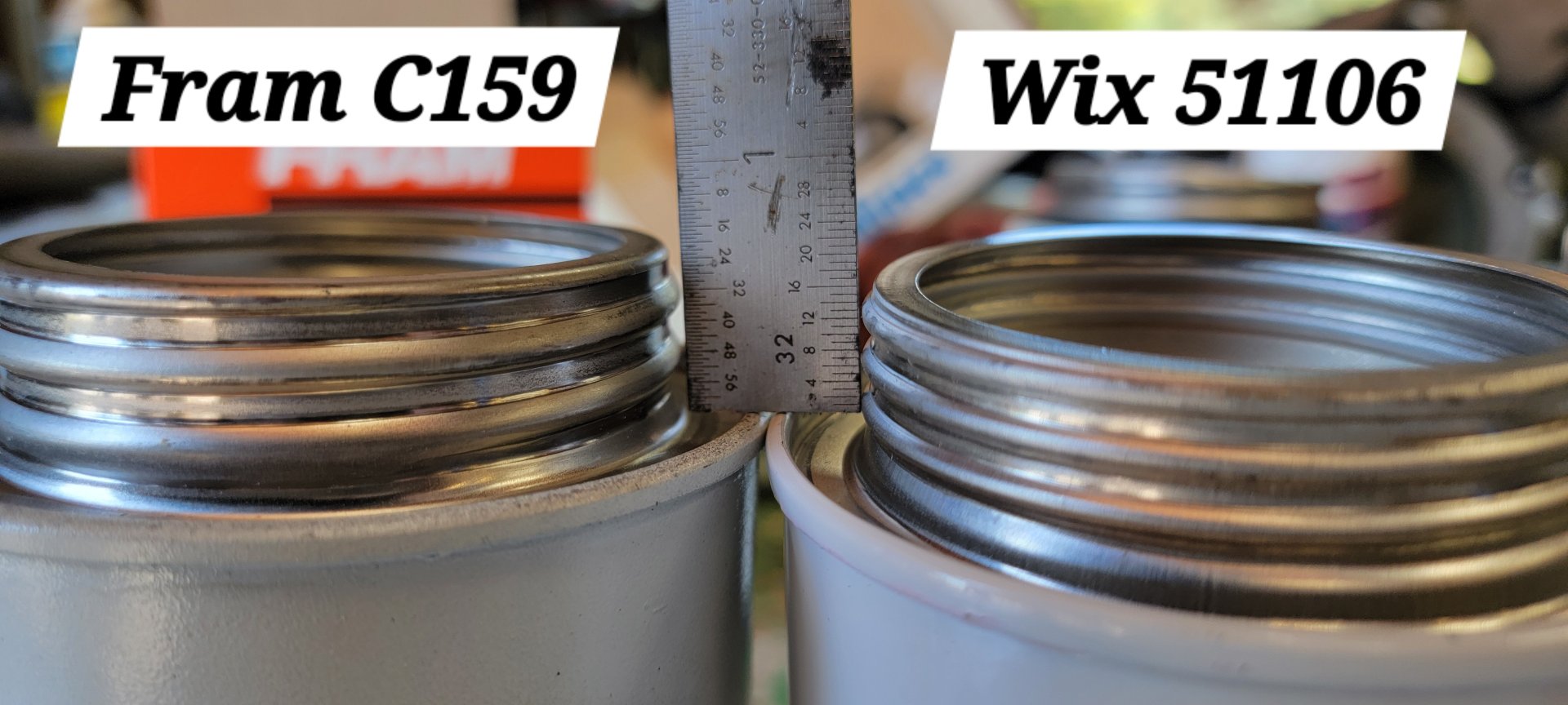

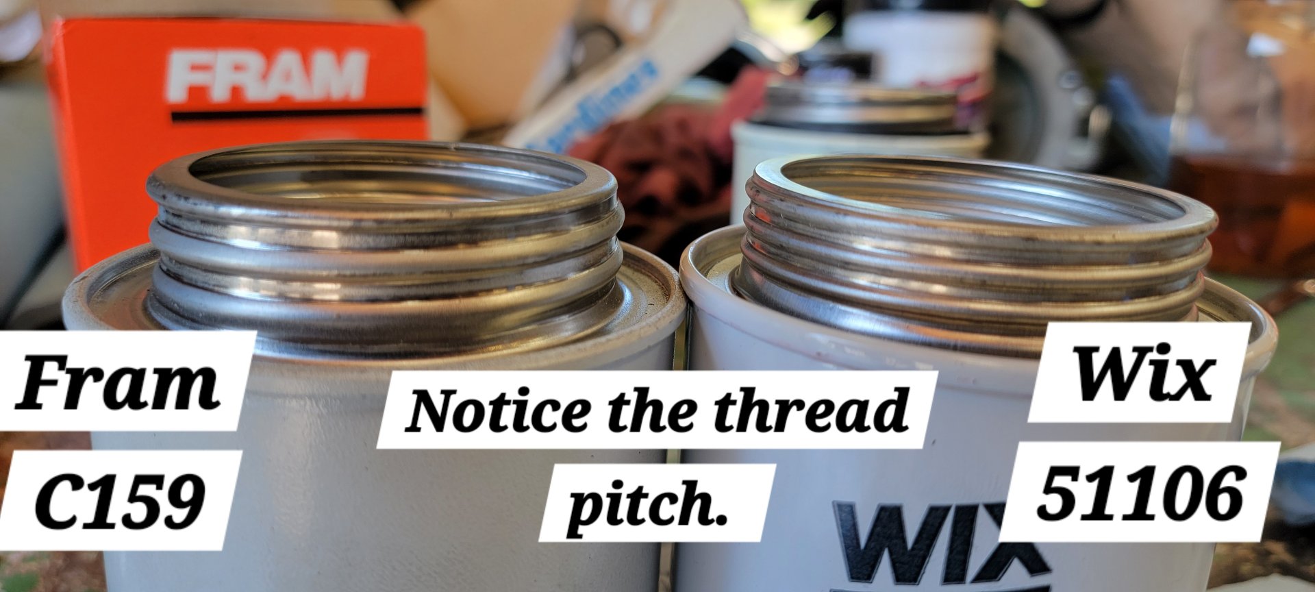

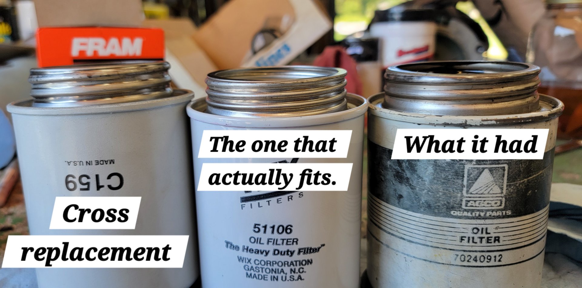

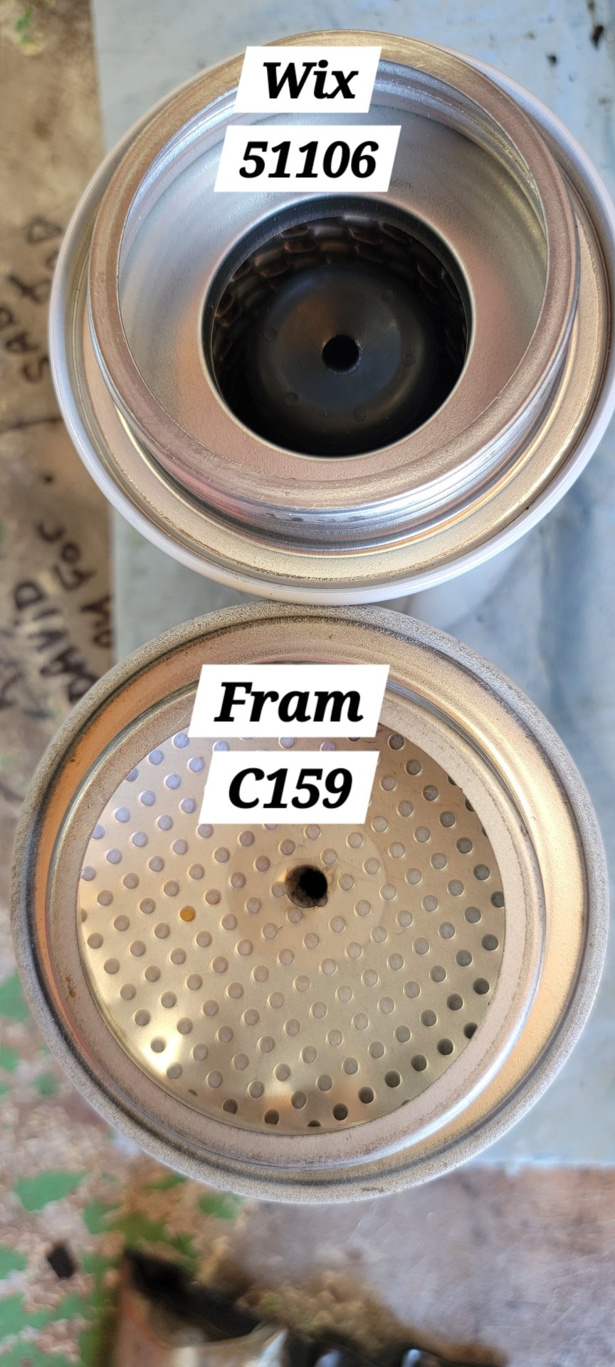

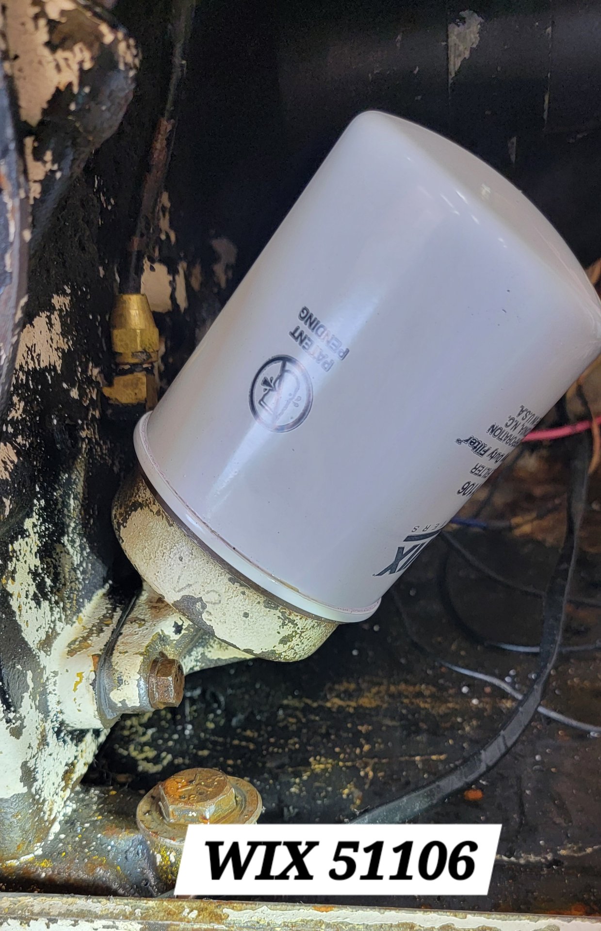

And some of you may know. I've been working on my friends m700 bobcat. With a Wisconsin vh4d motor on it. And I saw in another thread somewhere about getting the right oil filters for it. And some people were complaining that the oil filters were leaking. Or they couldn't get it tight enough. But what I found. At least in my own experience here. Is that not all mason jar type filters, fit the same. Some have a different thread than what the Wisconsin calls for. The one I found that fits correctly is a WIX 51106. It actually screws in all the way. And seals correctly. The Fram C159 does not. It's thread pitch is wrong. As is the AGCO 70240912.
