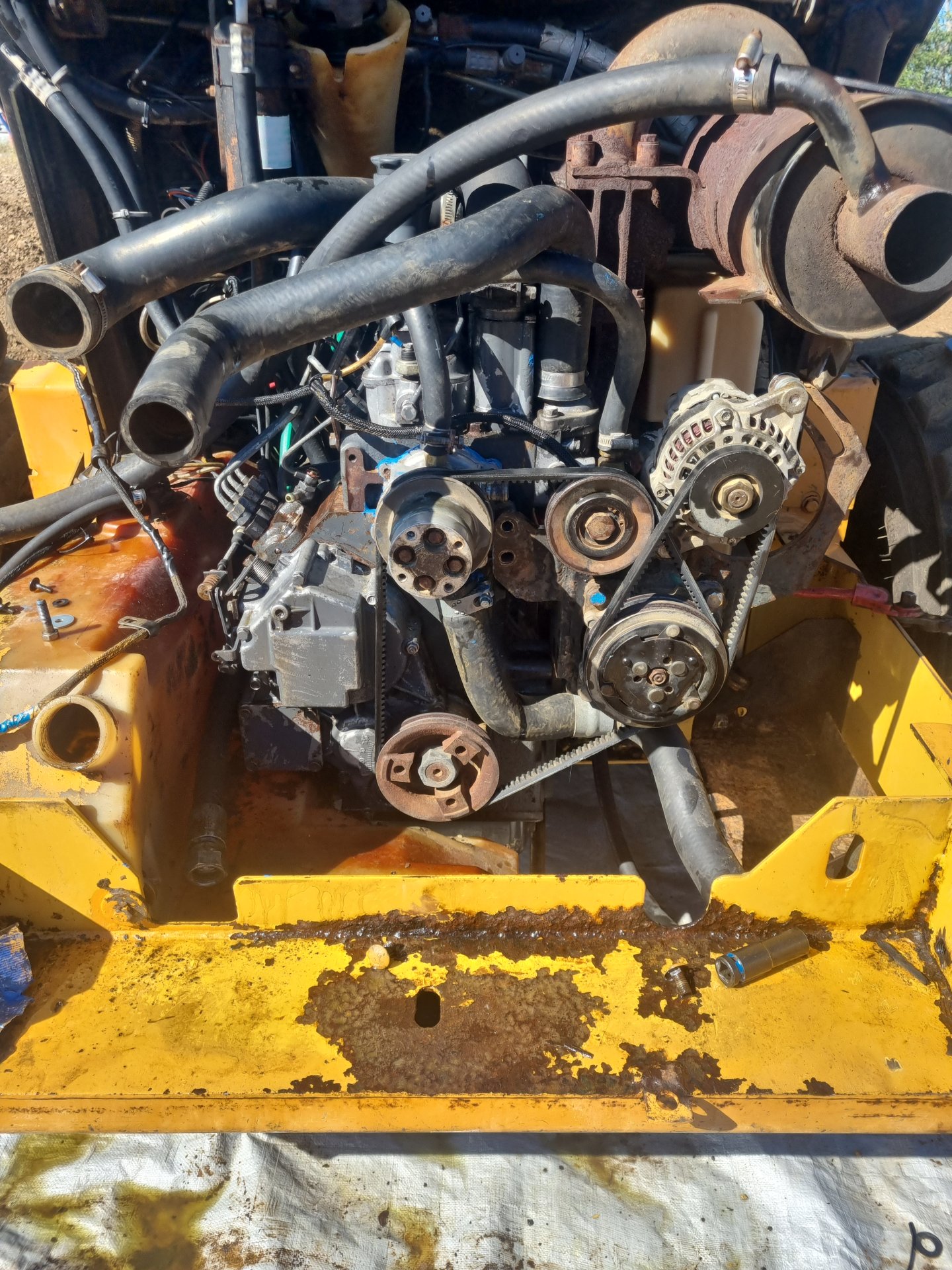

I purchased the online manual and seen that four bolts on each side release the radiator and oil coolant assembly in one frame piece. going to try to finish disassembly today so when new pump arrives Wednesday or Thursday from Kumar's I'll be able to reassemble
I pulled the whole back off in one piece
