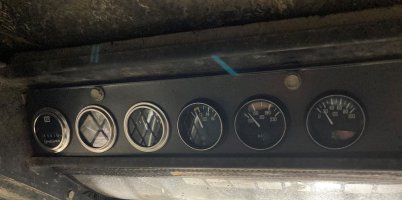

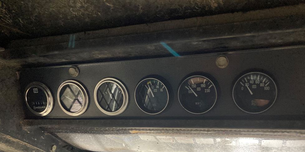

I nearly done retrofitting the electronic dashboard with steam gauges. It wasn't too difficult but it would not be easy without the wiring diagram. I used SW gauges with a Speedhut tachometer. I matched the sending units to the gauges except for the fuel gauge. In this case, I matched a gauge to the sending unit in the tank. I used all of the existing wires to the dashboard and didn't have to run any new ones. If anyone has questions or wants pictures, please reply and I'll share.

I connected the seat and seat belt interlock in series with the hydraulic enable solenoid. The emergency brake handle is wired to a small buzzer to remind you to release it before use.

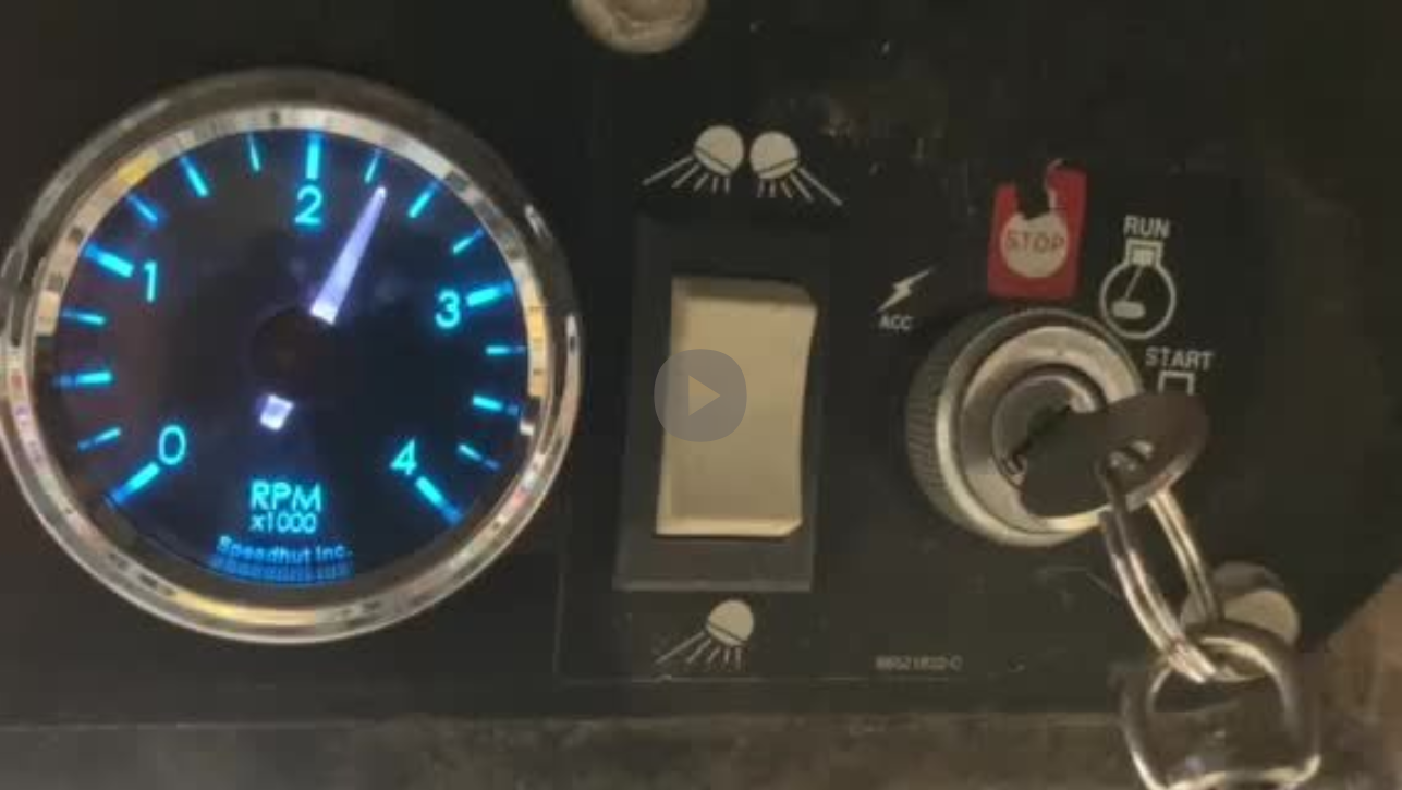

The tachometer video for the dashboard retrofit of my LX565 is still online.
