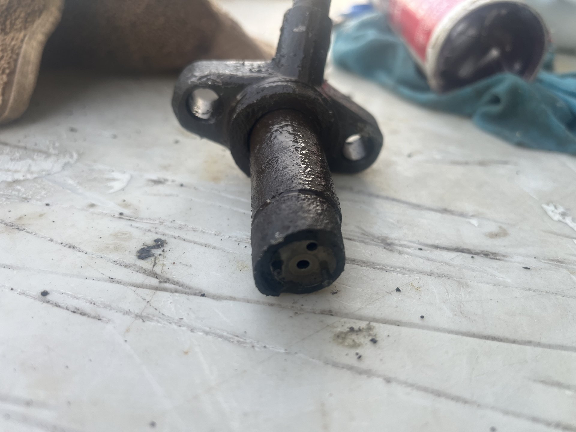

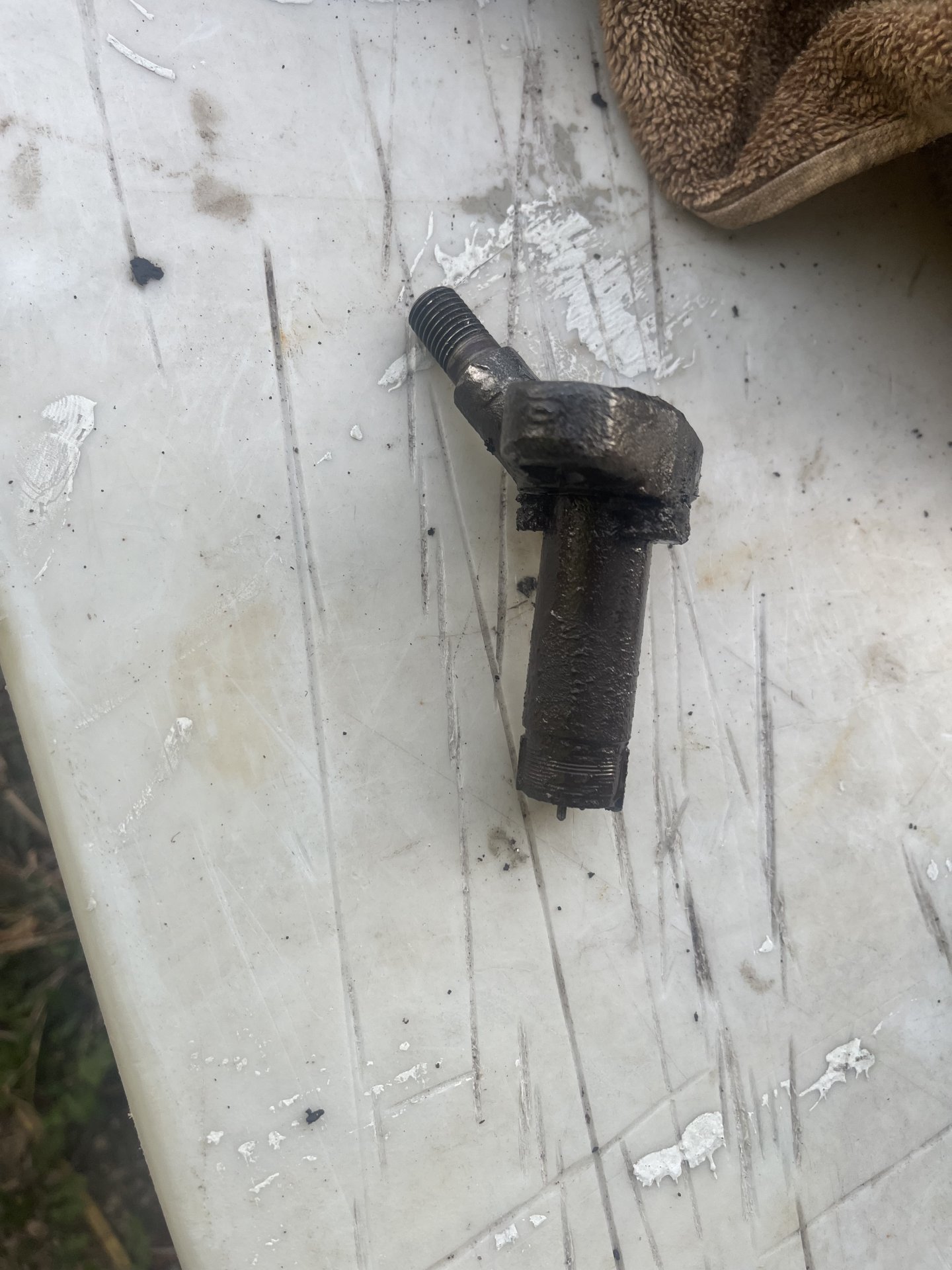

I took the lines to the injectors loose one at a time and had fuel but when I had the line loose it would try to die. Is that normal?Loader will run at an idle but engine won't speed up when throttle is moved. I have pressure coming out of the fuel pump but have not checked at the injectors yet. I recently changed the fuel filter. What else do I need to check?
