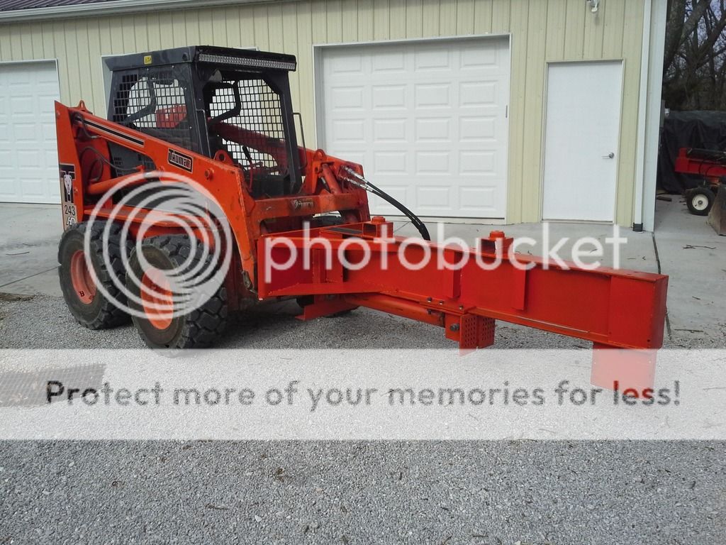

I bought a 3 point log splitter and converted it to fit my skid steer. It is made from 7 X 14 X 1/2 beam reinforced and VERY heavy. The wedge is 9.5" tall. It was in SAD shape when I bought it and took me about 3 months of off and on work to get it finished. Here are the videos I posted to youtube of the build process and the splitter in use. https://www.youtube.com/watch?v=nwWDjmbBR24 https://www.youtube.com/watch?v=10QCo7tiv20 https://www.youtube.com/watch?v=RI4hCjxI0Nw

I made mine the same way except that the wedge moves. That way when I split the wood never moves way from me. Looks nice though.

The angle iron welded on the sides eliminates i-beam flexing. Of course, a 7 x14 x 1/2 i beam helps. I will post some vids of the log splitter used sideways when I get some more wood.
Hello, if you go and see my thread on the backhoe you will see where member Vitto told me to down load a program to post pictures on here , i post mostly gifs now it easier than trying to post several pics . your splitter turned out good from what you started with . i built a splitter to but i converted it back to a 13 hp motor as i needed the bobcat for others things during the wood season . the tires you are running how do you like them as I have a set coming for a S570 ?? 1 of U
