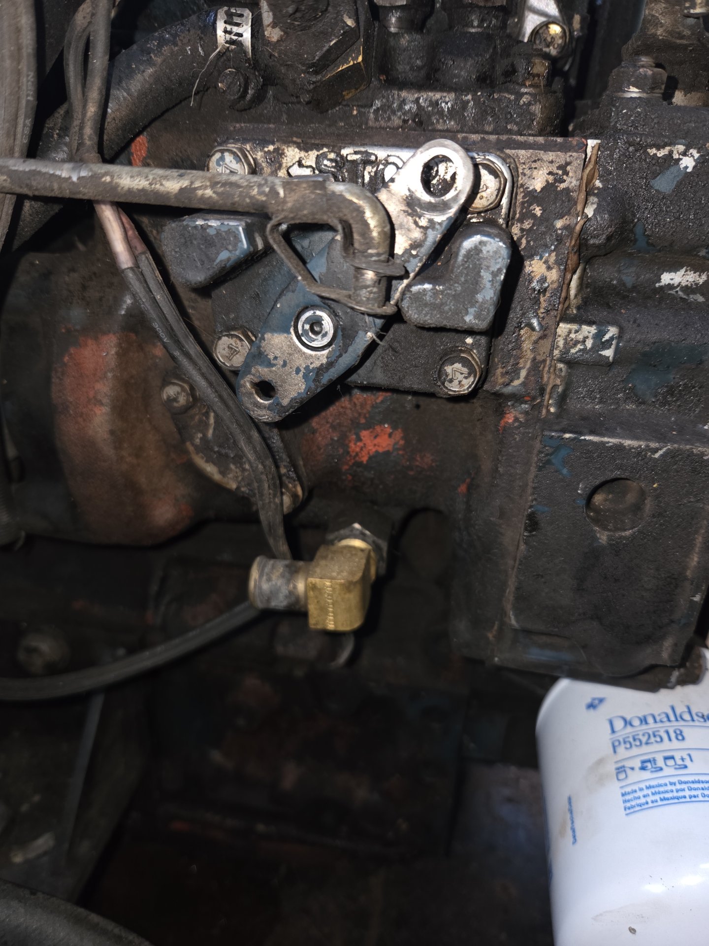

Below the injection pump there is a brass fitting that looks to be about 1/2" that i am unsure what it is for?

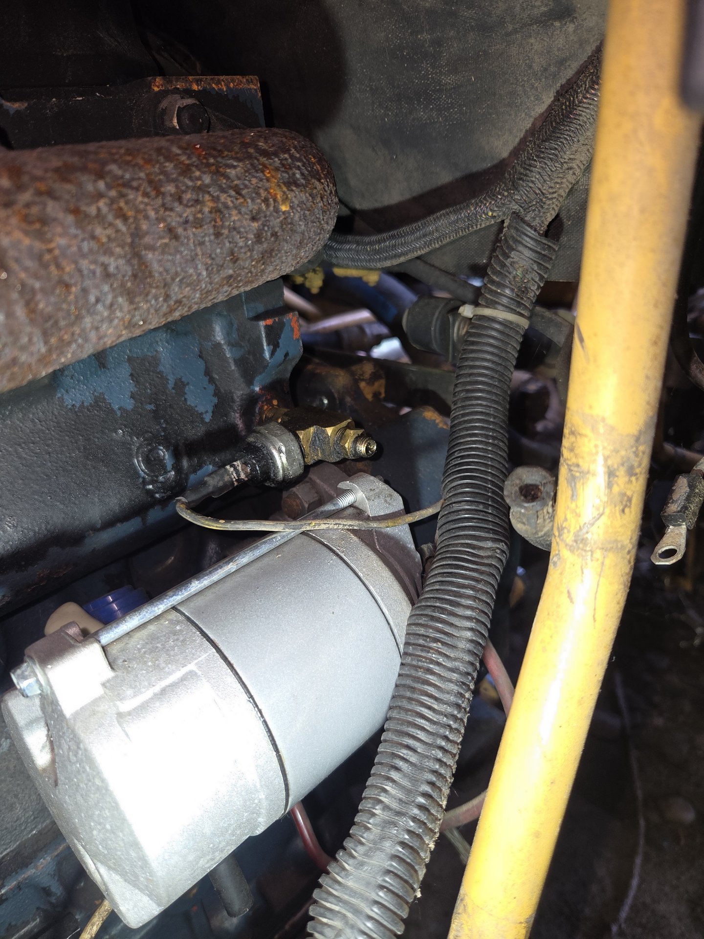

Right above the starter there is a sensor and a fitting that im also unsure where it would go?

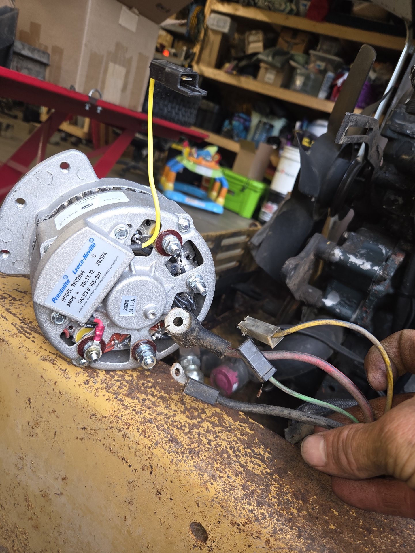

It was tough for me to figure out exactly what alternator i need but i ordered one and i figure itll probably work but im a little confused on how it wires in.

Fitting above starter could be oil pressure switch? On L555 (Kubota v1902) the wire is Yellow/Black, I believe. Wire should probably go to warning light. Light on when key ON, engine not running.
I might be wrong but brass fitting near lift pump could/should be coolant drain cock.
Probably have temp switch at front of engine, near alternator (?). If this has no wire, then one of that bunch might be it. Might be Yellow/Dk-Green. Mine were floating around, disconnected. Great fun tracing them.

Awesome. One step closer! This motor is also the v1902. So your oil pressure switch just has the sensor and wire and no extra fitting like mine?
I will look into finding a draincock to replace that coolant fitting
And also will check that temp switch for an empty terminal.

I agree with andyDWA on the oil pressure switch. Looks very similar to the one on my L785. That’s all I got. Don’t know much about the L5- - series. Messicks online is a great source for diagrams you can access that help.
The silver part looks similar to the original oil switch. Maybe they installed the tee to connect a gauge?

Here's my oil switch. Also a pic of my two-wire alternator. The 'yellow into black' wires to the left go to the temp switch. The 'yellow' wire on the right goes from alternator to the warning light - and I believe doubles as the excitation wire. The green wire is disconnected. The red goes to the battery via the starter motor. (I think that's all right). I don't know whate the cut black wire is for. Possibly safety-seat related as mine was all removed before I got it.
Probably not a lot of use to you. Interestingly, the diagram calls for a three-wire setup.
