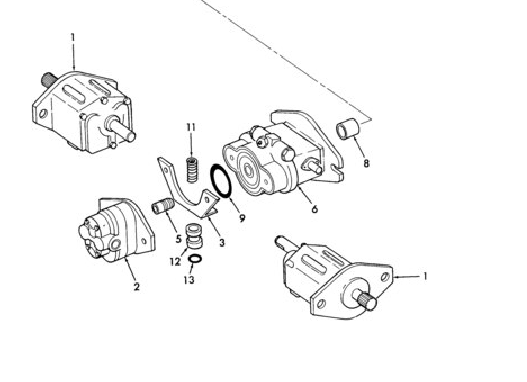

A smooth, clean mounting surface and a gasket should do the trick.
There is an oring part number 272310 that goes on flange of the pump
