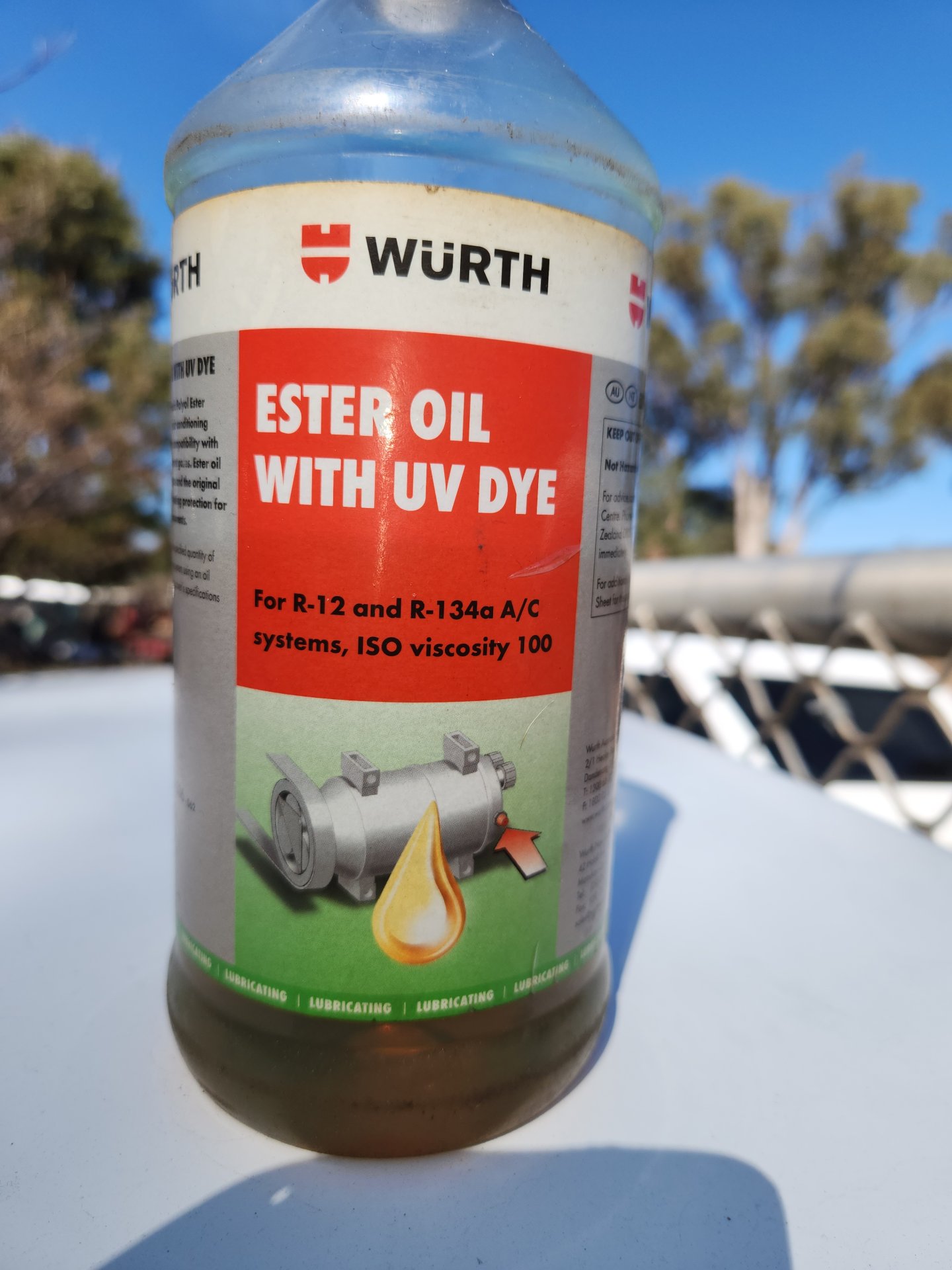

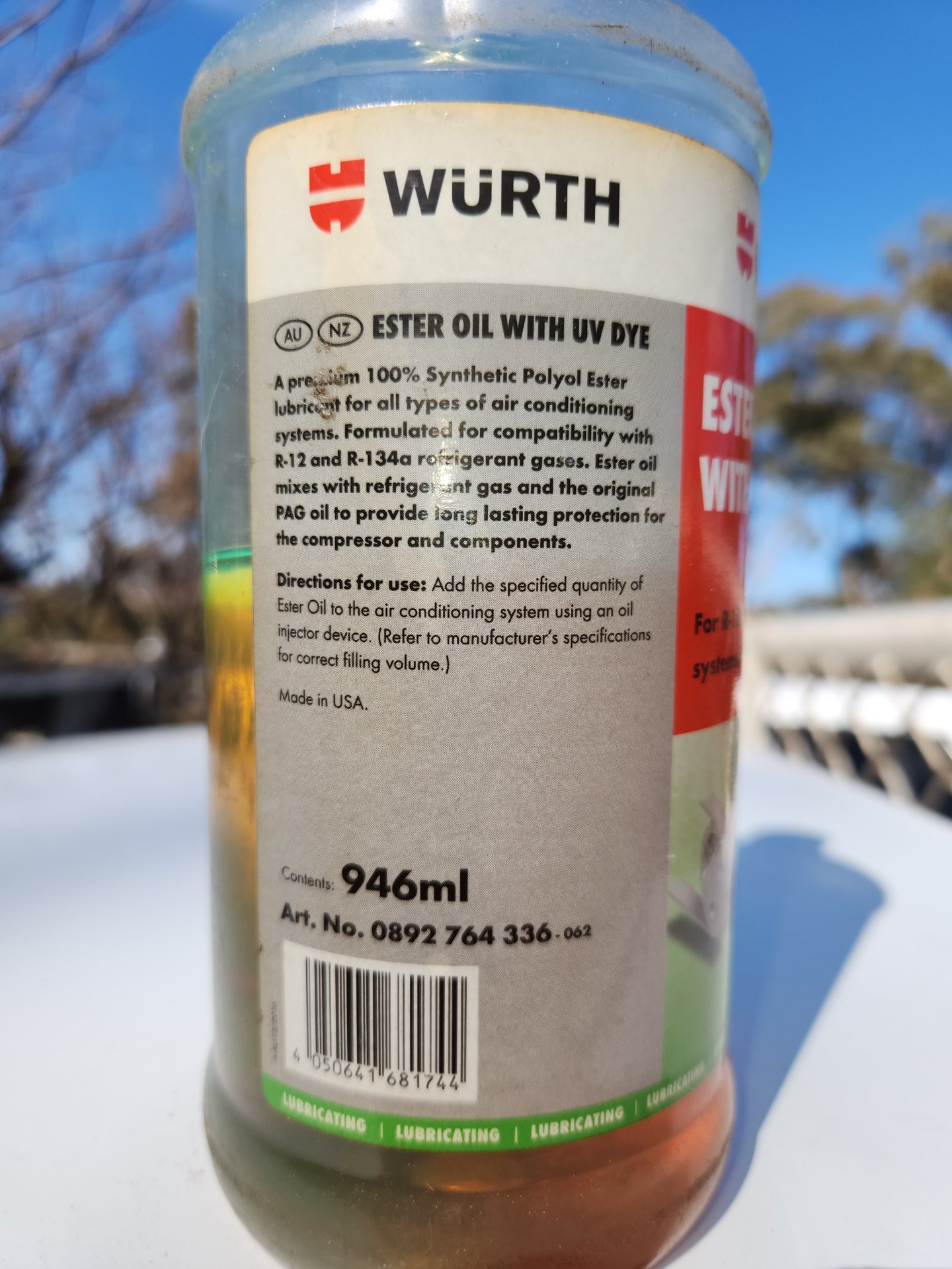

I take it A/C dye isn't the right dye !
Will it damage the oil or pump components ?
I wouldn't use that in the hydraulics. Ester absorbs water at a high rate and you could wind up with streaky oil and possibly clogged filter. Just get the right stuff and not worry about it messing something up
THANKS CHRIS

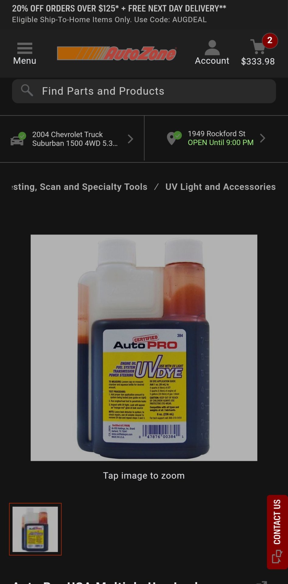

This is what Russ is talking about. Atleast with this you can use it for all your fluid finding needs. It's $30 here, I haven't looked at amazon. Been a busy day.
Not trying to butt in Russ, I had the pic up already just hadn't sent it yet. Hope you get it found!!! I hate leaks and squeaks!!!
