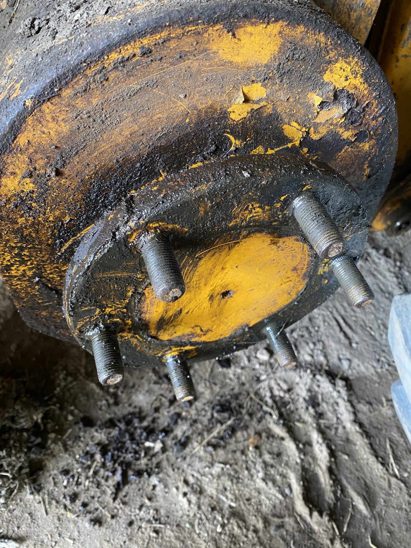

I have to change seal of wheel. How I have to change it? I have to remove main pump?
    818.6 KB
remove the t bar, and remove the chaincase cover and u should be able to access the nut that holds the sprocket to the axle ,remove the
axle then you can access the seal
Thanks. Do you have dimensions of this seal? And dimensions of bearings cone and cup?
