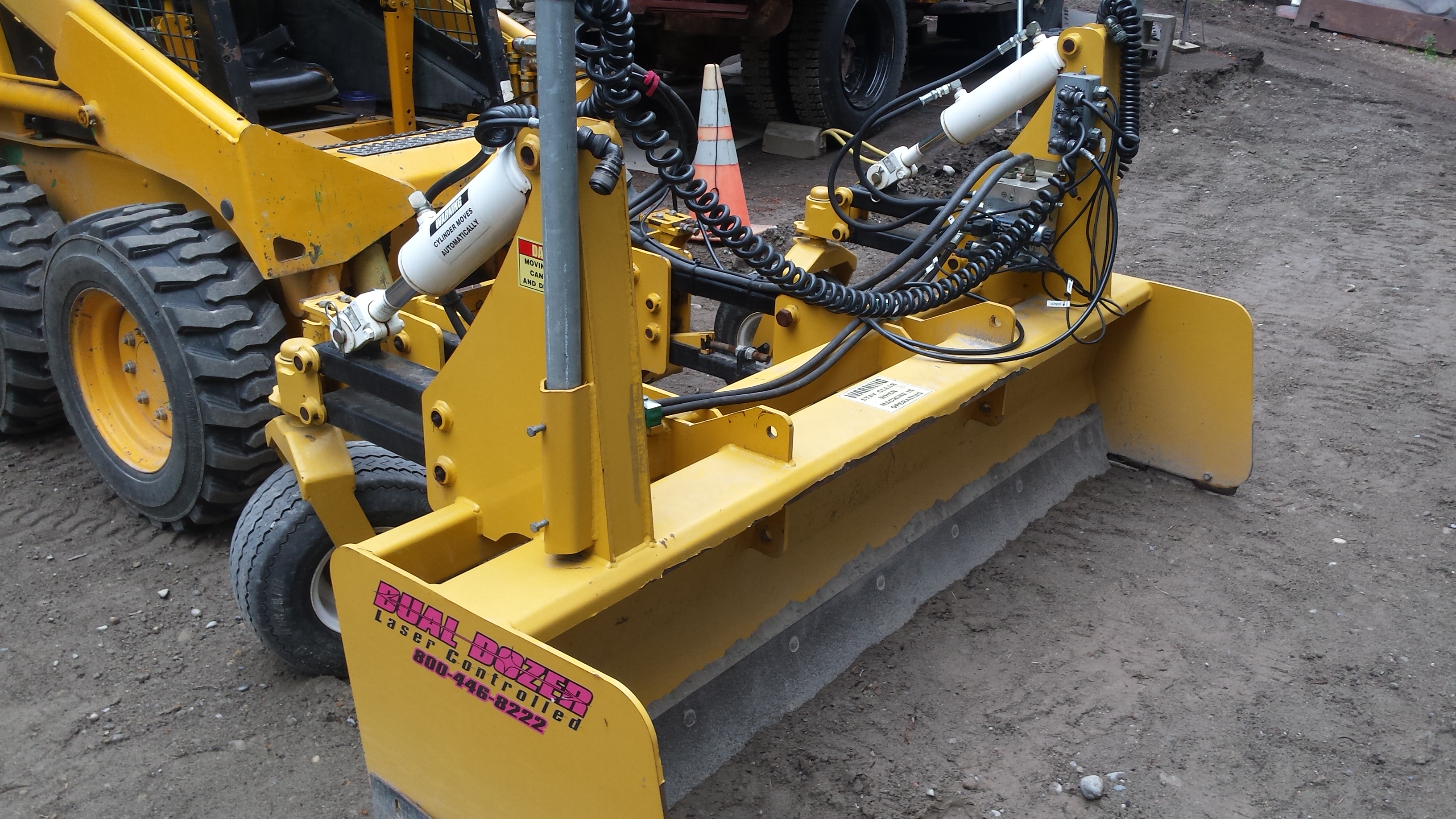

I use one of these gadgets. Puts a perfect crown on it too.

Nice! I would like to get something that allows me to angle my attachment like a grader or bucket. This thing in the link is pretty slick.

very nice and I am sure it does an e excellent job, and can make a crown what ever one wants
its similar to the one I used that my buddy had
but for the average home owner, the costs of things like this are way too high, you need to be making money with something like them IMO to justify buying!
or get really lucky finding a good used one for sale really cheap!

I got very lucky. Got it from the second owner really cheap. Only problem is that the Trimble laser receivers are no longer supported since everyone has gone GEO and GPS, but it still works great. I can get 1/4" over 700' with my Topcon RL-H4C rotary laser.

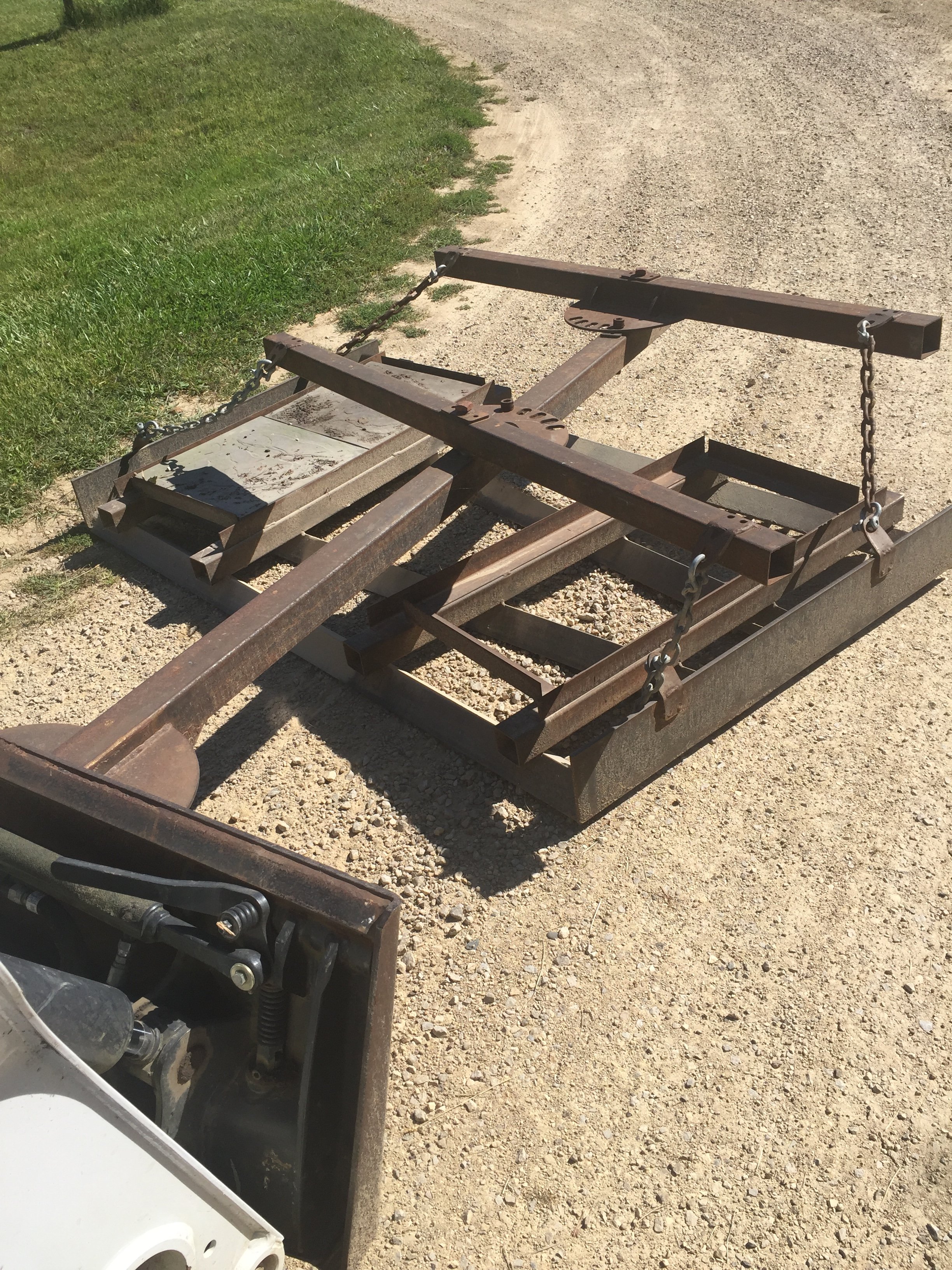

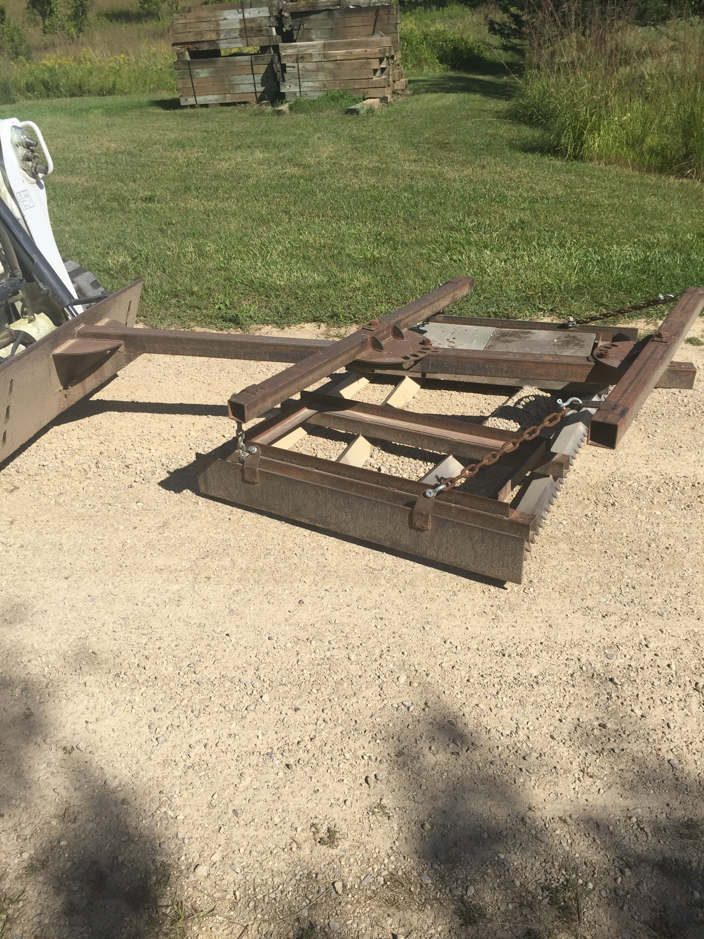

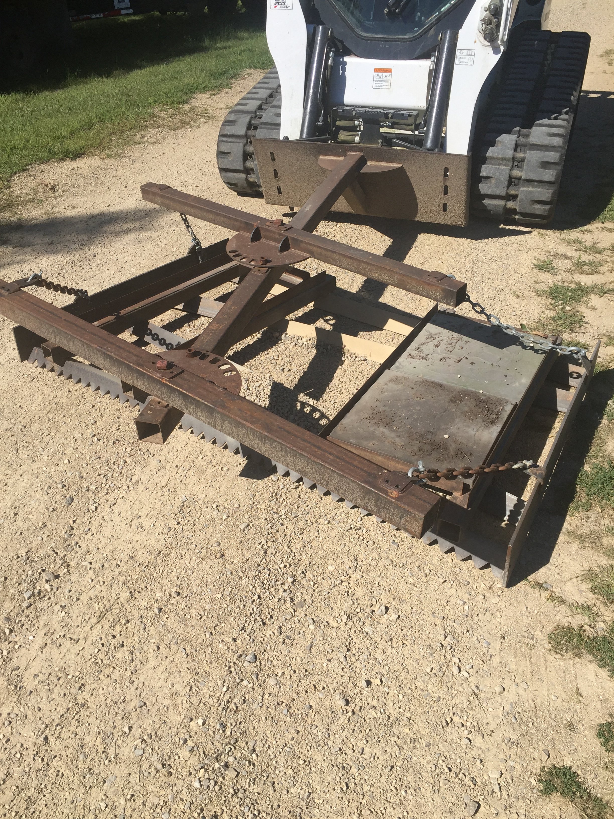

Here are a couple photos of my homemade gravel road dresser. I hang it from chains attached to a support extending from the front of the skid steer. It rides up and down on the surface as it drags and smooths loose gravel. Because it rides in front, the operator can see and control what is happening. No hydraulics or electrics. It can be made to shift the gravel to either side and takes weights to increase the bite on either side. It really works.
