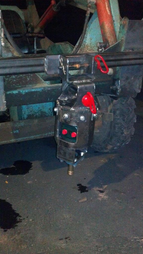

Finally got some images put up online, Heres the pic of the machine, I'm gonna repait it when I get a chance, I should of done it when I had the motor out but it was actually really easy to pull other than the fact that the Tombstome on the back of this thing predates Hinges,
http://i1295.photobucket.com/albums/b639/Jd_Ricklefs/TheMachine2012-10-27_13-09-42_412.jpg
just finisned welding together
http://i1295.photobucket.com/albums/b639/Jd_Ricklefs/2012-09-29_19-38-41_357.jpg

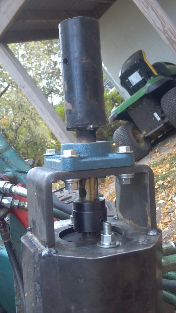

Drive Hanger 1st attempt, It ate itself.
http://i1295.photobucket.com/albums/b639/Jd_Ricklefs/2012-10-06_10-35-34_317.jpg

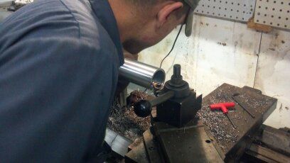

2nd and final attempt at the Auger Drive Mount/ hanger
http://i1295.photobucket.com/albums/b639/Jd_Ricklefs/1349581110309.jpg
It works out pretty good. Had a friend machine it out of some old parts that we found at the local salvage yard, Didn't cost a thing other than the 12oz friends that didn't make it.
I wish I would of taken more pictures from start to finish, would of made a better write up.
That's pretty cool. I love seeing these older machines being put to work. Nicely done on the auger too. A lathe is a handy thing too. I wouldn't be without mine.
