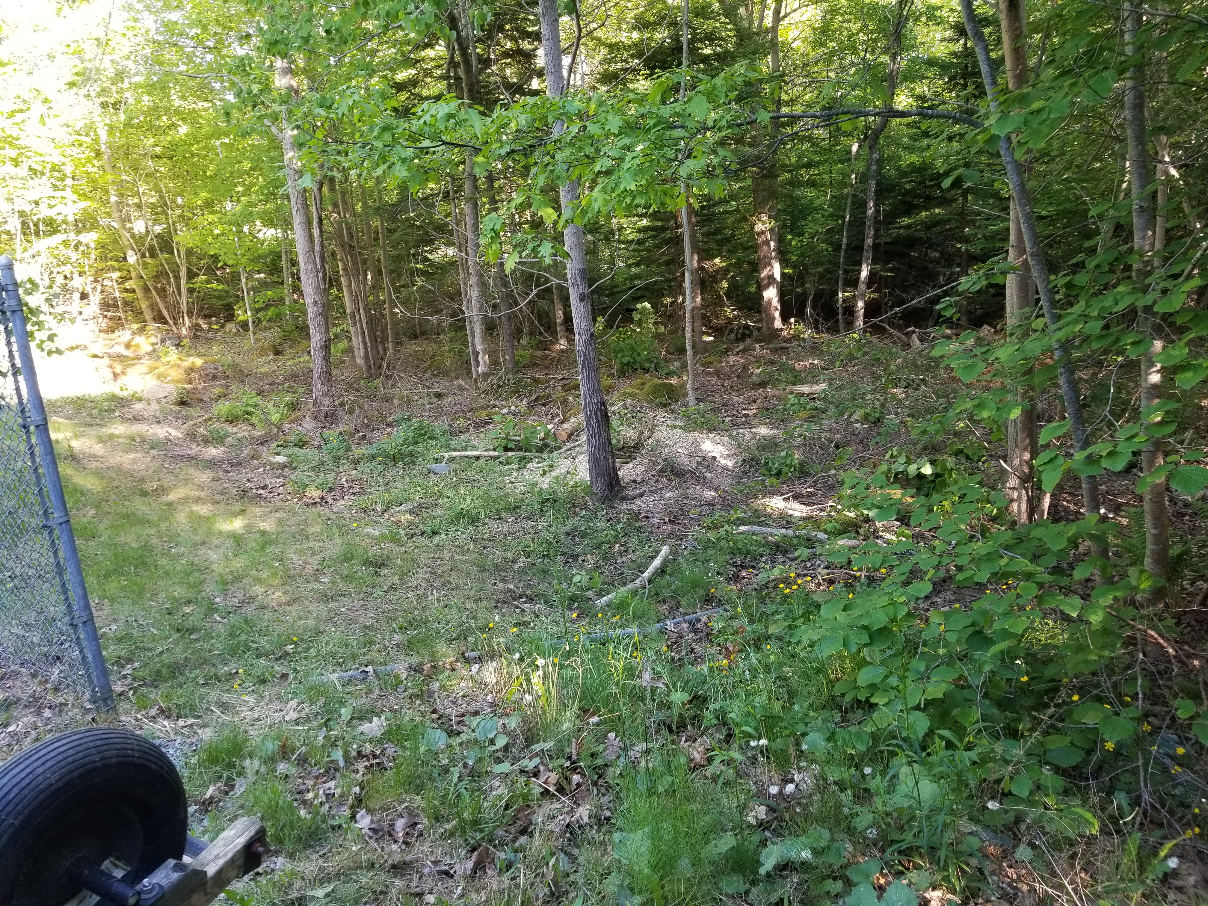

Looking to buy a used skid steer, have never owned one before. Looking to use it to push dirt around to to extend my backyard, where I have cleared a bunch of trees under 3 inch. I will be bringing fill in as well to level it off with my existing yard. It will likely also be used to plow the driveway in the winter.

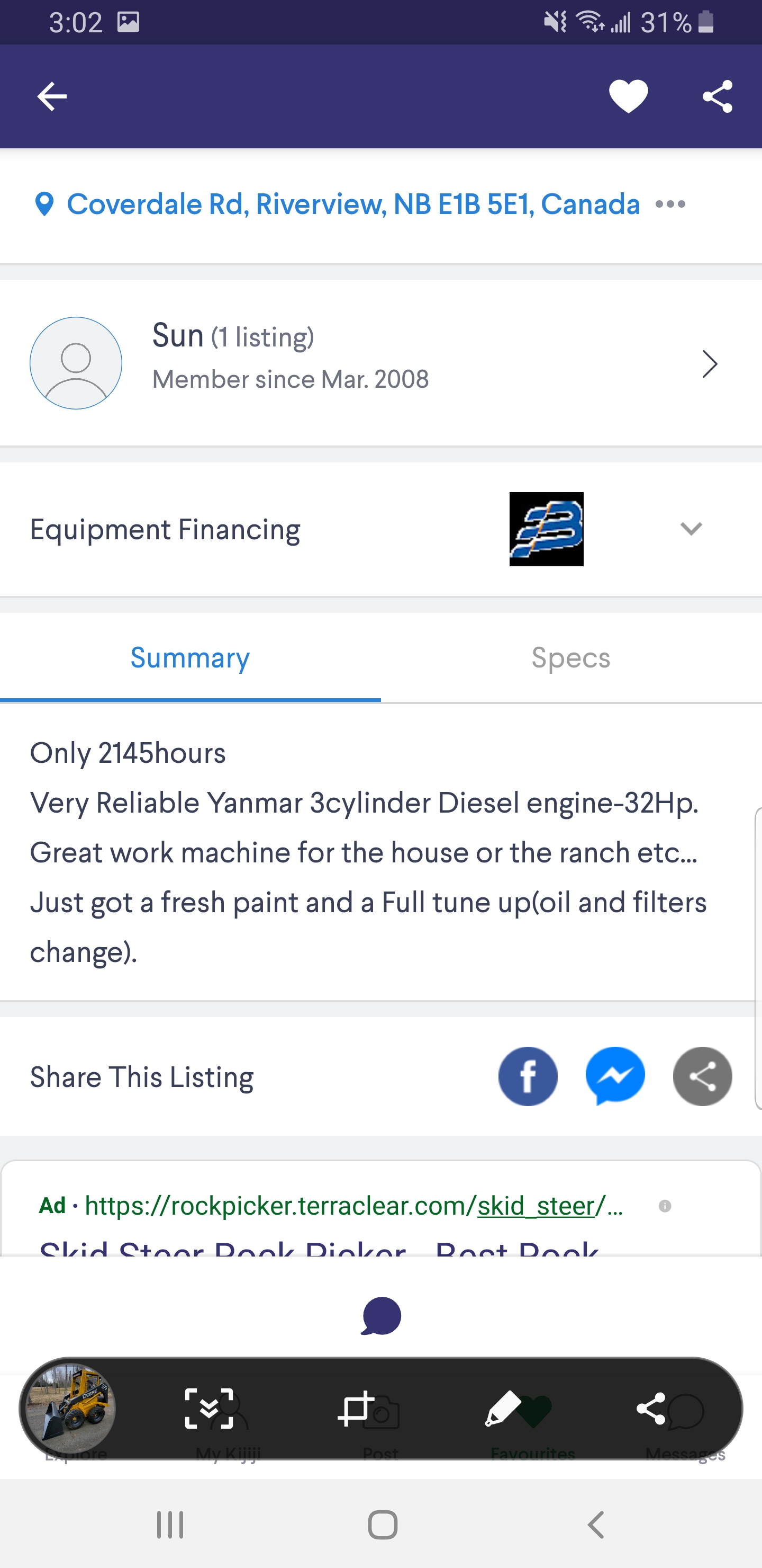

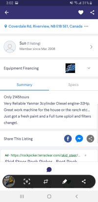

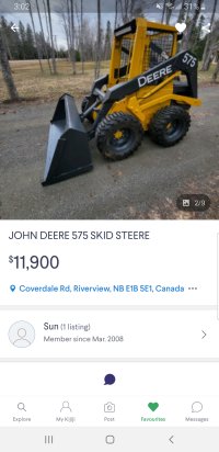

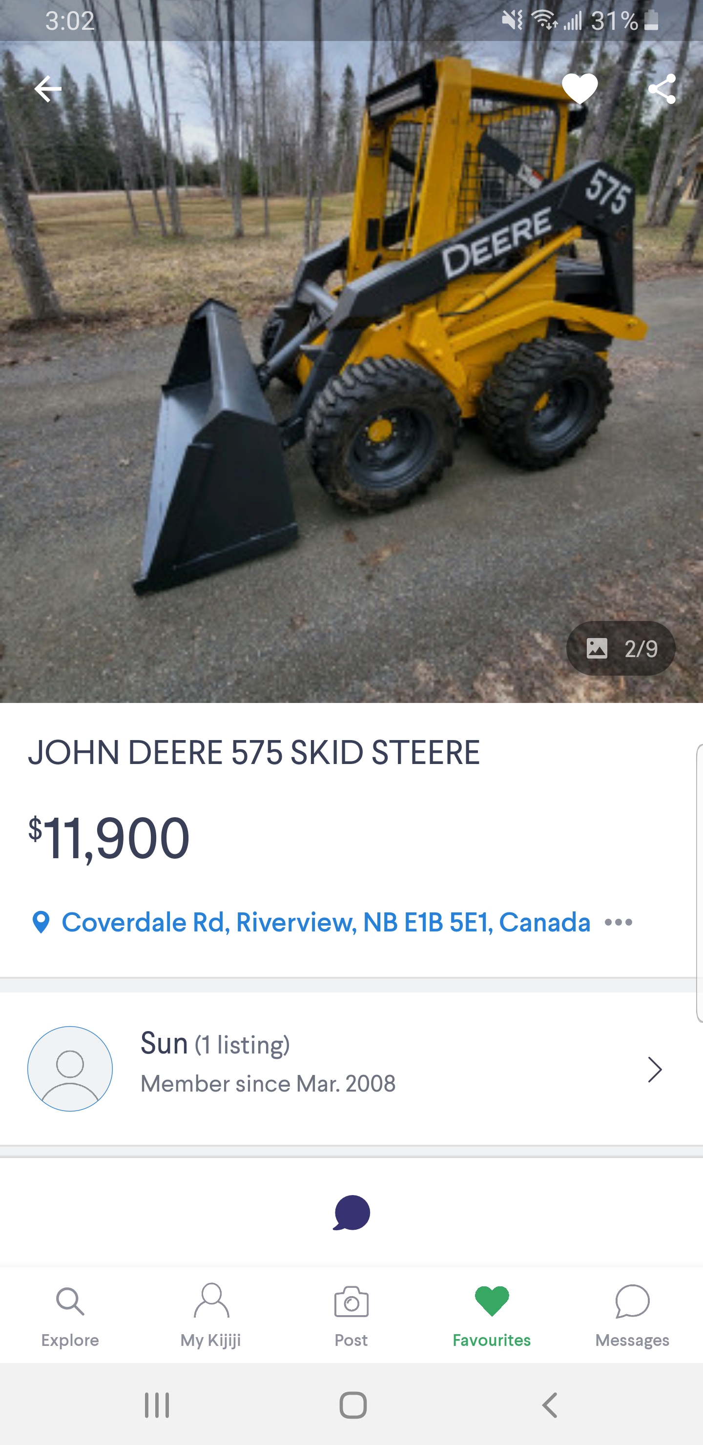

I made a post yesterday, with the skidsteers I am looking at, looking for pros and cons to each, and if the prices were decent, however it appears to have been deleted. There was some Thomas T133s, a bobcat 7753, and this john deere 575.
I am looking on your guys opinions on this machine, and if it is worth the price, what to look for ect.

one thing that I would look for is remotes , not that you need a high flow machine but one that can power a grapple bucket they are so useful. And with that you would need a machine that has a quick attach system. I assume that little deere has neither.

Yeah, this doesnt have aux hydraulics or anything. What you see is what you get.
I’ve owned John Deere, Thomas, Caterpillar and multiple Bobcats from 1980’s to my current 2016. They all have pros and cons. if It’s a short term machine to push around some dirt, gravel and basic landscaping and sell again then a basic machine isn’t a big deal however a quick attach is something you shouldn’t do without. if you plan on a longer term machine then get one with auxiliary hydraulics. When buying any used machine you need to test drive it till all systems are up to operating temps and then give it a little work. Lift full buckets, push some decent piles and make sure all the functions operate smooth, evenly and don’t lack power. Watch you joints and look for play in pins. A used machine will have some but shouldn’t bounce around. periodically look at the exhaust as it’s warming up and at full operating temperature and what colour is coming out of the exhaust when it’s being worked. Black under load is normal. Blue exhaust indicates oil burning, white coolant - either of these just walk away. once you’re done your test drive look everything over again and check for any signs of leakage. main thing is to find a machine that feels comfortable to you, operates correctly and meets your price range.
