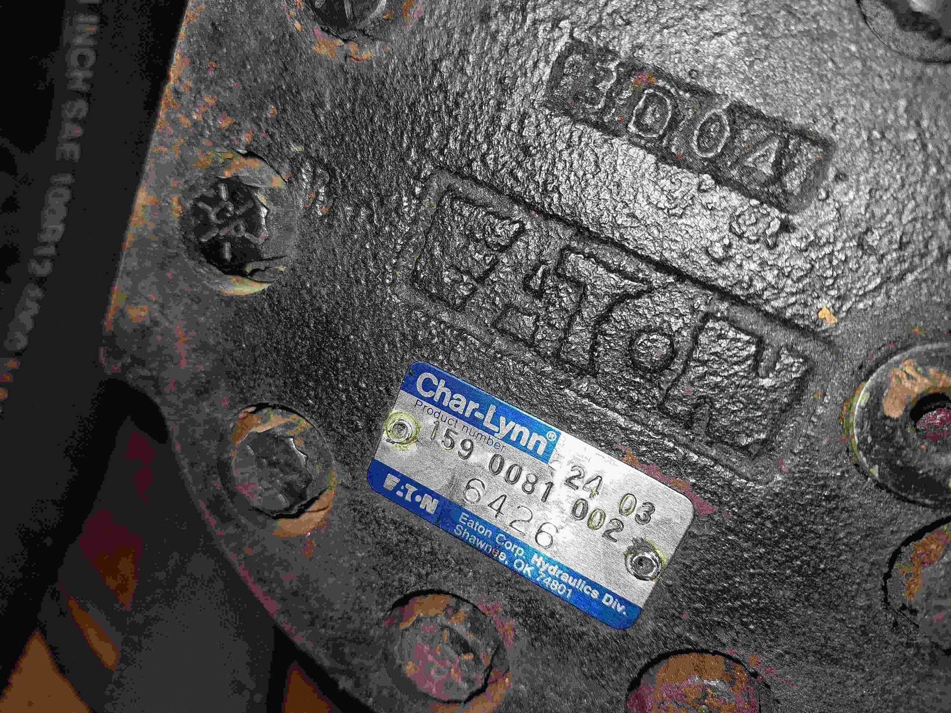

This is the tag on what I believe is my original leaking Char Lynn right side motor.

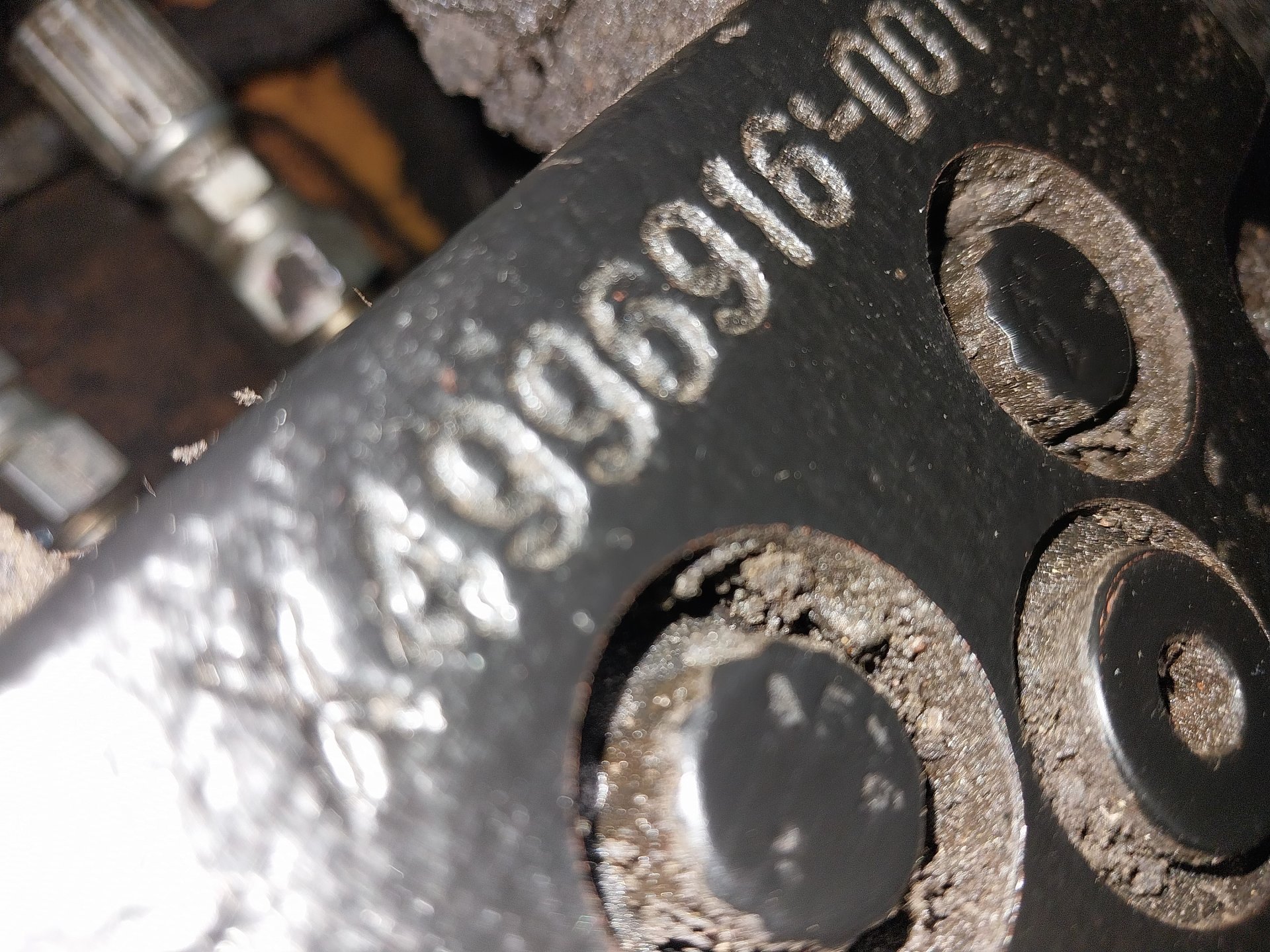

The left side motor which I believe has been replaced has only a casting stamp A X4996916-001-B.
Yes, The information I have from Case indicates that the right side motor was made on the 24 day of 2003. It is one of the old generation motors. The newer generation motors have a 177 0003 003 pin number. The left drive motor tag is something that maybe the manufacturer would be able to decipher.

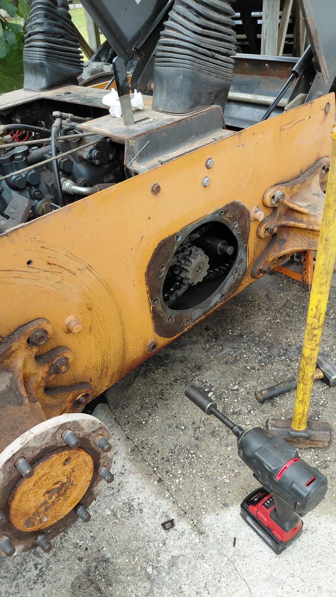

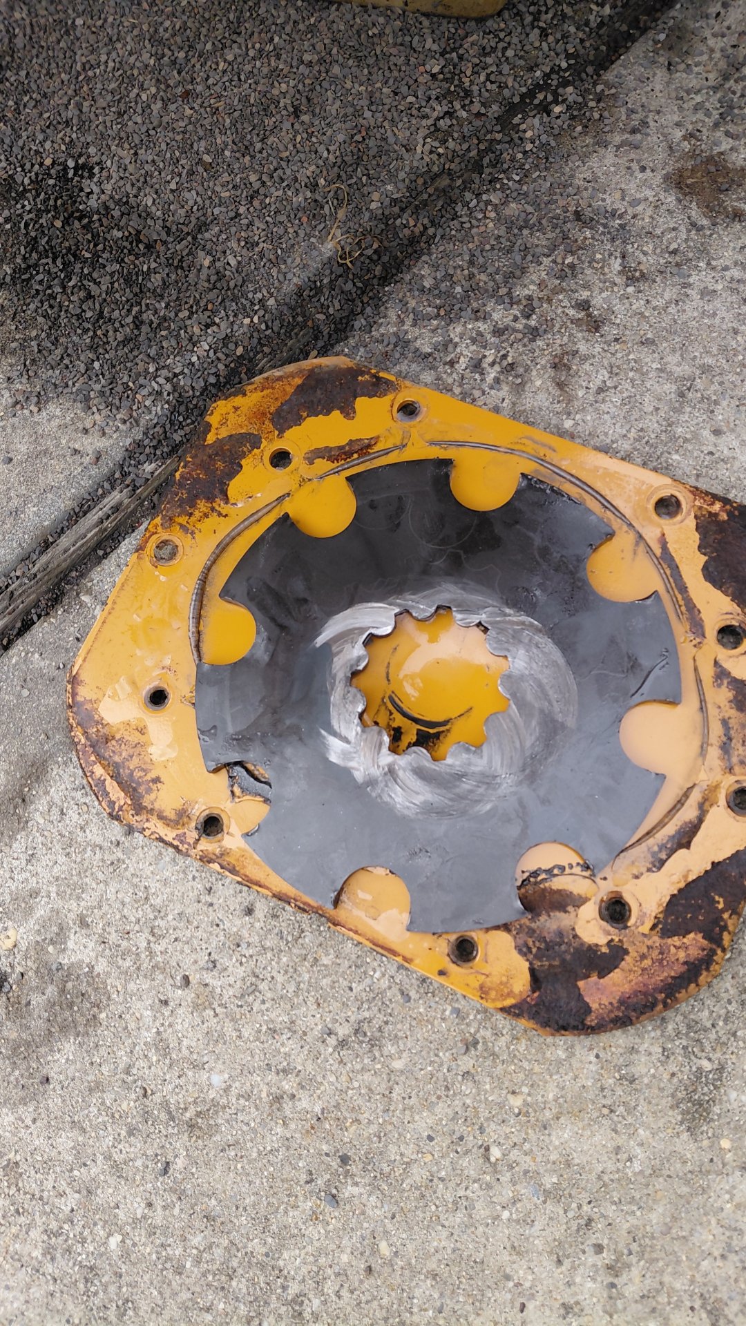

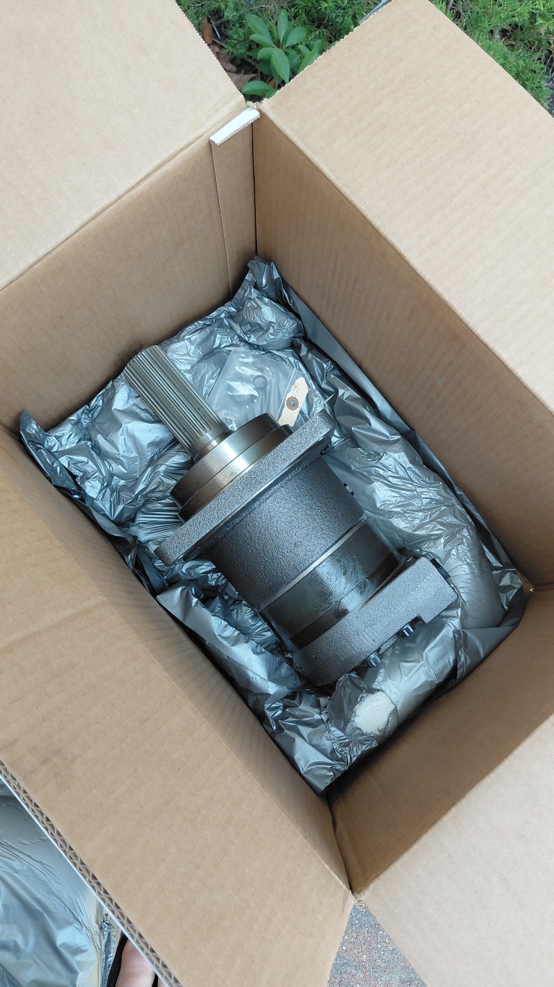

This past September I did the right side (as your sitting in seat) drive motor on my 40xt and did not have to remove pump. I did have to remove all hoses and fittings on that side of pump and remove bolts from motor mounts to slide engine and pump over the 1" we needed to get motor flange to pass through and out. You could probably do the same with the left side motor but you have to get motor unbolted and slide under pump and over to the right side to get it out. On my machine the key was removing the motor mount bolts. It is a 2 man job and believe it or not we R & R motor in tires back on in 4 hours.

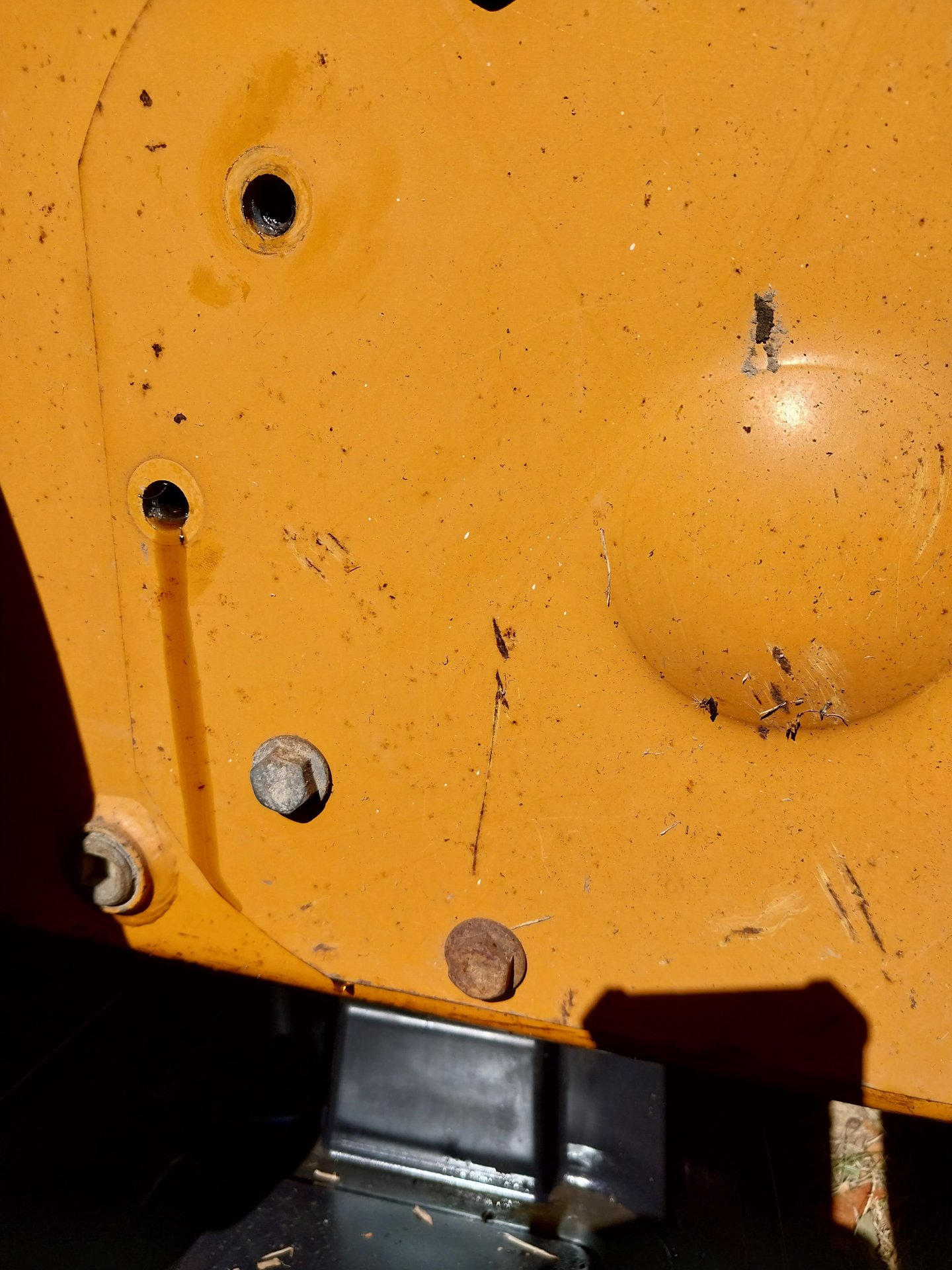

The heartbreak of owning an CASE XT and you see this when you remove any bolt above the fill plug on chain access case.
