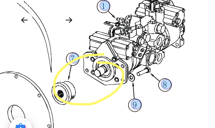

I would say that the most likely cause is that you lost your input drive for the main hydrostatic pump. The drive coupler and/or shaft splines could have stripped. Not terribly uncommon. The gear pump for the hydraulic lift is mounted by itself, so it would still function. Let me know if you need parts!

Not necessarily, but the spline engagement could have been on the verge of failing last time the machine was used. The splines see the most torque at start-up and at high system pressure.

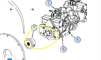

If the arms and bucket are operable, then it is unlikely that any splines are stripped in the pump group. My memory is foggy but I am pretty sure that the equipment pump is last in line of the pumps, implying that if the arms and bucket work, the ground drive pumps are turning also.

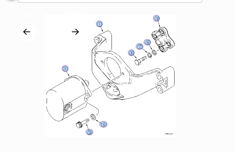

The 40XT has a cover plate on the back of the hydrostatic pump. The gear pump is mounted independently of it.

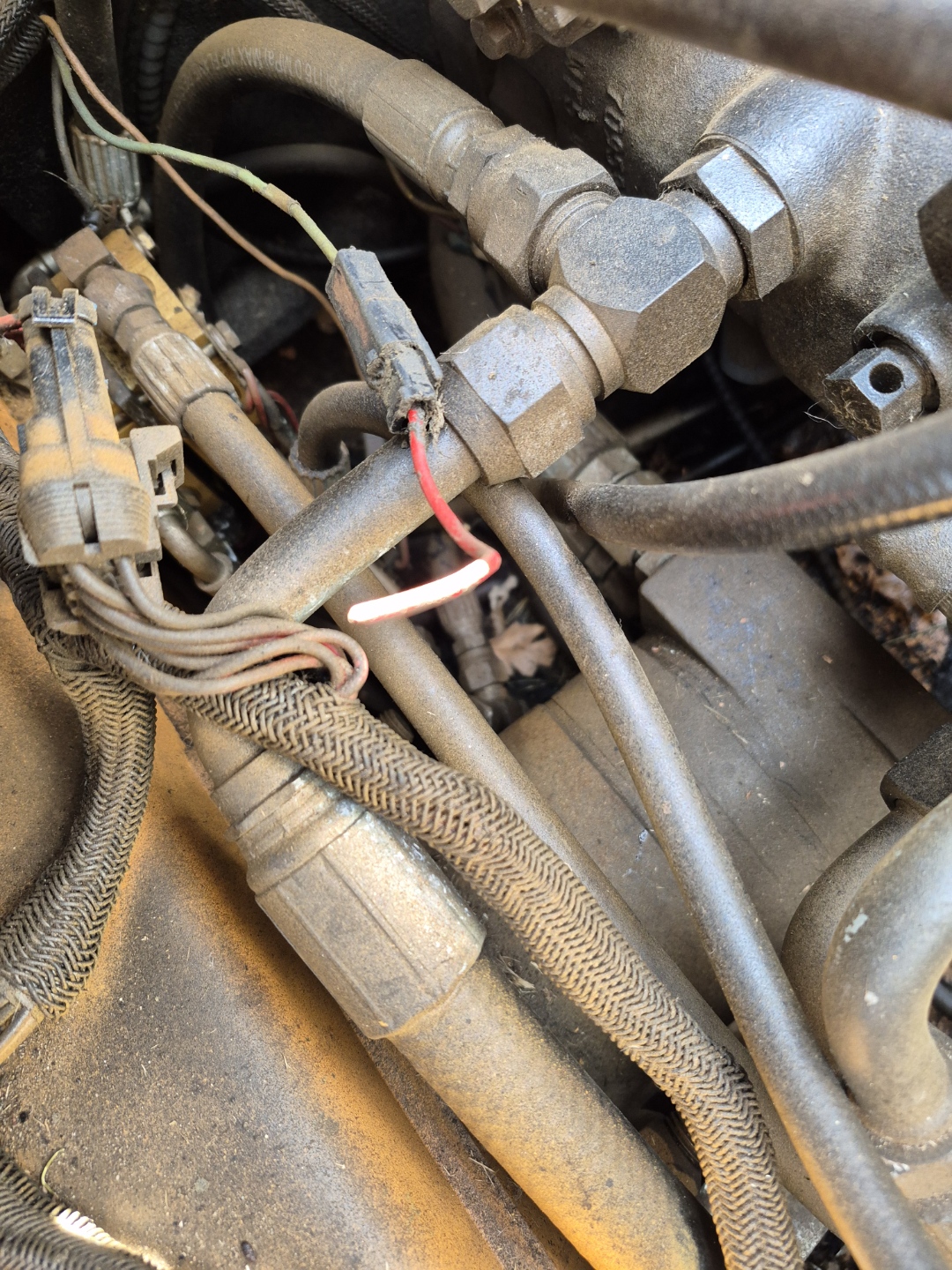

I am not familiar with that machine but here are the first things I would check.
If it was working fine with no problems, and then you left it and came back to it not working there is a chance that rodents have gotten in and chewed some wiring. Especially if it was cold out where you left it, they are attracted to the warmth.

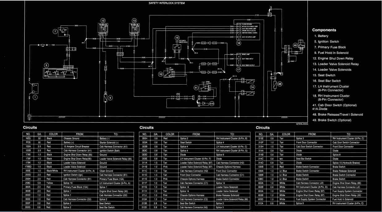

Did parking light on left side upper display panel go out when you lower arm?
If it stayed on then lift cab and take a look at how the arm works and trouble shoot linkages and electrical from there. Also if your remove floor there will be a cable going through inner chain drive housings with what looks like little stick shift booties on them. They are the parking brake cables that engage the lock for brakes. I uploaded electrical diagram if needed.
