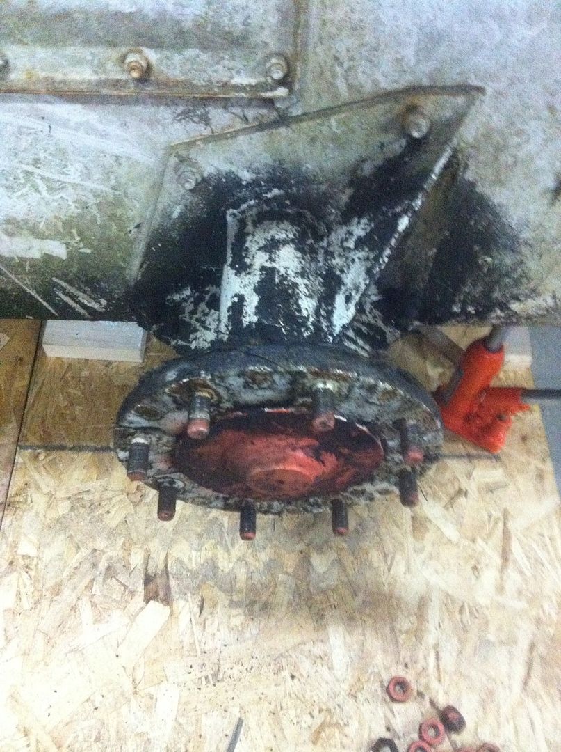

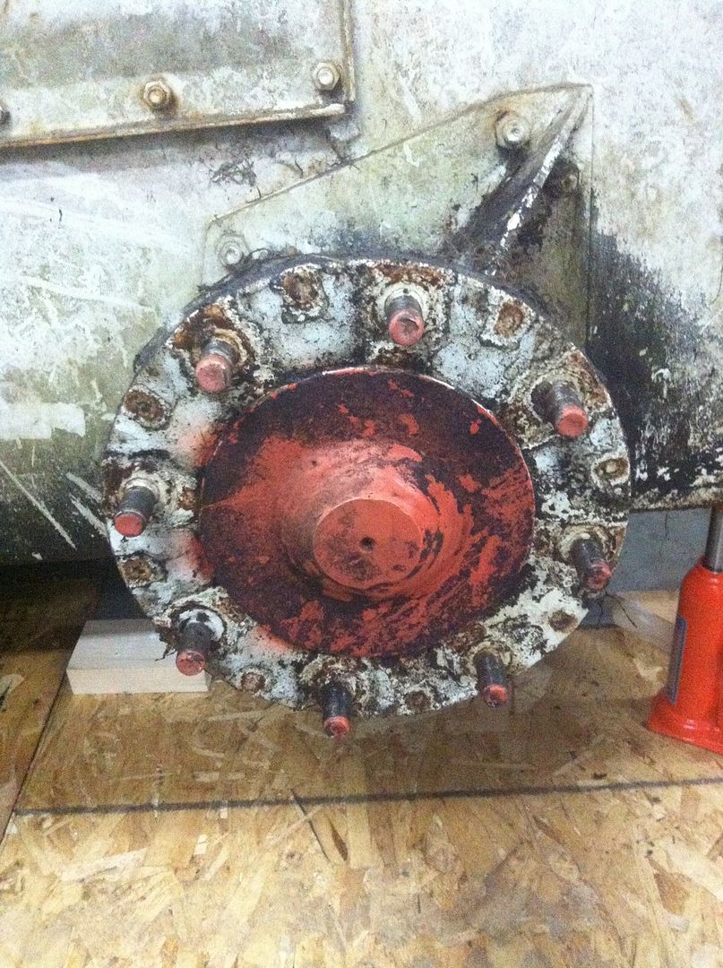

Thx for the info. Im gonna try ajusting the link rods. Also my wheel seal are leaking . I would like to know do i just remove to the bolts around the wheel plat And i can fix the seals from there. Or do i need to remove everything around the back? I ll send à picture attached  photo image_1.jpg Picture 2  photo image_2.jpg

I would suspect you need to remove the axle from the inside to get to the outer seal. Do you have a service manual for your machine? it should show you exactly what is needed. If not, you should talk to your dealer or ebay to get hold of one.
I have never worked on an M700, but on other models, you remove the bolt inside the chain case that holds the sprocket, you then pull the axle out, remove the bearing cone, replace the seal and bearing cone and push the axle back in and put the sprocket on, do up bolt.
Ok cool. Im gonna try that Thx
Is that hub cracked at the top?
That looks like it would be a bear of a job to do. Is there enough room to access the rear axle cover area?? Would pulling the engine out give you more room, or can you deal with it with it still installed in the machine??
Good luck, if you have a helper, it will make the job easier as you need to slide the axle in and on to the sprocket while the chain is on it still. It is doable, but it saves a LOT of swearing if you have a helper to push on the axle. Been there before!
