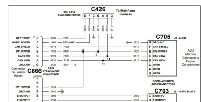

Just for kicks, you might just do a continuity test on the new harness once removed and make sure all the pins work.
For the 7 pin, 2 are data (can-bus) - you can't read them with a multimeter. 1 is ground. 1 should be 12v power when the machine is on.
But I did find this if it helps.

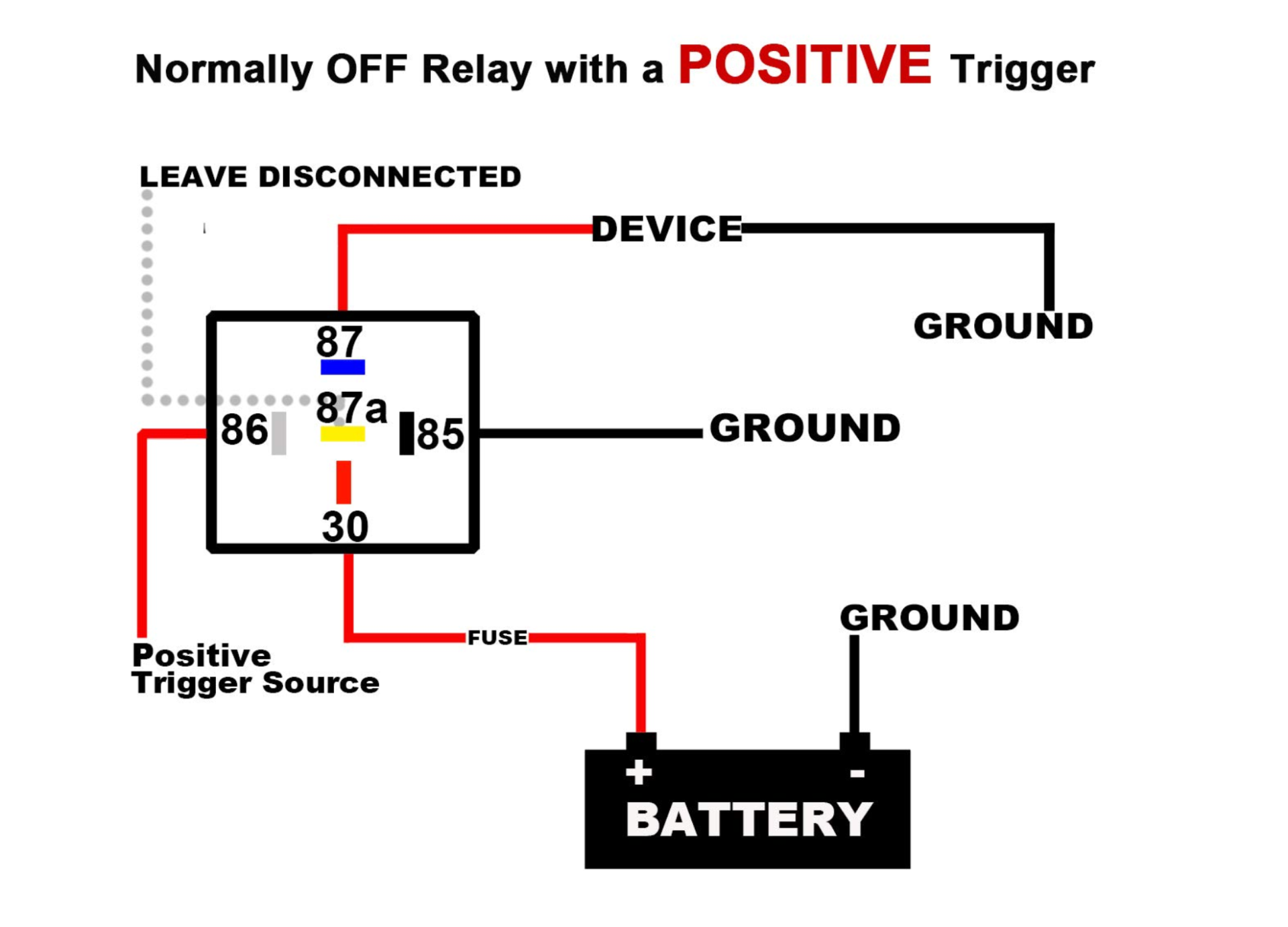

So depending on how many solenoids you want to control and what kind of connection the 6 way blade has, you'll need something like these.
4 solenoids:
6 solenoids:

I am trying to figure out which letters / wires on the 14 pin plug attachment side mean what ?
I need to wire in the 2 solenoids to a 14 pin female plug. 2 power wires and 1 ground.
Can anyone help ?
