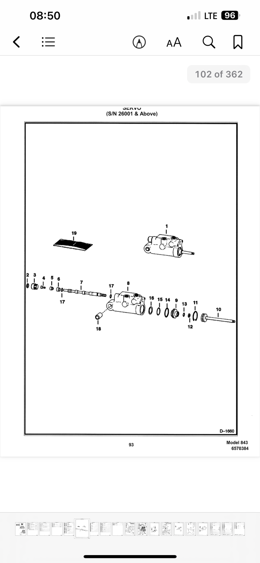

I need help I found part numbers for servo unit rebuild kit and part number for a rod that's damaged and the connector rod with sever play. However, no one has it in stock anyone has any other places I might be able to find it I look all over online but can't seem to have success on it
what part is broken? they aren't very complicated, just about anyone with a lather can repair them or make a new rod.
Part number 10 it's call the rod and piston I believe it broke off at the end where it threaded and they welded I thought someone could possibly fix it but up to the weld the rod goes all the way in I'll try to get a picture of that too
You need a friend with a lathe, get some chrome bar and make a new rod, they really aren't hard to do.
