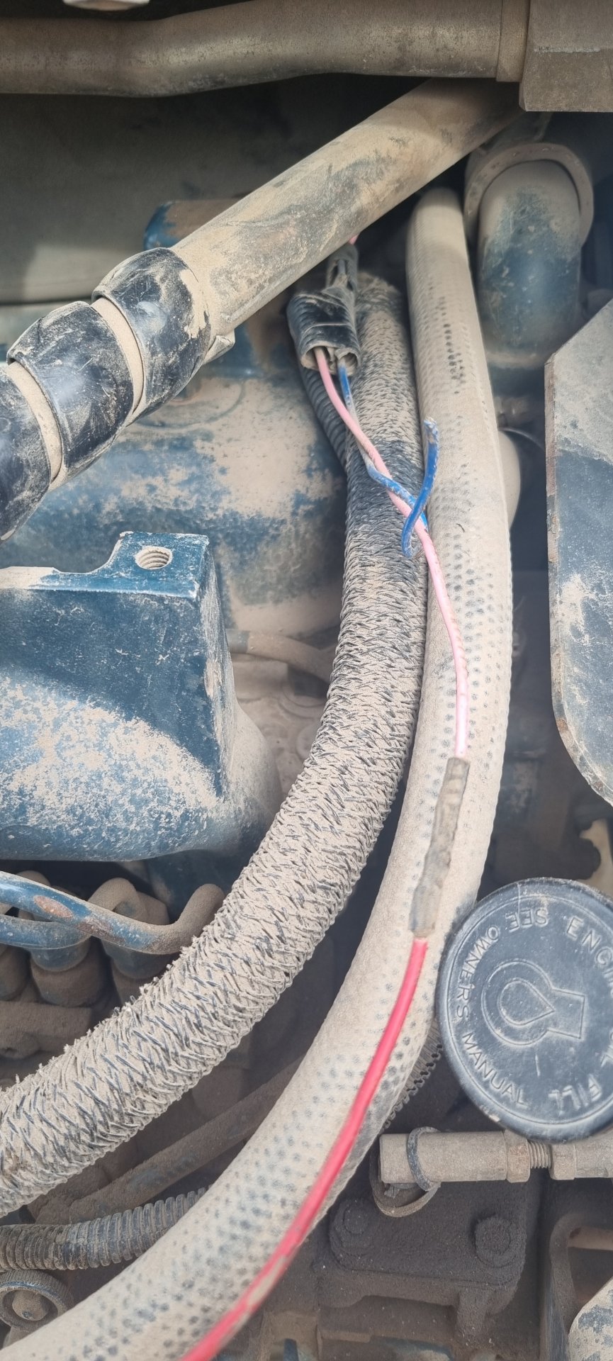

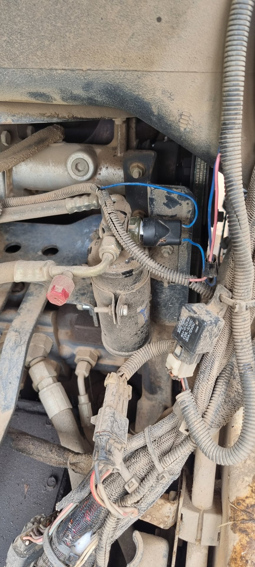

I recently changed the main drive belt on my 763, but since then there is no air blowing, or AC working inside the cab.
I noticed 2 x wires in the rear.
A Red wire going to the compressor, and a blue wire that is terminated to nothing.
The blue wire looks like it goes to the AC pressure switch, but as it does not terminate anywhere in the rear, I don't know if this is the issue or not.

this is just a guess ,but if you can not find the other end to connect to ,could it just go to ground to make a complete circuit? really you need to find a wiring diagram to confirm where it is supposed to go. but look around at places the wire streches to on the block in case it is just a ground ,should have a connector on a bolt with no wire on it. just a guess.
I did try connecting it to ground, but it did nothing.
