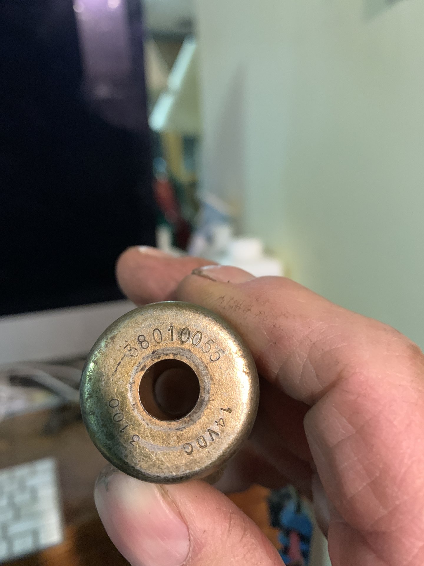

The solenoid tested in the video was from the relief valve. It has 14VDC stamped on the casing. The solenoids on the control valve have tags stating 10 volts. I have not tested the 10 volt solenoids off of the machine. However 3 years ago I did when the Aux Hydraulics only worked in one direction I switched them and it did not change the problem. Then I plugged them in with the wrong wires and it still only went one direction the same way but operated with the switch in the opposite direction.
