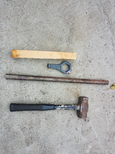

I put the wrench on the bolt, tapped the wood in between the bolt heads to keep the wrench on, held the rod on the wrench and beat on it. Have to make sure the wheel/axle is not spinning with each hit. About 30 good hits hits and it was loose.
