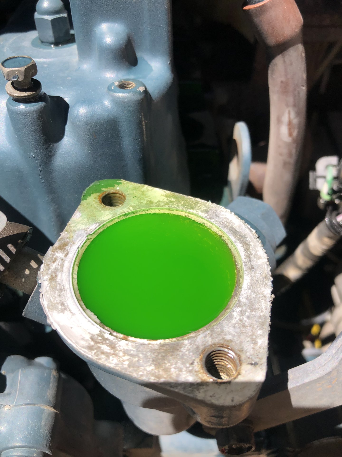

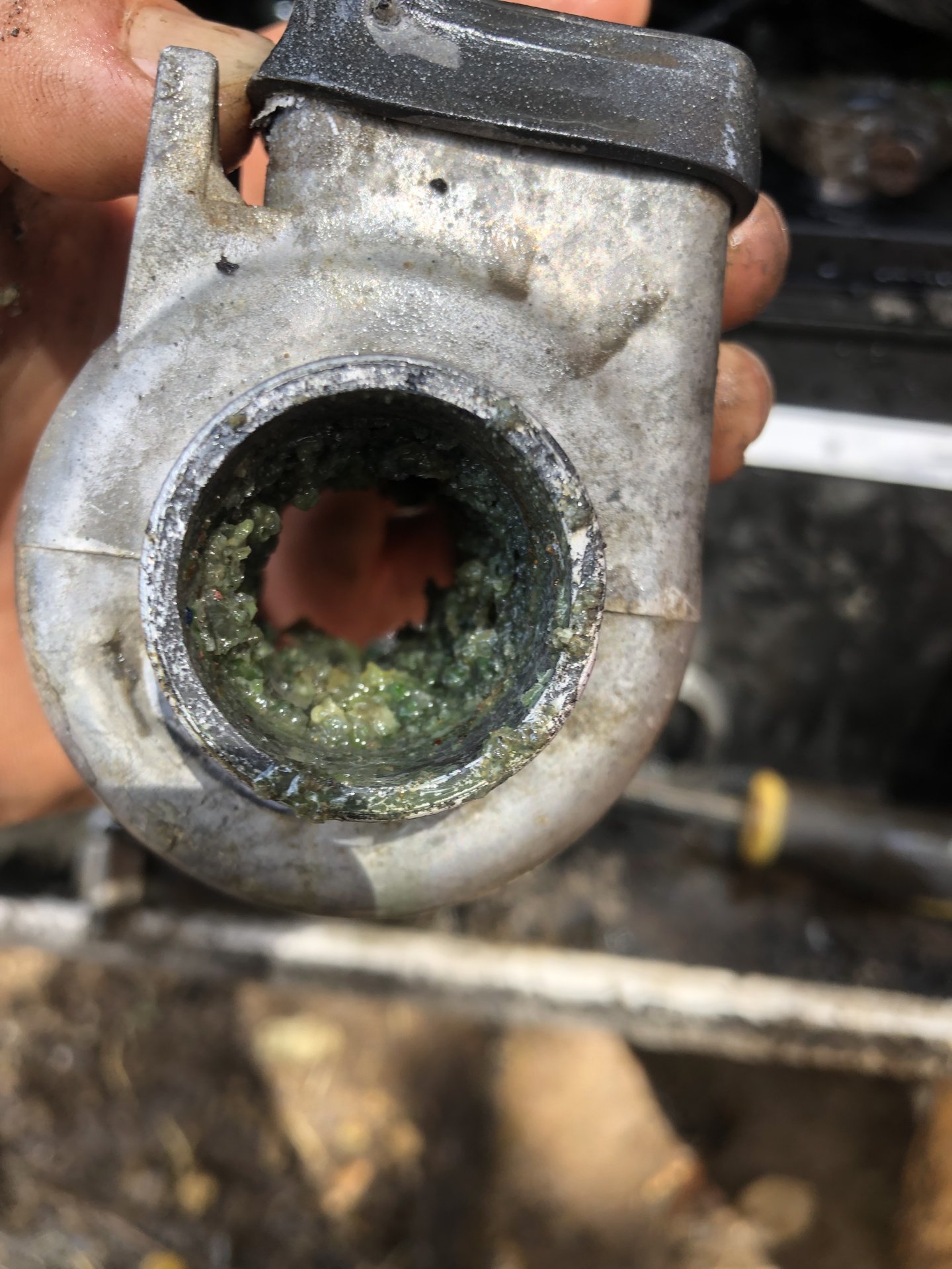

I cleaned the block heater or coolant heater today and it was plugged halfway with Some sort of deposit, maybe calcium or cooked coolant not sure but it now stays in the 180 to 190 range even on a day when it was 103 here in nor cal. I noticed a yellow wire with a blue stripe hanging down near the coolant temp sensor wire behind the alternator and I'm not sure where it goes. Any ideas?
Well I thought I had the problem fixed by flushing the radiator and clean buildup out of the in-line coolant heater but it started getting hot again today. It was 104 outside yesterday and it stayed 3/4 of the way on the normal portion of the temp gauge. Is there a good type of radiator cleaner to recommend? I was thinking some of the debris from the heater in the lower picture may have made it up to the radiator and plugged some of the passages.

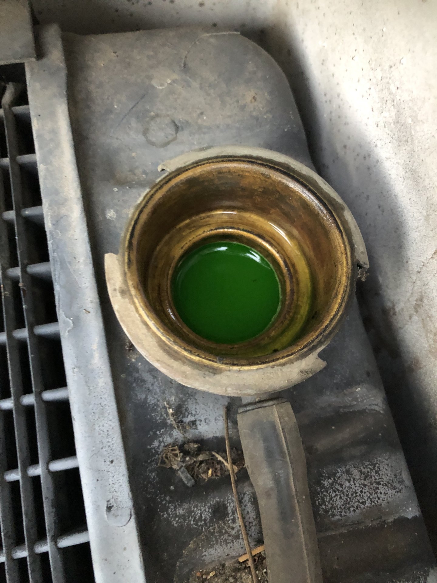

I'm not sure either, I bought it this way. I'll be sure to us the correct stuff when I re-assemble it. So I would imagine that I probably have a plugged radiator from the looks of the build up. The inside of the radiator looks good at least the small portion I can see. Is there any way that I would be able to flush it properly without removing it from the machine? Is the any cleaner that you would recommend? Below is a picture of the coolant before I drained it.

I do not know if this is the effect of mixing red and green coolant ,but I heard it makes a sludge if mixed. I think you will need a chemical radiator flush and some diesel mechanics I know swear by peak final charge coolant. (which I am converting to as coolant changes are needed )

If that is what is in the cooling system I doubt you will be able to clean the radiator yourself. It might be time to have it checked at a radiator shop but you are going to have to get the rest of the system clean before putting a clean radiator back in. Definitely start reading up on electrolysis in a cooling system and do some testing. I have seen new heater cores fail within 1 year of replacement due to electrolysis. Here is a quick link I found...

You mentioned early in the thread that the water pump was making noise. Maybe I missed it but I don't see anywhere that you said you replaced it. Just wondering considering the corrosion in the system. I've seen the vanes on pump impellers corroded off. Perhaps you've lost enough water pump vanes that it's not moving enough coolant to keep up when you're working the machine. Just something to consider.
After you get the radiator hot tanked and engine flushed, do as UnexpectedBill suggests and inspect the coolant pump impeller for cavitation pitting and electrolysis corrosion. And after you have thoroughly scraped and cleaned out the heater, install an AWG 10 bonding (ground) wire from it to the engine block. In essence, you have a dissimilar metal "battery" here with the transient current being carried in the coolant (this is also why there is usually a separate ground wire on an aluminum alternator).
For a flushing agent I recommend an oxalic acid solution or CRC Evapo-rust (remove the thermostat for flush and rinse). For coolant I recommend (and use it in all my equipment) Final Charge 50/50 premix.
