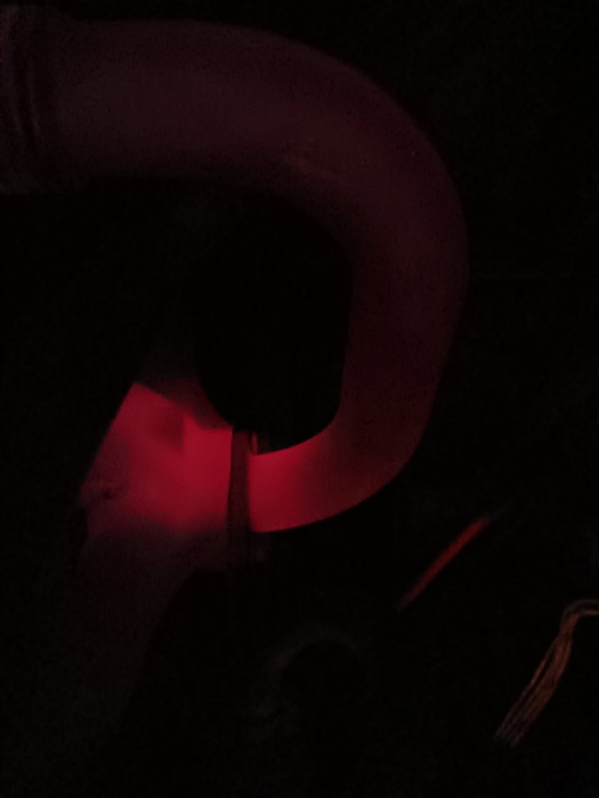

Good morning I got a bobcat 742 with a KSG 416. Been having some issues for a while started using a lot of fuel and then I noticed the exhaust manifold would get pretty red within 20 minutes of running machine under normal use conditions, figured head gasket had failed because had also found a broken head bolt so long story short replace the head gasket went through the cylinder head At Machine Shop reassembled everything start it up runs great but after about 20 minutes of running at the exhaust is still getting red and it's really weird because the exhaust is only getting red in the center of the manifold and then following up the pipe about 4 inches. I'm getting good airflow out of the exhaust tip, the carburetor has been rebuilt and replace the distributor with one that has electronic ignition pulled the timing cover make sure didn't skip the keyway. The timing marks lineup exactly where they're supposed to be chain was nice and tight. I'm running out of ideas. Thank you.

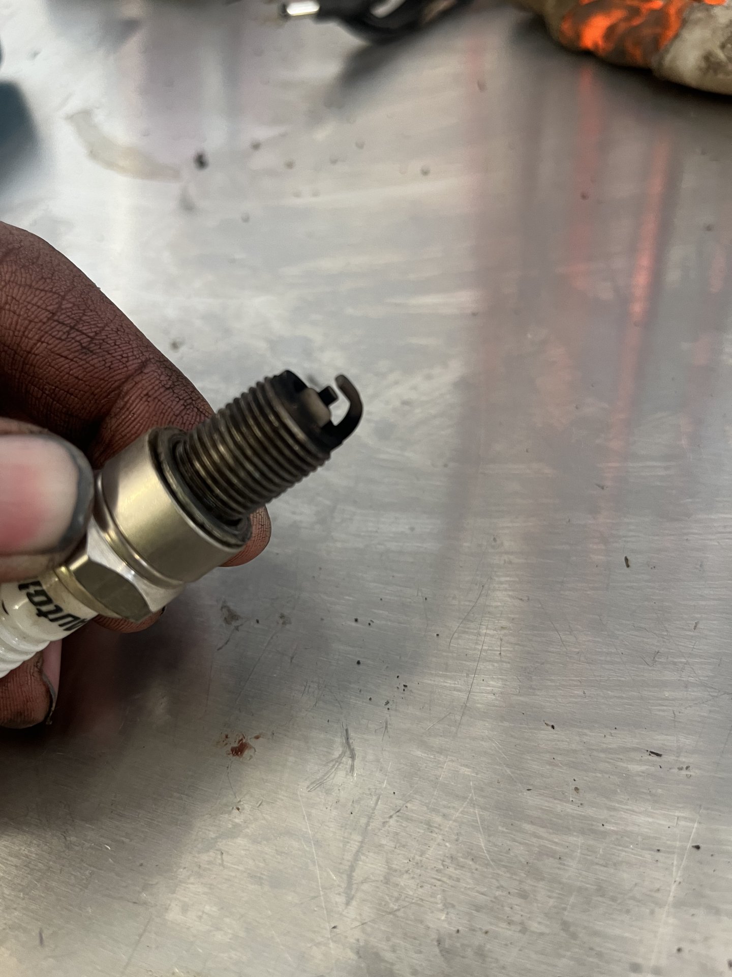

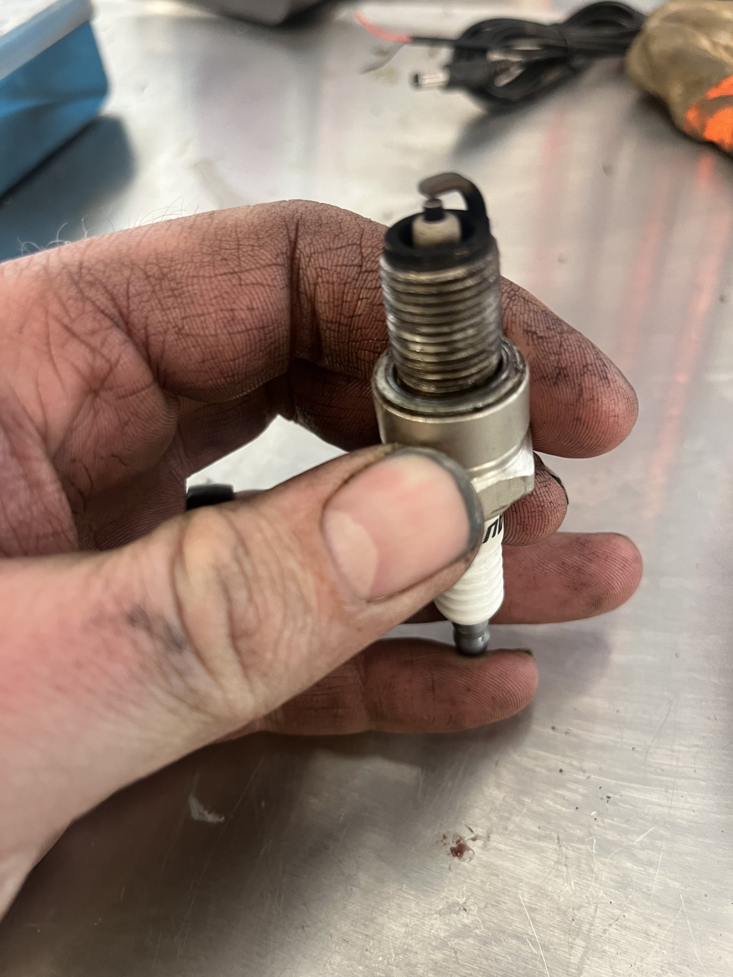

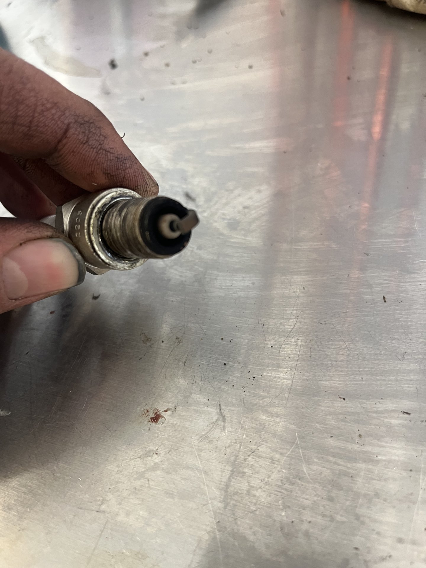

Plugs look pretty good
That was quick. Do look very white, not tan. And brand new. Be sure to shut down after running full power immediately. Best engine torque slightly rich; these look pretty lean to me--would make for exhaust smelling pretty good, but maybe a hot manifold.
I would be suspicious of a vacuum leak first--PCV valve, vacuum line, loose carb to manifold nuts, bad carb to manifold gasket, bad manifold to head gasket or loose bolts there. If the intake is somewhat far away, try spraying brief squirts of brake cleaner near/on any potential leak area and listen for change in RPM. If the intake is too close, it will be very hard to tell if it is sucking in the fumes there vs through a leak. Other than the PCV valve, other leaks should have shown up worst at low RPMs/high vacuums requiring idle mixture adjustment or increased idle speed screw. Possibly a problem with the carb rebuild--low fuel level/incorrect float level.
I would also suspect vacuum leak or problem with carb. Very simple method of checking for lean running condition is to remove air cleaner and lightly cover top of carb with your hand or a rag slowly restricting airflow. If it is lean the rpm will increase. I would first check it at idle. Another method is to add supplemental fuel, like small quick shots of carb cleaner to check for rpm increase. I also use propane.

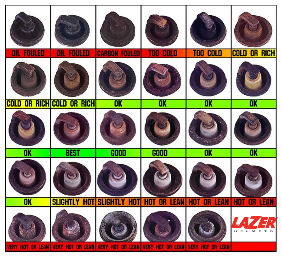

Prior comments are good to start. Timing too far advanced will cause overheating. Incorrect spark plugs, too. (Dave 1234---great spark plug diagram!!!)

All comments are easy checks!!
Not sure if Dave1234's YT video helps apfisch or not, but it sure helps me!!! That spark plug video has info I have never heard!! Thanks, Dave1234, for digging that video out. See, you can teach an old dog new tricks!
