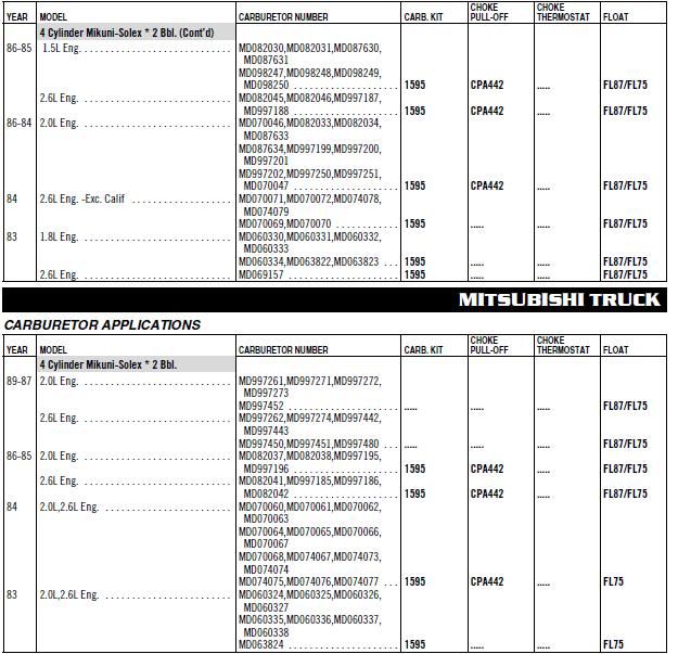

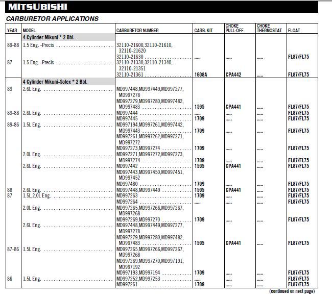

Here are a couple of pages from the Standard Motor Products catalog. You're going to have to find the number on the carb.

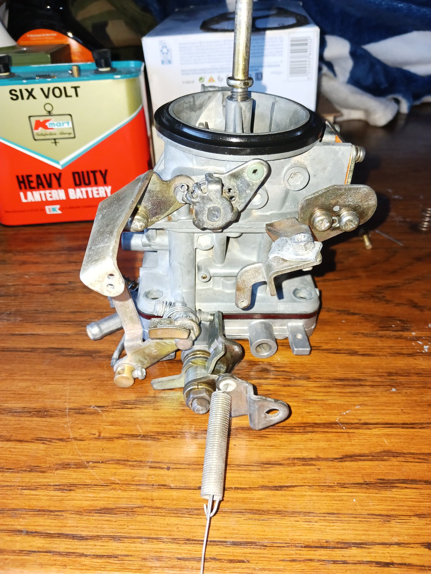

Old Machinist,
Please can you guide me to where I would find out where carb number(s) would be found. All I can find on my carb is of course the SOLEX MUKUNI CORP JAPAN markings.

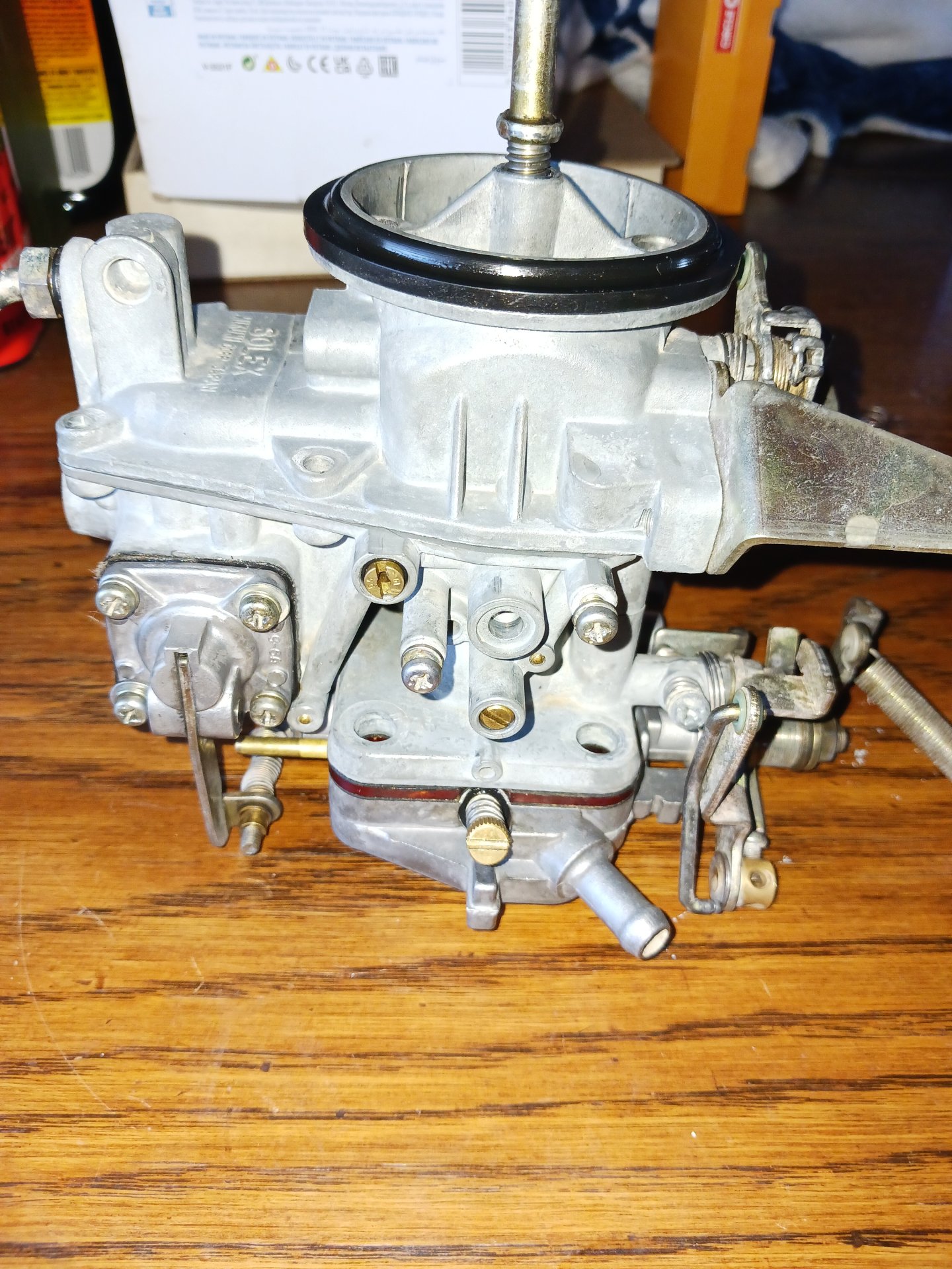

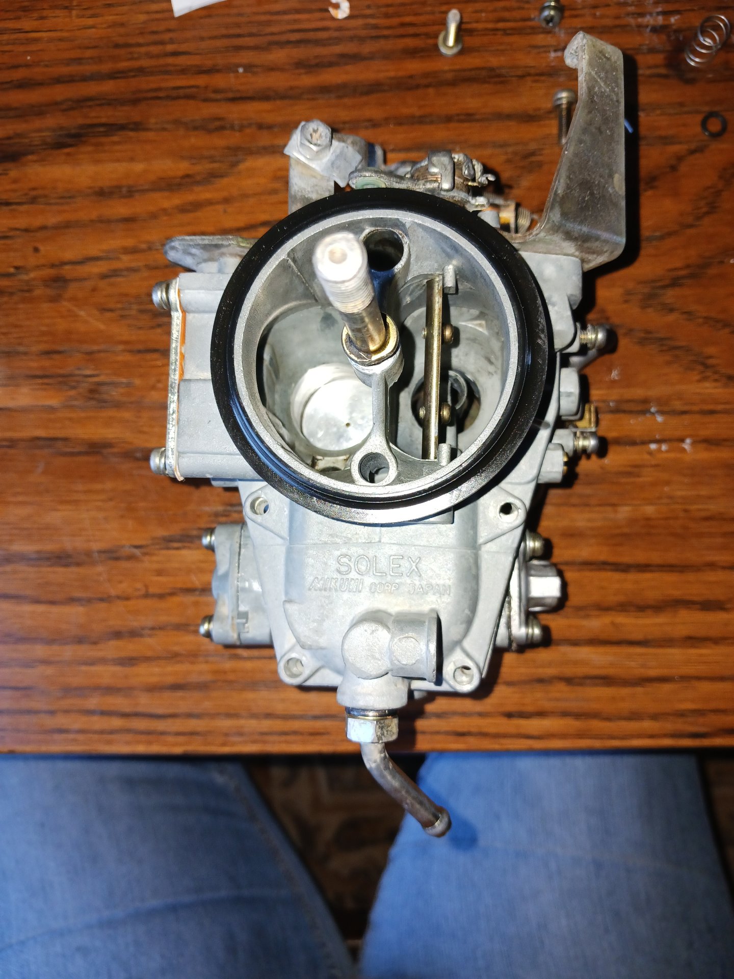

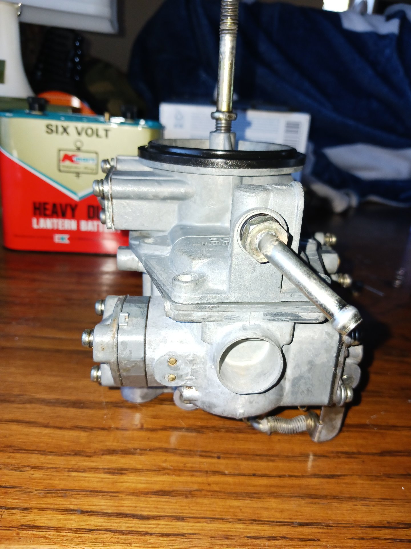

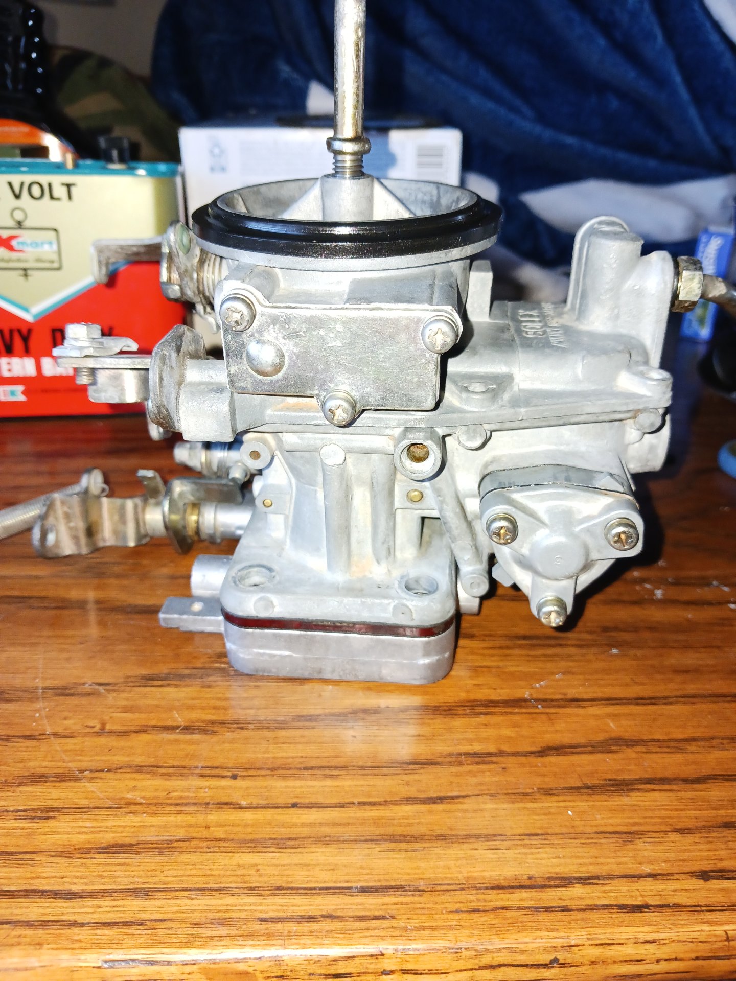

Old Machinist,
Did you ever find the carb markings? I can't find anything on mine either. Pretty sure they are not there. Its probably a Bobcat spec carb
I'd give up on finding a number--I don't think it was ever there--the carb is somewhat custom for Bopbcat. Follow the earlier advice on the two carb kits, or dig around the forum elsewhere for similar advice with different manufacturers of 2 carb kits. Doesn't seem to get any better than that, unfortunately. And I note that your carb lacks the sight glass that you are supposed to look at and verify that the fuel level is in the middle of it. I looked everywhere including buying several dodge colt shop manuals and none had a float height level. Finally adapted a $100 Ebay Dodge Colt carb (good write-up by others elsewhere on the forum) pending either finding a body with the sight glass, or experimenting to get the float height right.
Just a note about the Mikuni carbs. They were not just used in Bobcat machines. I actually had a brand new one that I sold a few years ago that was overstock from a forklift company. I believe it was Clark forklifts. Quite a few machinery companies used the Mitsubishi 4G32 for small equipment. It seems that the newer carbs did not have the site glass. Neither of mine did and I never found any number on them either.
