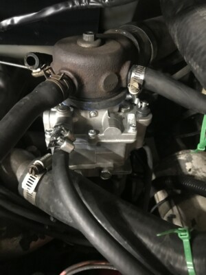

I have a 642b with a Mitsubishi 4G32 engine. I am exchanging the old Minuni-Solex for a new one. The old one is a double barrel carburetor with one throat blocked off (? as a governor?) to keep the engine at 32 horsepower. I can't find the old one for sale and the new ones come only with 2 throats and 2 venturis operating. I want to know if there will be a problem using the new carburetor in my old machine and how tough it will be to install it. I can buy one on Amazon for about $120. Any thoughts?

I just did the exchange for the cheaper carb. I had to make a 1/2 inch spacer/riser for it to keep the linkage from interferring with the manifold and I used the plastic spacer from the old carb to get the hieght for clearance and to use same studs. Had to make a new rod for linkage, and right now I just disconnected and plug vacuum for the secondaries. I did post it might be a heading of 742B carb fix.
Runs great.
