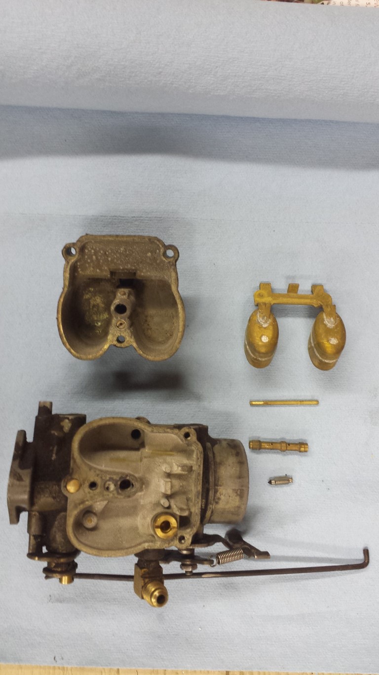

I was fritting around with the carb last night and realised that "full throttle" and "empty throttle" were the opposite of what I had been trying. Dumb, dumb, dumb.
Anyway, I got a replacement for the line that I'd seen leaking from the last abortive starting experiment. All I can say is that replacing hoses on the right side of a 630 is infuriating!
A quick shot of quick-start, throttle open, choke on and hey, presto, she came alive!!!!!!!!!!!

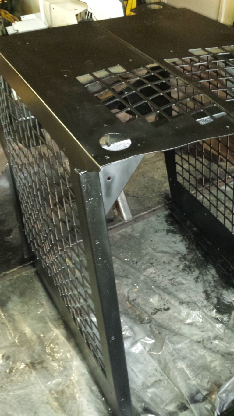

After a break in work for the last couple of weeks because I was away, I decided to tackle the little machine again.
I think I have tried to find the foam for padding the fuel and oil tanks everywhere. Obviously they're not made anymore (which I was hoping against hope), and trying to find something online or at Menards proved pointless. I was doing the isle-by-isle thing at Wal-Mart and found some aftermarket auto floor fabric. Having used some sprayable contact adhesive before, this is what I came up with:
This is triple layer...
I also, inadvertently, sprayed some of the contact adhesive on the outer layer of the fabric. This is a great thing to do as when one locates the tanks in the correct position, the large adhesive area holds the tanks in place just enough to prevent them flopping around.

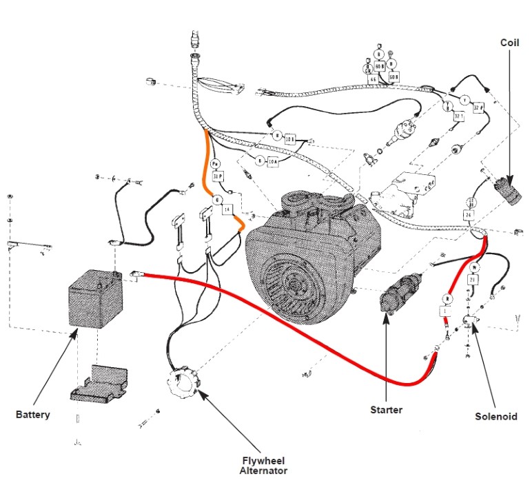

Ok, I think I have it figured. And actually, I was a bit of a dufus.
This manual drawing:
shows the three wires coming from the alternator. Two of them are joined after the regulator and rectifier and go to the ROPS connector (the orange wire).
This is the photo of what mine looked like during motor removal:
The unidentified wires are the white from the rectifier and regulator. On the regulator (on right) one can see a T join, so obviously the white from the rectifier gets joined to the black from the regulator. The other side of the regulator goes to the ROPS.
This manual picture:
shows the orange going through the ammeter (third gauge from left) and becoming red which in the image above (duplicated):
goes to the battery via the starter solenoid.
What was confusing me was this:
which is also from the manual and seems to show the joined wires running to a "ground" lug. In hindsight, the lug is the one that connects the wire to the ammeter, and the blank spot in the wire drawing must be where the ROPS connector is located.
So I think I have it. Perhaps smoke this weekend will prove otherwise...

Here is the (semi) stripped carb. Note that the float hinge pin is knurled for a short distance that, when assembled, "interferes" with one of the aluminium webs that form the top body of the carb. Removal of the pin is as simple as pressing a screwdriver on the side of the pin (perpendicular to the pin axis) and gently forcing the pin out.
Note to self: when re-assembling, remember that the needle valve needs to go in before the float, else you can't get it in.
Another note: it is easier to keep the knurled section of the pin away from the direction of insertion otherwise the knurl needs to pass through both webs.

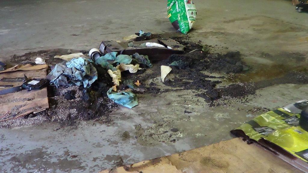

Here is a photo of the two little balls that so almost caused a BIG bonfire:

I tried to spray the ROPS so that my brand new lights would look at least part of the setup. Sadly, all I did was overspray everything, so I removed the ROPS, the "firewall", the chair, the seatbelt, and everything else that might prefer to be black.
In the US, there are four gloss levels (in increasing order): Flat, Satin, Semi-Gloss and Gloss. This is Satin. It refers to the price of the paint, not to any gloss level.
Three spray cans of white delivered this:
(Three of the new working lights are on top of the oil tank on the left.)
And three cans of satin black, this:
The ding in the roof will be fixed when I get my welder. I plan to weld an angle iron across the top with the two legs lying flat forming a 45 degree. This should level up the top of the ROPS.
