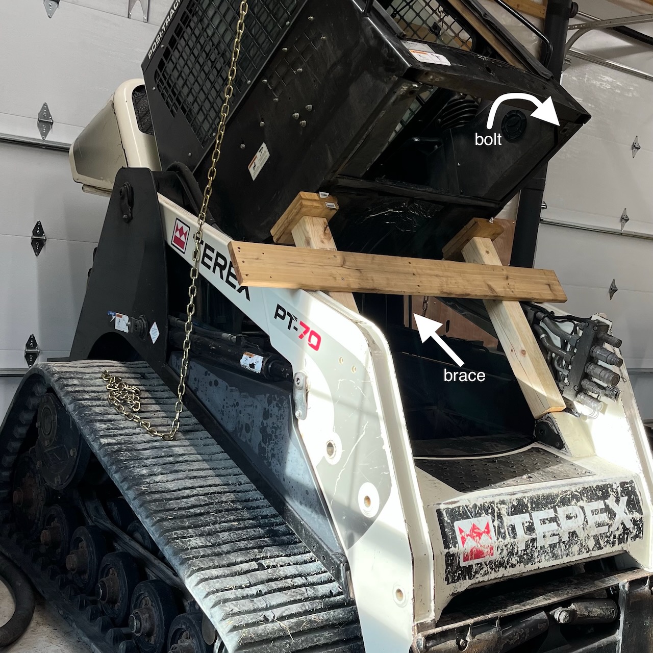

I'm not really familiar with that specific model but I have a Terex/ASV PT100 and have been pretty much rebuilding it from the ground up (don't ask 😂).
First, mine has a lot more than 4 bolts. I have at least 6, maybe 8 that go around the skirt surrounding the cab.
2nd, you have to have the loader up and locked on mine or it will hit and stop like you described.
3rd, door has to be shut or it will hit the loader arms on mine. (I couldn't understand why mine wouldn't go up one day right after I had just lowered it. 😂 I was alone too so getting tired trying until I figured it out.
I don't see any Vemeer listed but if it really is just an ASV, Track loader parts has free manuals. I like their site and order a lot of parts from them. Here's a link to the manuals for a regular ASV PT-100 Forestry
