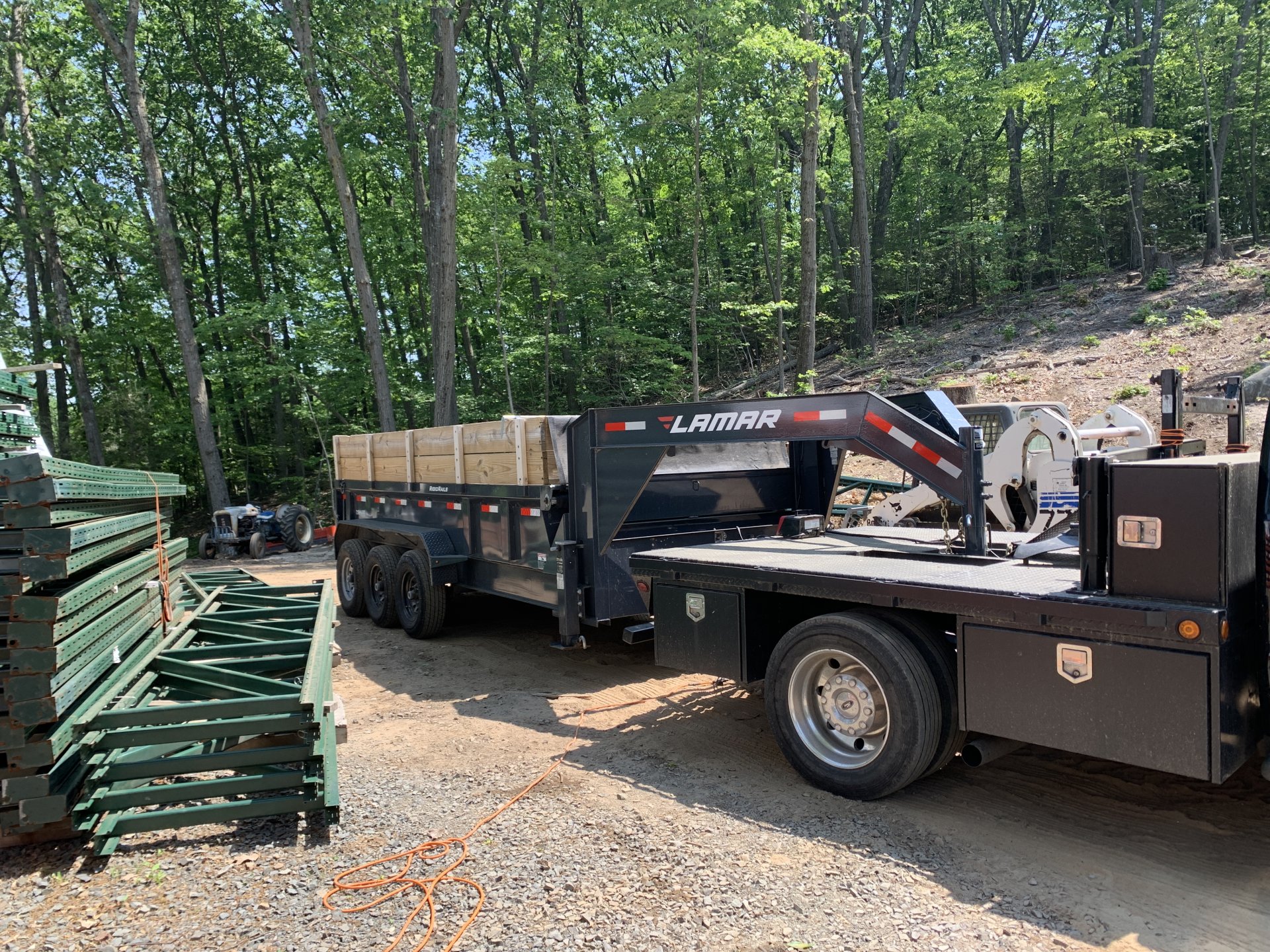

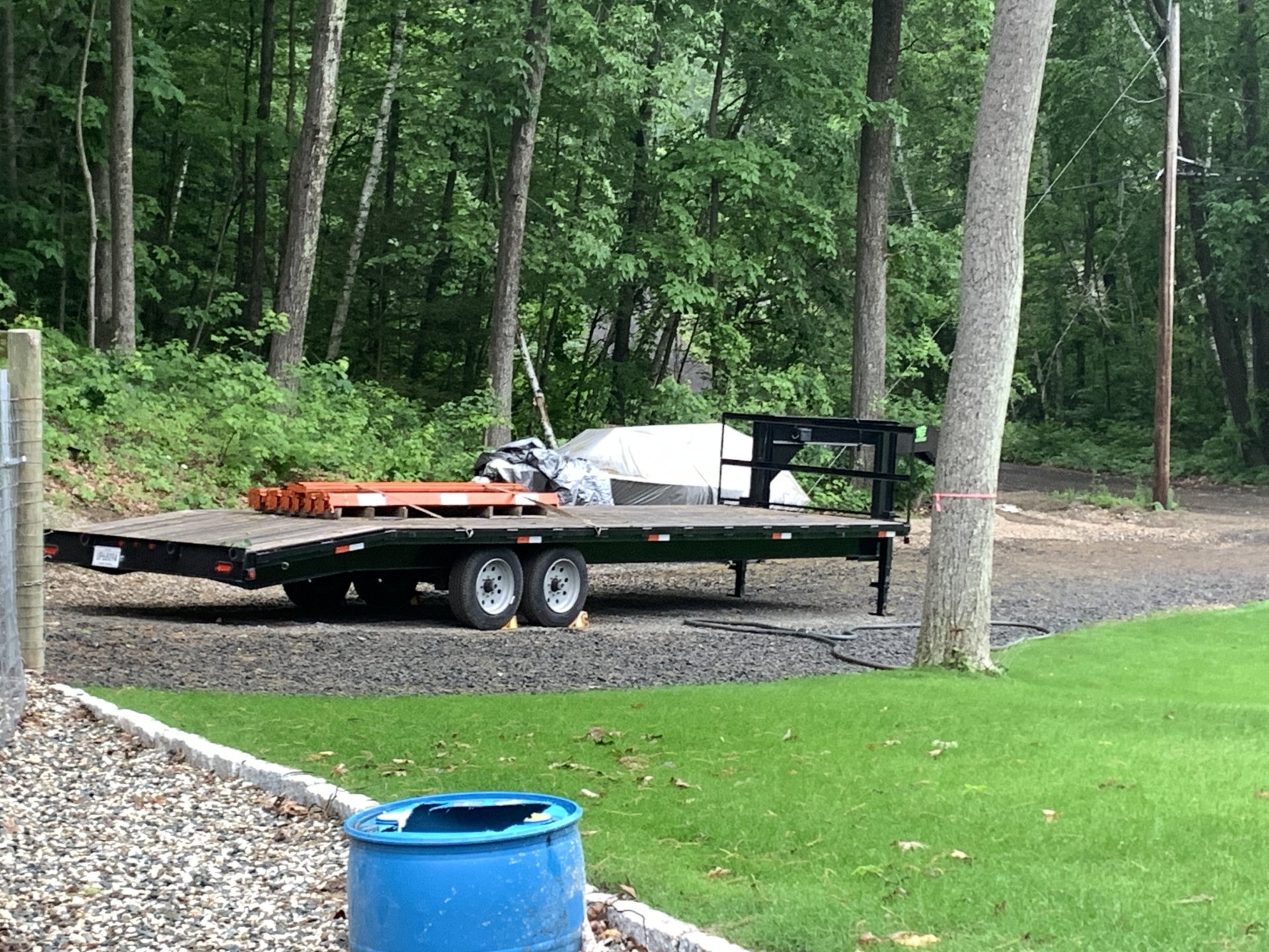

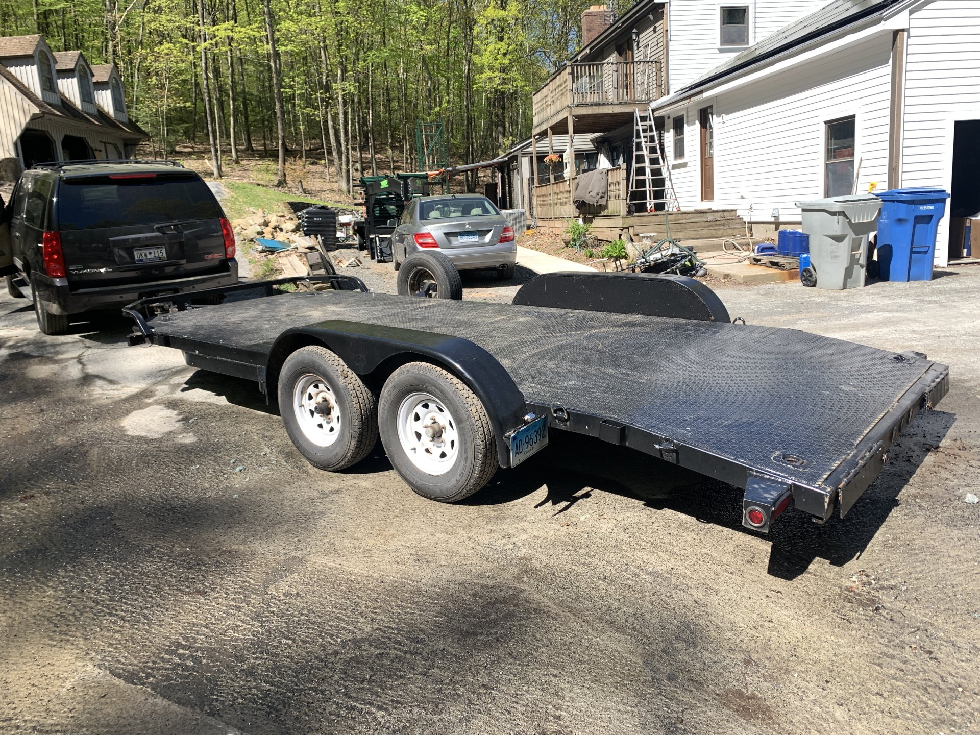

Believe it or not I had a 7,000 pound tandem car hauler with diamond plate. Weighed 2200 empty. I used that for 8 years but it was too fragile. It was a great trailer, easy to pull but not heavy duty enough. That is why I purchased the F450 and a 30ft gooseneck deck over. Problem with the gooseneck is it is too high and too long. Too hard to park. I just purchased a 16 foot Lamar Dump Triaxle dump trailer. That thing is beautiful! Easy to get into spots and tows like a dream. Wouldn't even know it is behind you. And, when I get done with my lawn I will have an 18 foot Land Trail flatbed trailer with 2 8,000 pound axles on it that was down graded to 10k with title. So the 9 ton trailer is going to get sold.
This last picture is the 7,000lb that I sold but used for 8 years.

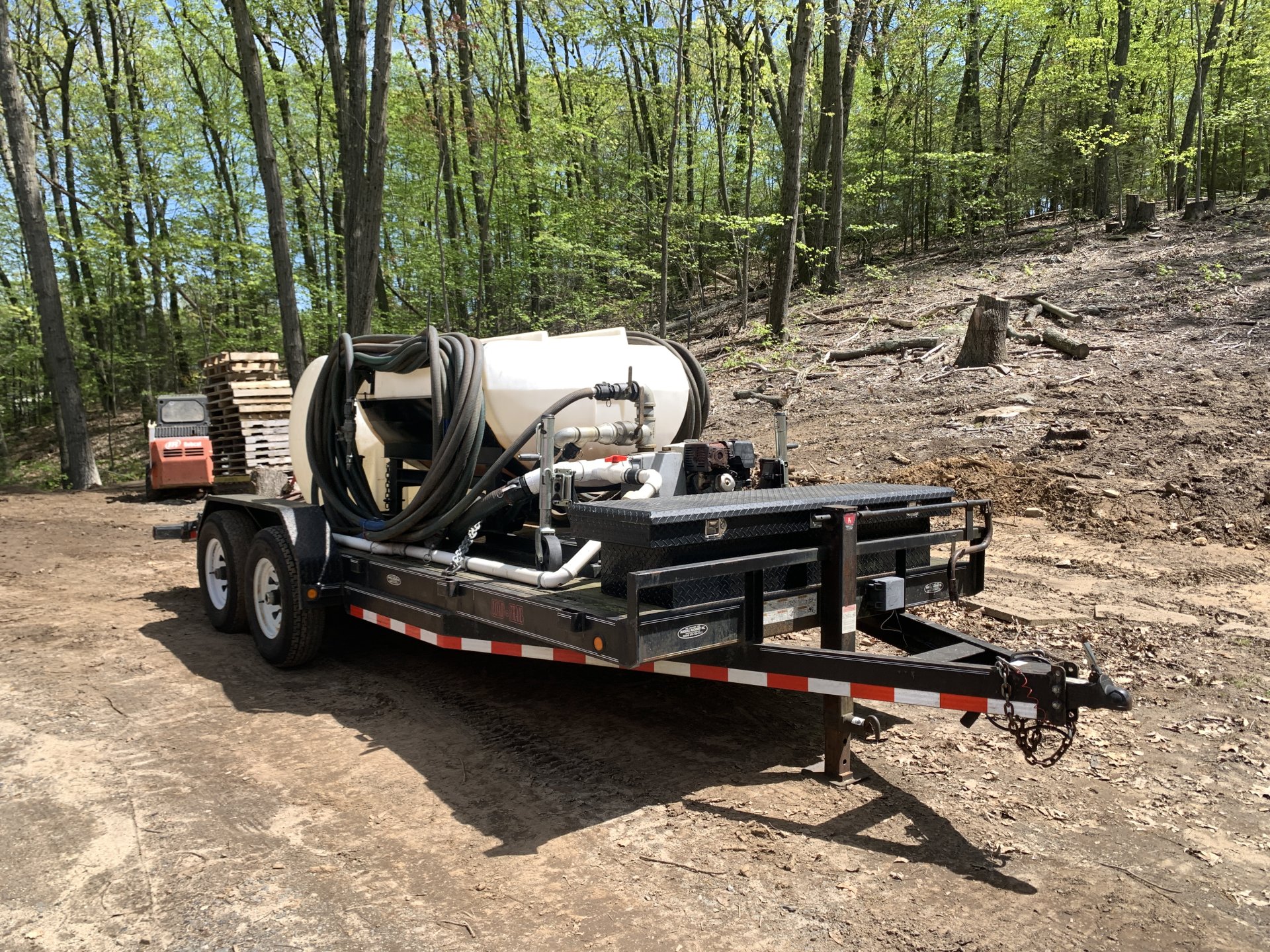

What is the pumping unit for?
I am thinking with the correct nozzle it could spray just about anything. I bought that trailer and unit because I needed to put in a lawn. I have been using it twice everyday to water. I can get almost the entire lawn from the perimeters. I only have one impulse sprinkler in the middle. I fill those (2) 300 gallon tanks in a little less than 2 hours with my well. I apply the water in about 20 minutes to the entire lawn.
