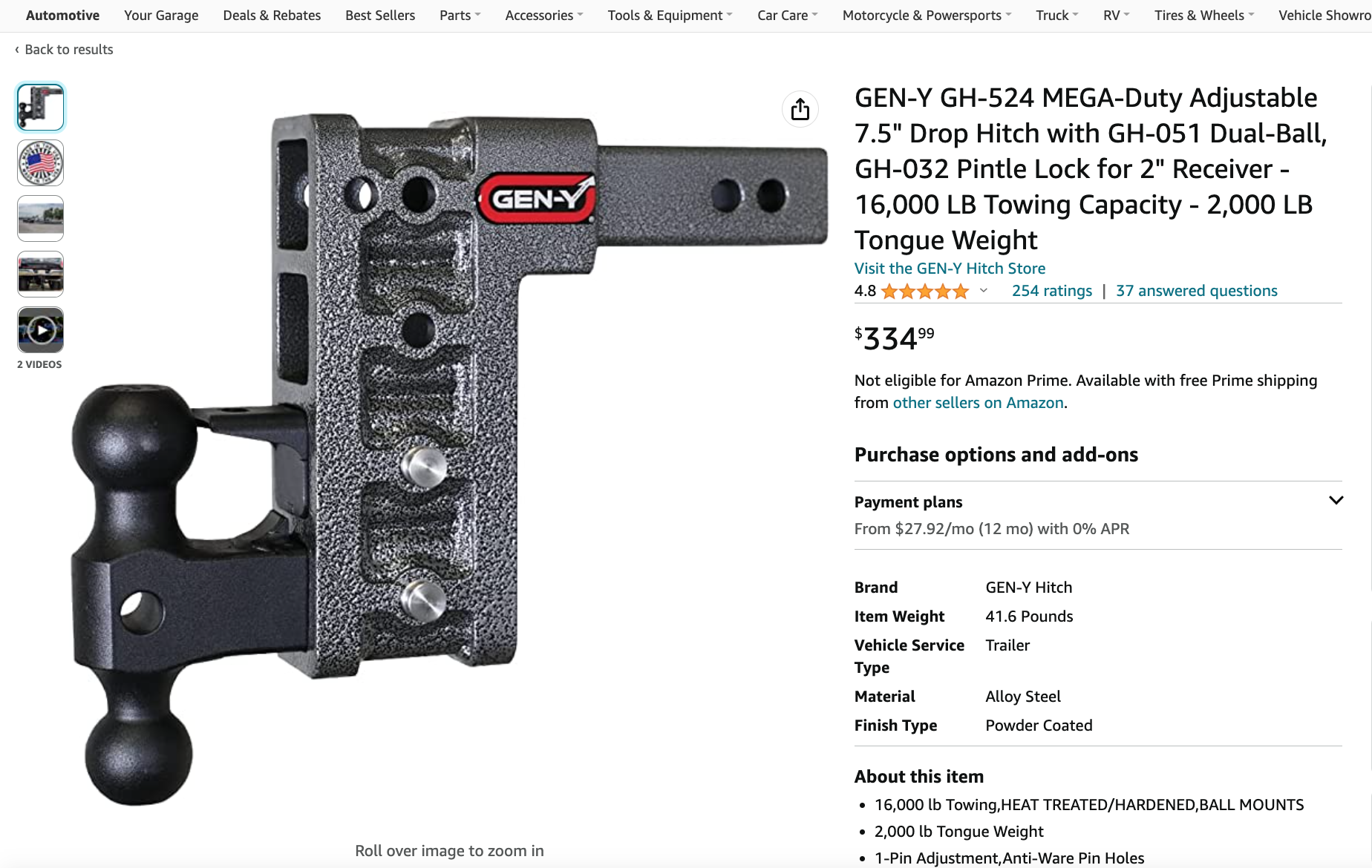

Understanding the Yukon would not be the preferable tow vehicle, if hitch heights were comparable, it would be a nice option if going across town to fetch or drop a load that would not exceed the Yukon tow capacity. I am entertaining getting this hitch.
