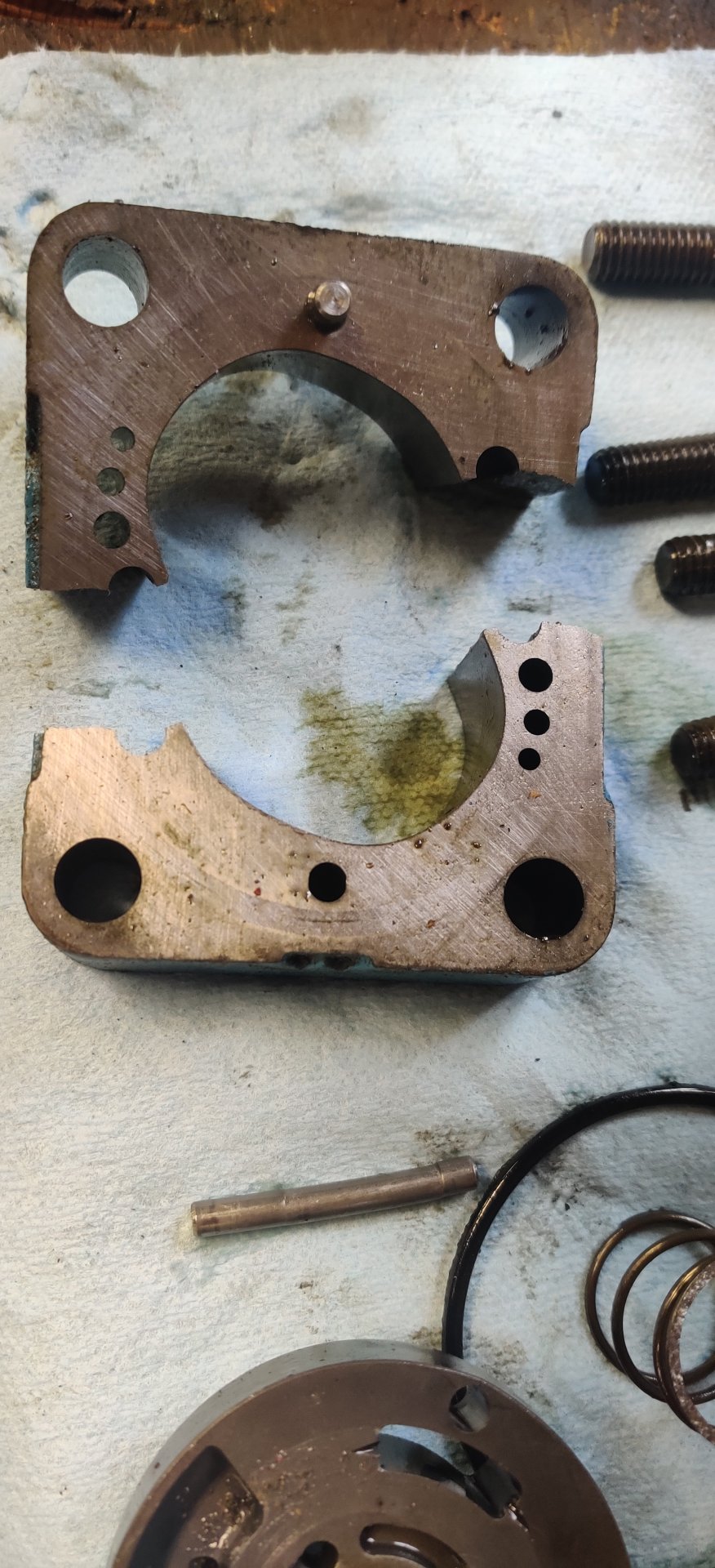

I have a 1997 Bobcat 863 which cracked the hydraulic gear pump. I found that and have a new pump on order, arriving in a couple days. Now I'm trying to figure out what could have caused this issue in the first place. The crack goes directly through one of the bolt holes holding the pump onto the hydrostatic assembly, so my initial thought was that some water got in that bolt hole, froze, and broke the pump. But lately I'm wondering if the relief valve is bad. Then the previous pump could have seen far-too-high pressures, and cracked the housing. I don't want to repeat that story again, if this is the case. What's the best way to test that relief valve? I don't have any pressure or flow testers on hand. Can I just buy a 6k PSI pressure gauge and a hose, and attach it to one of the quick connect aux ports or tilt cylinder, then check whether the relief valve is working? I'm a bit afraid of that approach, since it seems like if the relief valve is set to high I'd effectively deadhead the machine into the valve and maybe blow up another pump. Grateful for any help ya'll can spare.

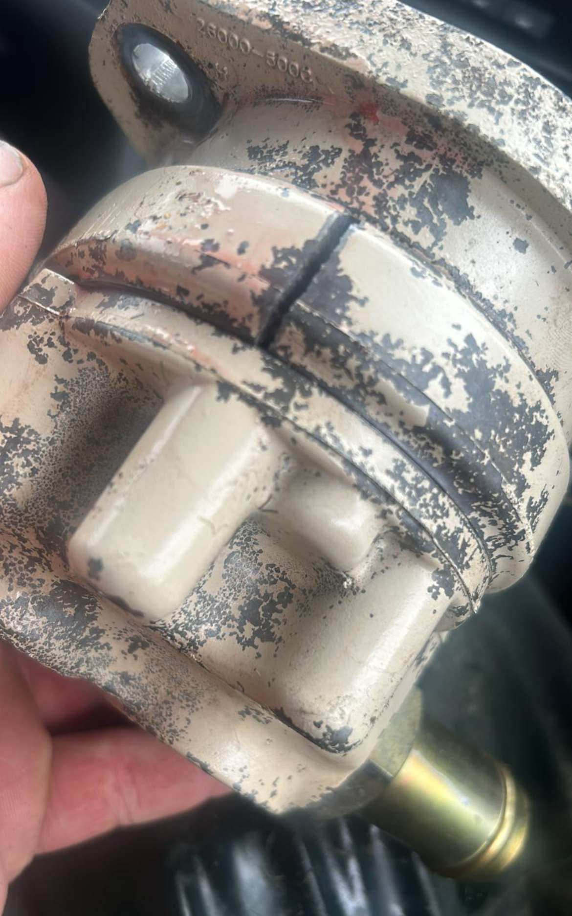

I have the exact same issue on my 553 although i fitted my new pump and it did exact same thing did you ever get to the bottom of your problem dont want to keep buying new pumps at crazy money
Looks like three of us have the same issue. I just posted for the same issue on another thread and am afraid to break another pump.
What model is your machine this is my pump x2 🙈

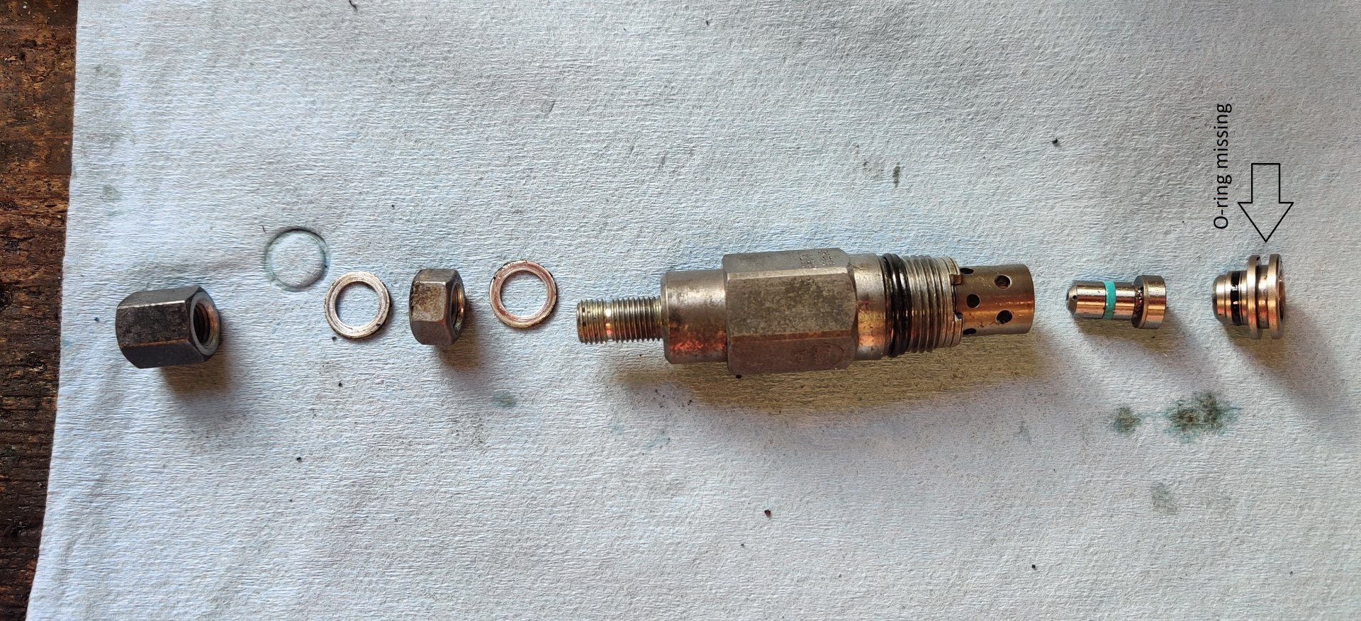

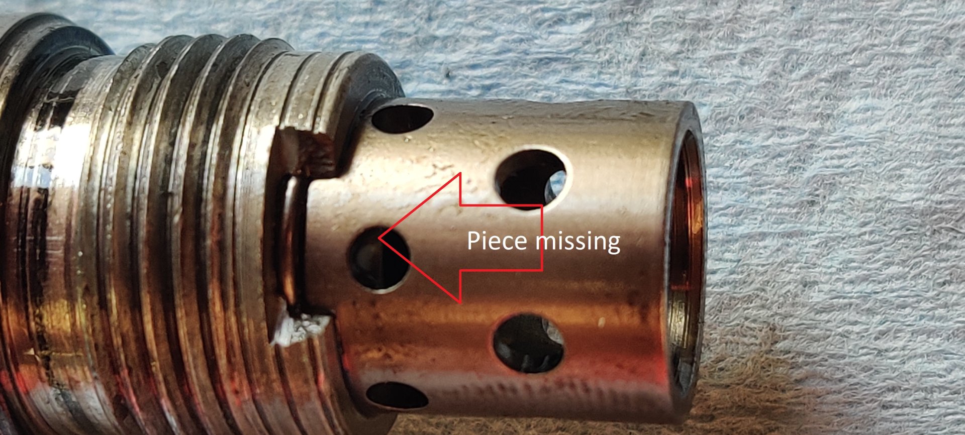

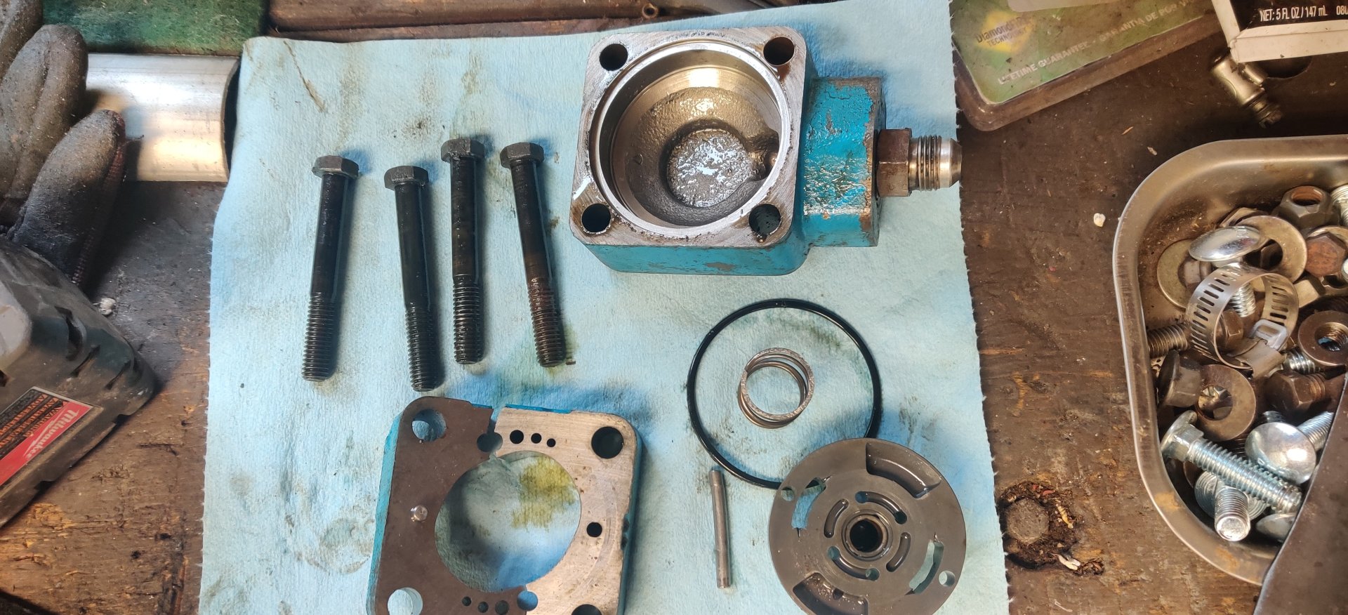

OK, did a little more digging and pulled the relief valve. two things. One, there was no o-ring on the end and two, it looks like a part broke off (see close up).
Next step? From the relief valve, where do you guess the broken piece/O-ring would have gone? Hoping it stayed in the hydraulic system and did not go into the hydrostatic system, but not sure. Not looking forward to pulling every hydraulic part and inspecting it if i can figure out where it might have gone before it can damage anything else.... Thoughts?

Personally I wouldn’t pull it id guess it would give your drive motors some grief if yours is like my 553 your oil will be filtered after the relief valve and before the hydrostatic so fingers crossed the filter will catch it

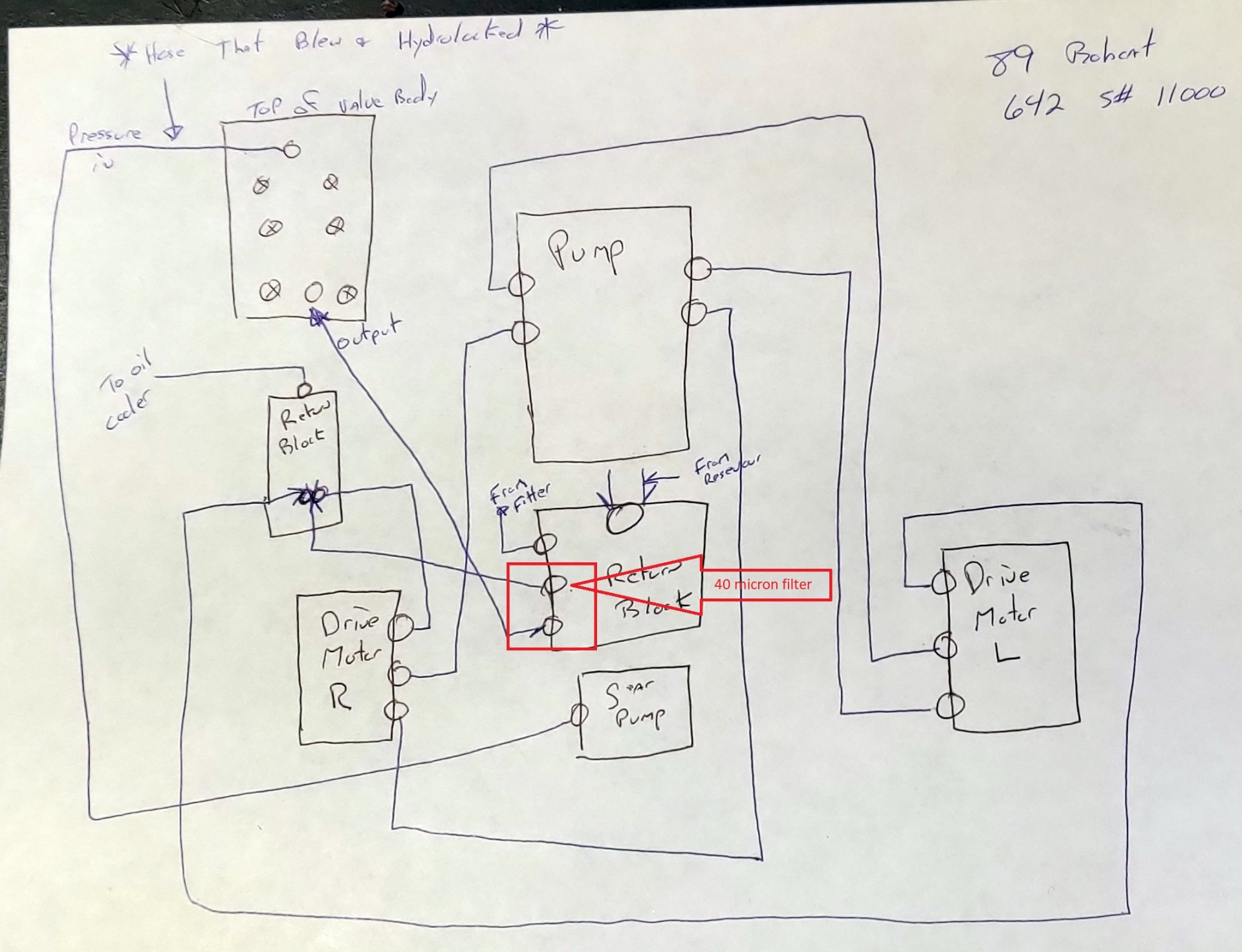

Mikey, you get the gold star and virtual beer of your choice. You gave me the push in the right direction by saying "the oil is filtered after the relief valve". My mistake, i crossed two hoses when i put things together.
As you can see in the diagram, the middle port has the 40 micron filter and not the forward one. after buying a new pressure relief valve and swapping the hoses, the old girl is working perfectly. Also, after more closely reading the service manual, it said what you said, "the fluid flows from the control valve to the 40 micron filter".
Once again, my thanks...

Mikey, best of luck on your bobcat. I find it odd it happened twice for you. Really hope it is the pressure relief valve. I found out there are two pressure relief valves on my Bobcat. One for the hydrostatic drive and one for the arms/bucket. Luckily the arms/bucket was real easy to swap, less than 10 minutes.

Just got it up and running this morning it’s obviously been the relief valve as all good now very very strange for a relief valve to fail that way id of thought it was more likely to fail the other way round and loose all pressure
