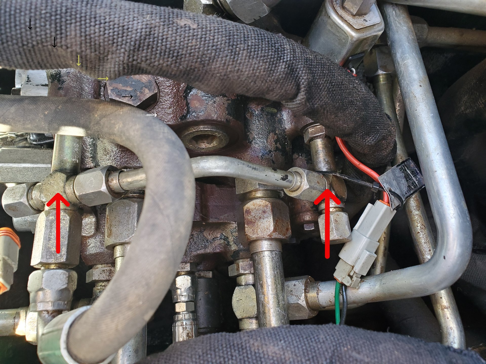

Trying to figure the fluid flow direction on the auxiliary side. Does charge pressure enter the stem valves here through these tubes?
    580.4 KB
How does pilot pressure reach the auxiliary stem valves exactly. After all my research and testing it seems like there is not enough pressure reaching the stem valves. My charge pressure into the bics control block is about 360psi warm at idle. On the pic, is this pipe the bleed off for the spool ends? Does fluid return back through the stem valves in these lines wich are plumbed into the lift bypass and drive motor?
