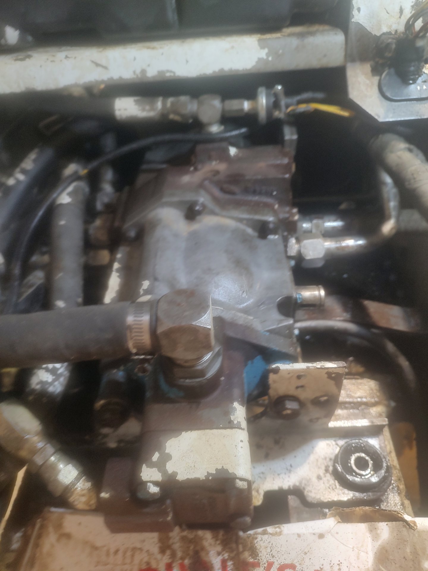

Hi guys, new to the forum.. I've been battling with a bobcat 743 for so long, it's almost made me crazy..
The problem I'm having now is the left side drive, at idle and at mid RPM the wheels work fine, but as I increase the throttle to full throttle, the will stop moving and has no power, also I have nothing in reverse..
Any ideas as to what I'm supposed to look for, by the way I've switched the drive motors from side to side and they work the same
I'm going to pick up a new main filter tomorrow.. are there more?

I've seen those on other 743's, but my pump is different.. I don't have that box on the front with the lines going in the front.. mine comes in from the sides d there are no filters in there
