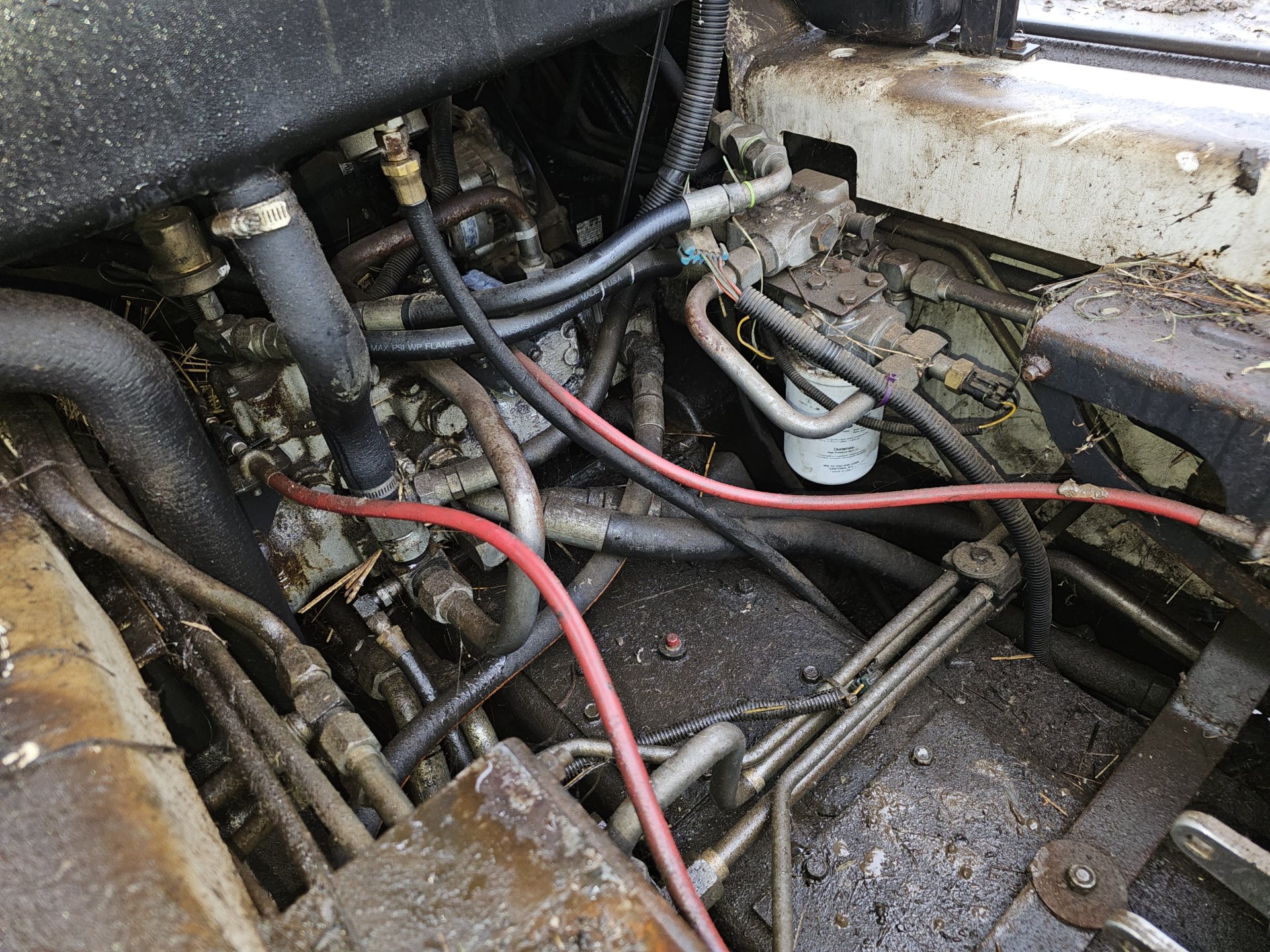

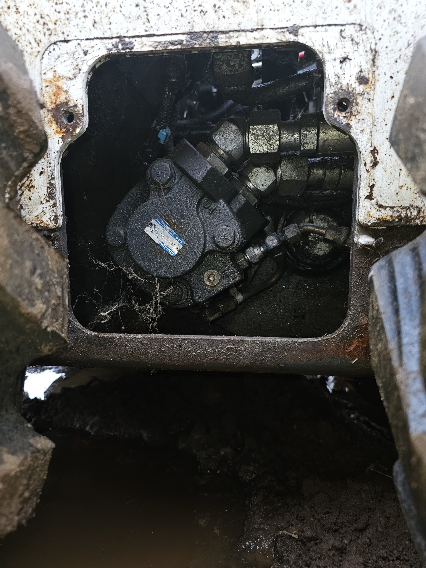

Lost left side drive slowly over a month, all linkage is good from handles back, replaced filters, no obvious leaks at left side drive motor..was convinced it was the main "pump" but now I'm leaning toward the drive motor.. is there anyway to check line pressure without removing the drive motor? Thanks for any help...
