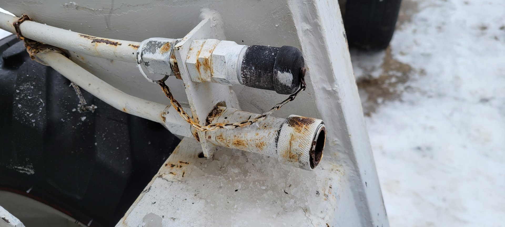

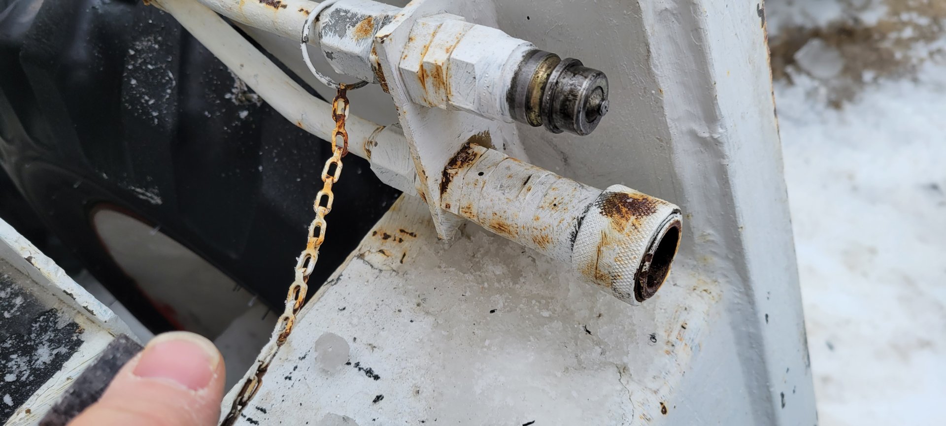

My machine IS a repaint... But here's my pioneer couplers.

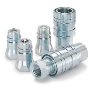

There are even special Pioneer couplers that have a tiny pressure relief button in the tip that makes it much easier to connect under pressure. I'll have to see if I can find a picture later.
Kinda small blurry pic, but here ya go.
Far left is the easy connect. Then next is ball type, then next is the non easy connect... I think both non-ball are called high flow? It's been a few years. :)

So I haven’t been down to look yet but I do know all our tractor implements use the pioneer connector. But the hookup are all male, I feel my 743 has a male and female. Can I just change them out to both female?
if you do you will need to mark them as to hook up so they can go to the same port each time( a port and a hose and b and b), as if you flip them your controls will reverse in the machine at random if you did not and that would be as a operator irratating.
Those couplers came as standard equipment on your bobcat, they only changed over to flat face couplers in the mid 90s. They are set up as one male and one female so you can't hook an attachment up backwards. If you do switch them over to both females you should do as foton says and mark them so you hook things up correctly every time.
