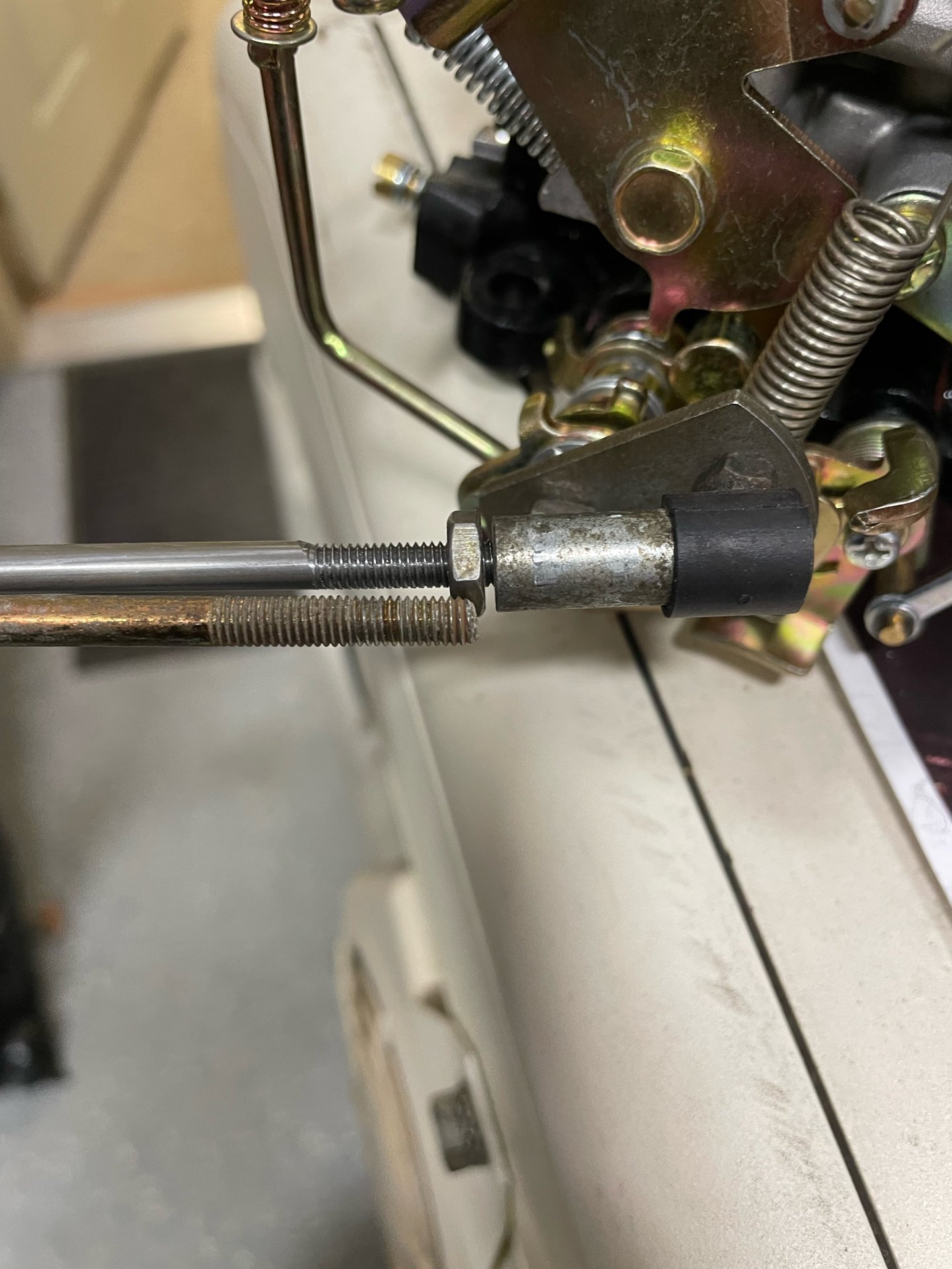

The last picture kinda shows wher I removed the linkage for the cars cable and added the lever for the original bobcat linkage. all worked great.

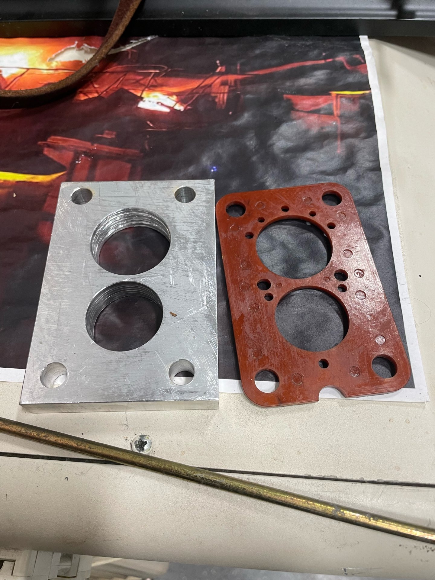

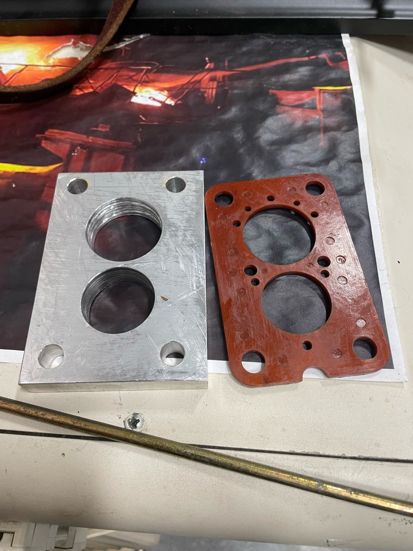

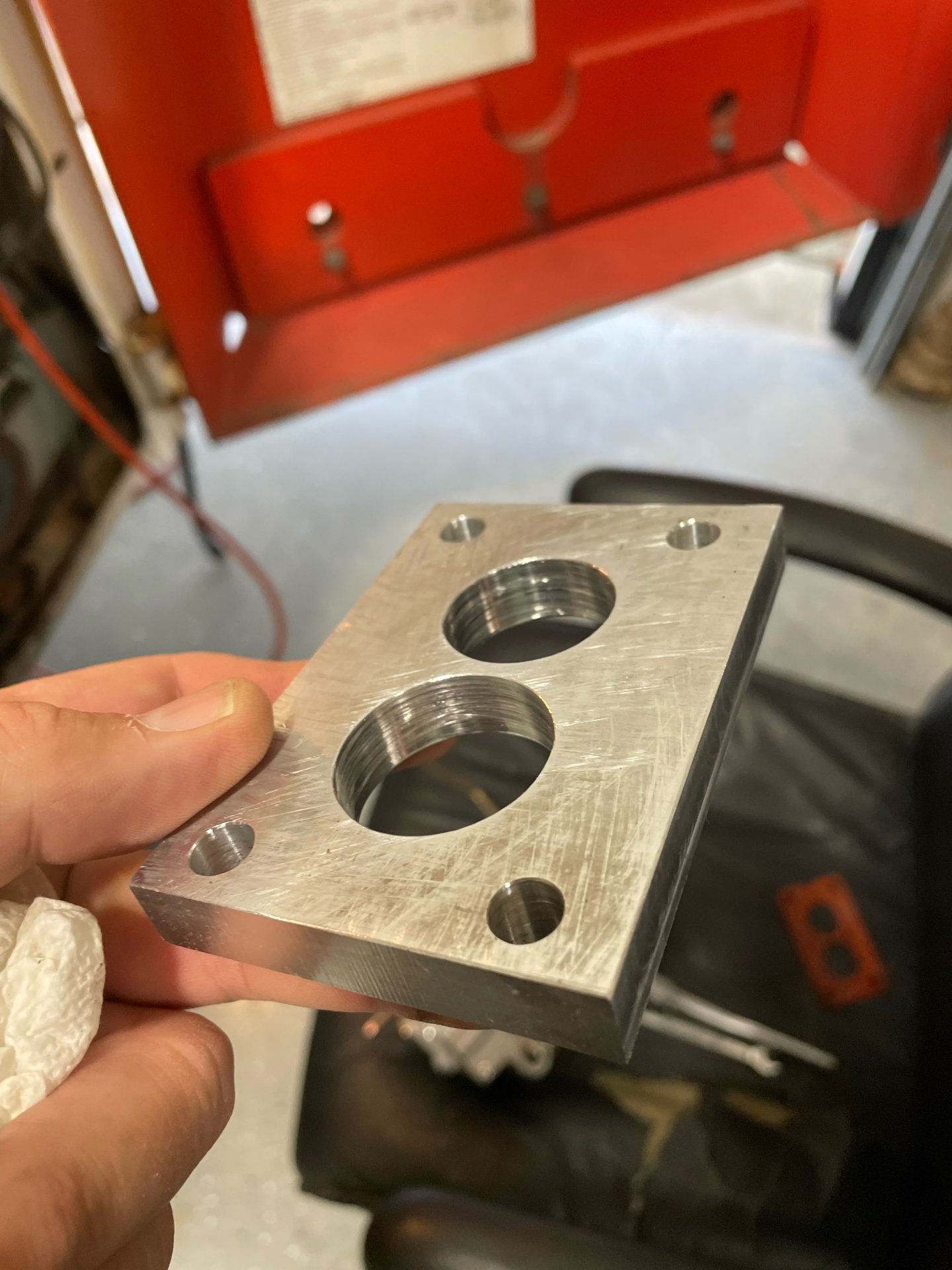

I made a half inch aluminum spacer and used the plastic spacer from the original carb to get hight to keep linkage from interfering with manifold. Made longer control rod from governor, and will open up the air cleaner adapter to fit the new carb, (it's a little bigger than original)

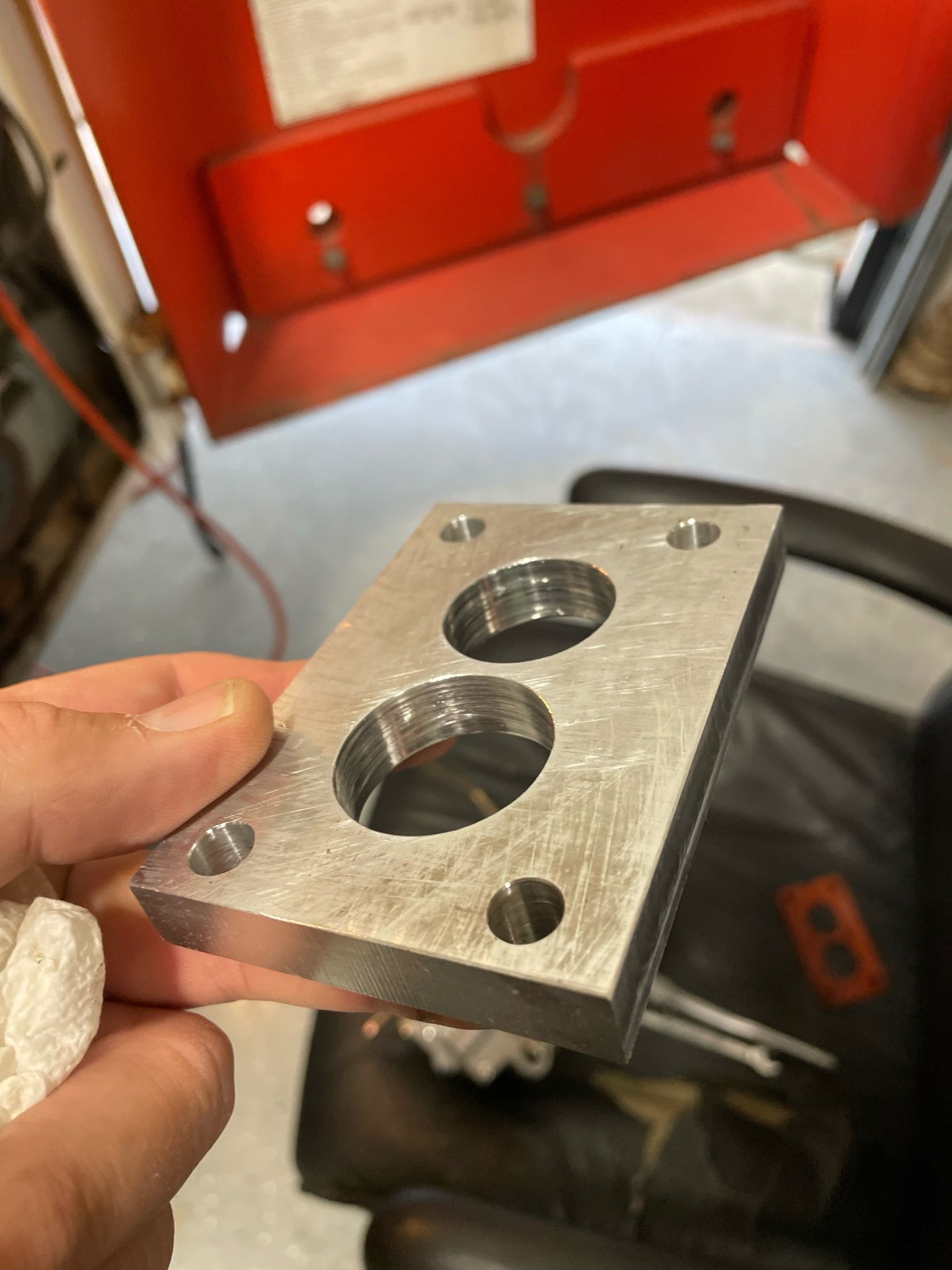

Nice .how you make the spacer? You have a mill?

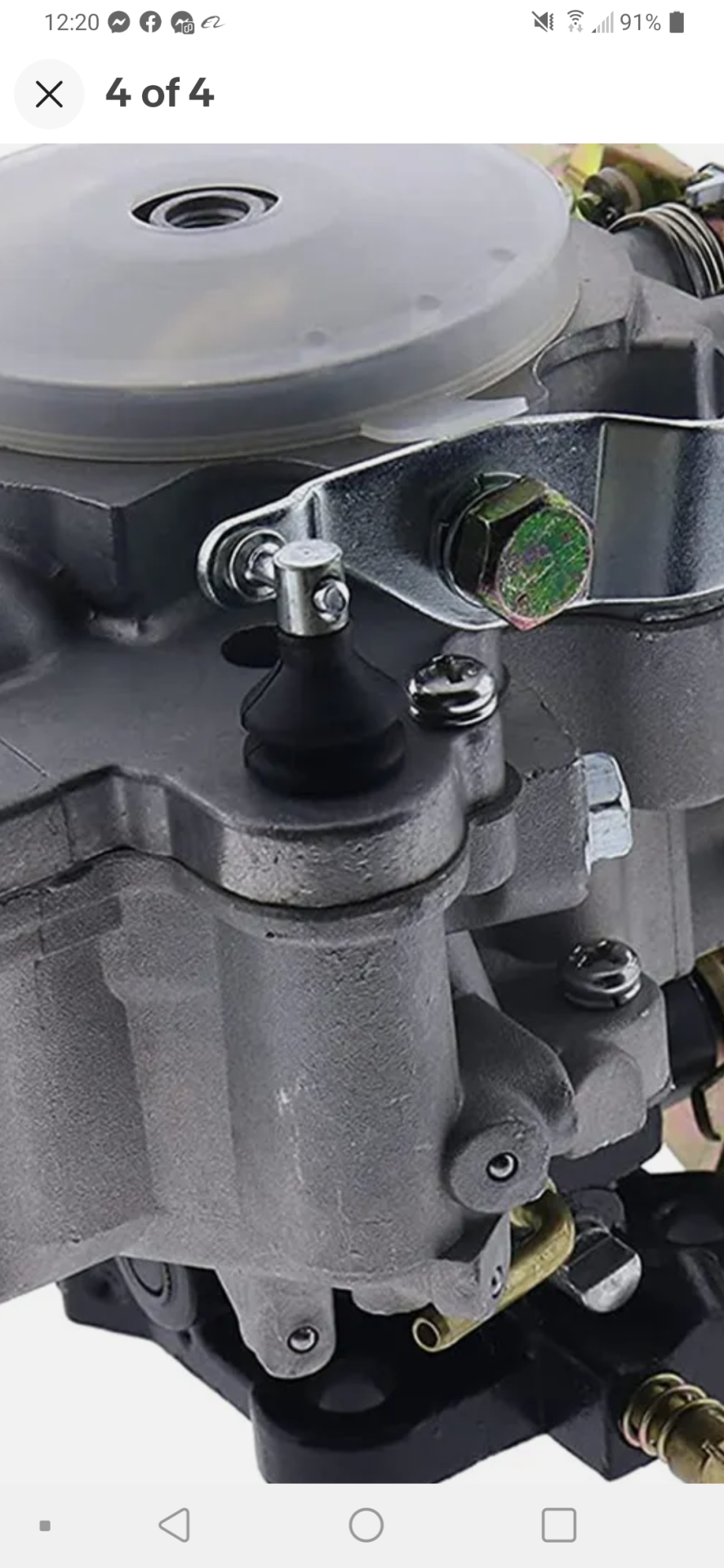

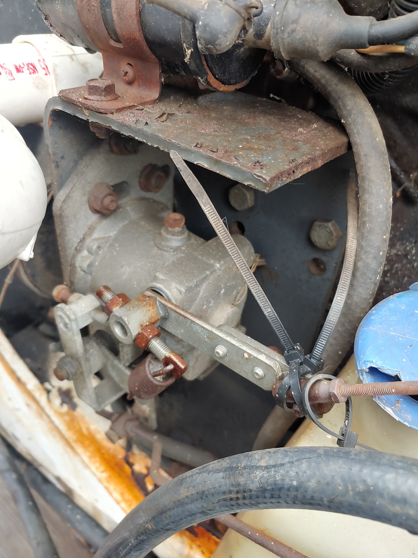

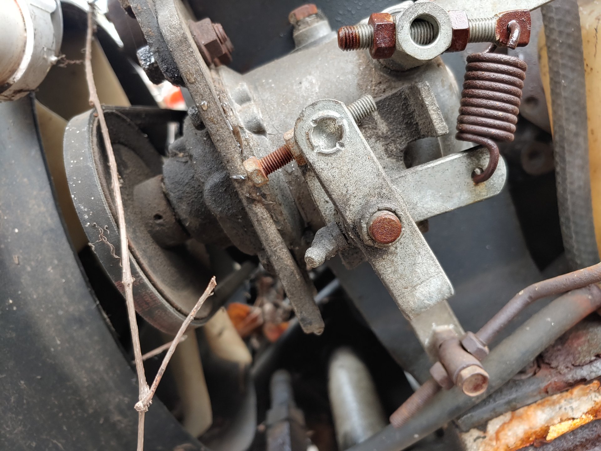

Does your machine have some contraption that runs off of engine belt that has linkages to carburertor? Looks like a mini smog pump but its not. Weird thing i dont think its a governor
A car carb doesnt have accelerator pump does it? Does it have the governor like in photo? If it does is it still operational?

Yes, I have the same govenor and the carb I bought does have an accelerator pump internal. Made the spacer on my mill but could be done on a drill press. 1/2 inch aluminum and I used holes saws for bores. Used the pastic spacer for a templet.
I never saw a carb with internal accelerator pump since they all need a lever attached to throttle somehow. Even on little dirt bikes theyre external. Maybe its the plunger thingy

Yep that is the same accelerator pump. Should have said integral not internal. I know how people like to slam.

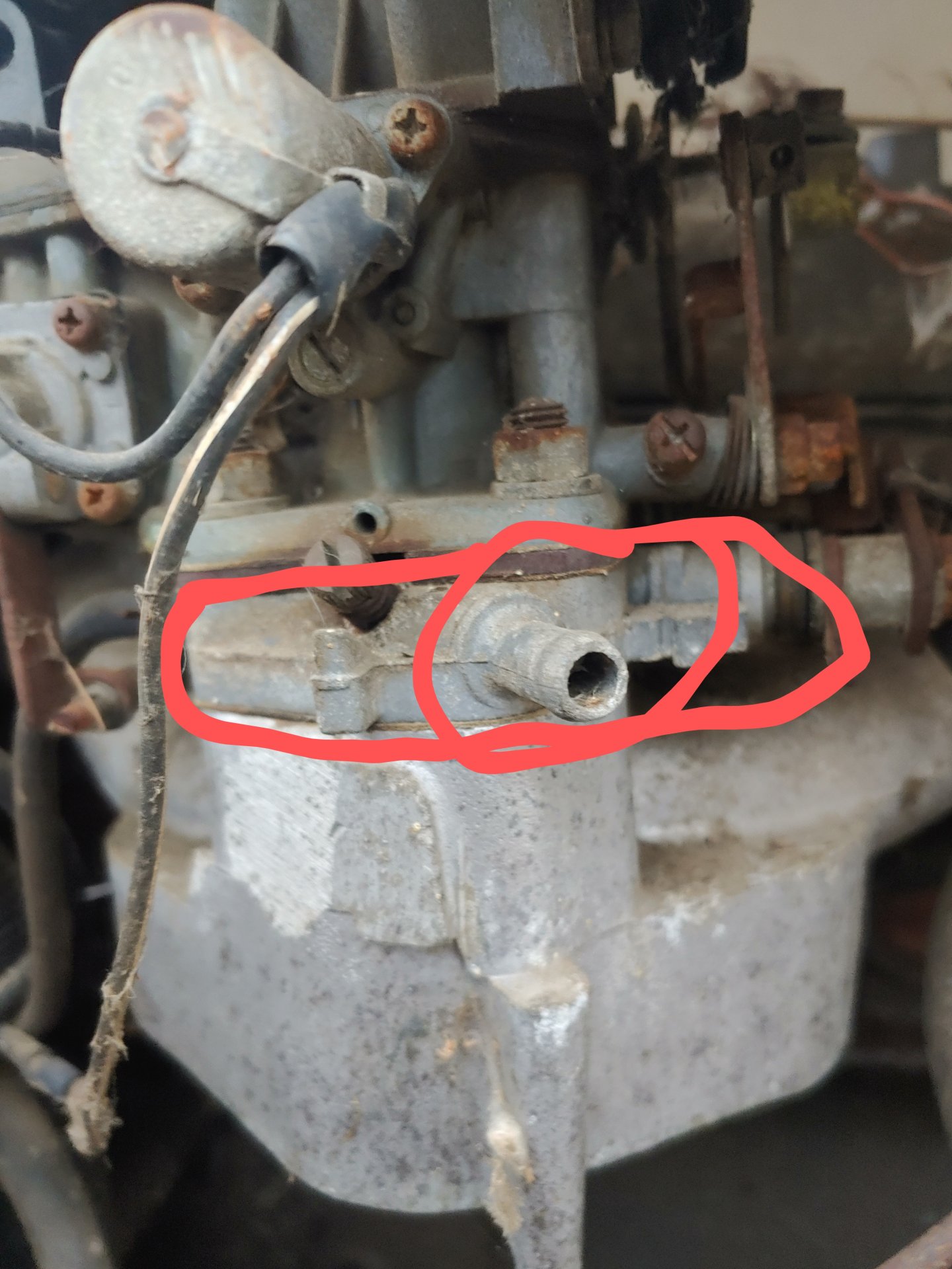

Got a pic of it on the engine? What about the factory spacer plate? What does that large vacuum nipple go to?
My 742B has no vacuum under any throttle positions at that large vacuum nipple. It appears to be blocked off. I would call it a dummy that is not used in this application.
The big vacuum port on mine is open. Do you have the part# on your carb mine is in photo.maybe mine off something else.?
28-32DID SA27
If there is not a hose in need of a vacuum source that is not hooked up, I would just cap the nipple off. Being that yours is now an automotive carb, that port could have been used for something like power brakes.....that I am guessing you don't have. Cap it off, you will be fine.

I did much the same--bought an ebay carb, made a 1/2 inch spacer, made a longer governor rod, made a new connector piece to go on the butterfly shaft with the right angle for the slot so it would best connect to the governor rod, and dinked with it a little so that the butterfly opened only to fully open, not beyond full open, and adjusted the throttle lever for fast and slow speeds. As to blocking the secondary, I just made a single hole in the 1/2 inch spacer, and disconnected the vacuum mechanism that opened the secondary butterfly. Seems to work fine and runs better than before--always seemed overly rich in the past--nasty exhaust. I do wonder if it is now running too lean, in that an auto carb would be looking for fuel economy, and a Bobcat for maximum torque (meaning running somewhat richer than optimum for economy). The only downside that I have definitely noted is that there are two nozzles for the accelerator pump, so the secondary nozzle squirts into a blocked off hole, and eventually leaks out around the butterfly shaft thence to outside the carb. Not much of a problem since you generally set the engine to one speed and leave it there. Had I anticipated this I might have soldered it shut, but am just leaving it for now.
forgot--has to make an adapter for the carb to intake casting too.
