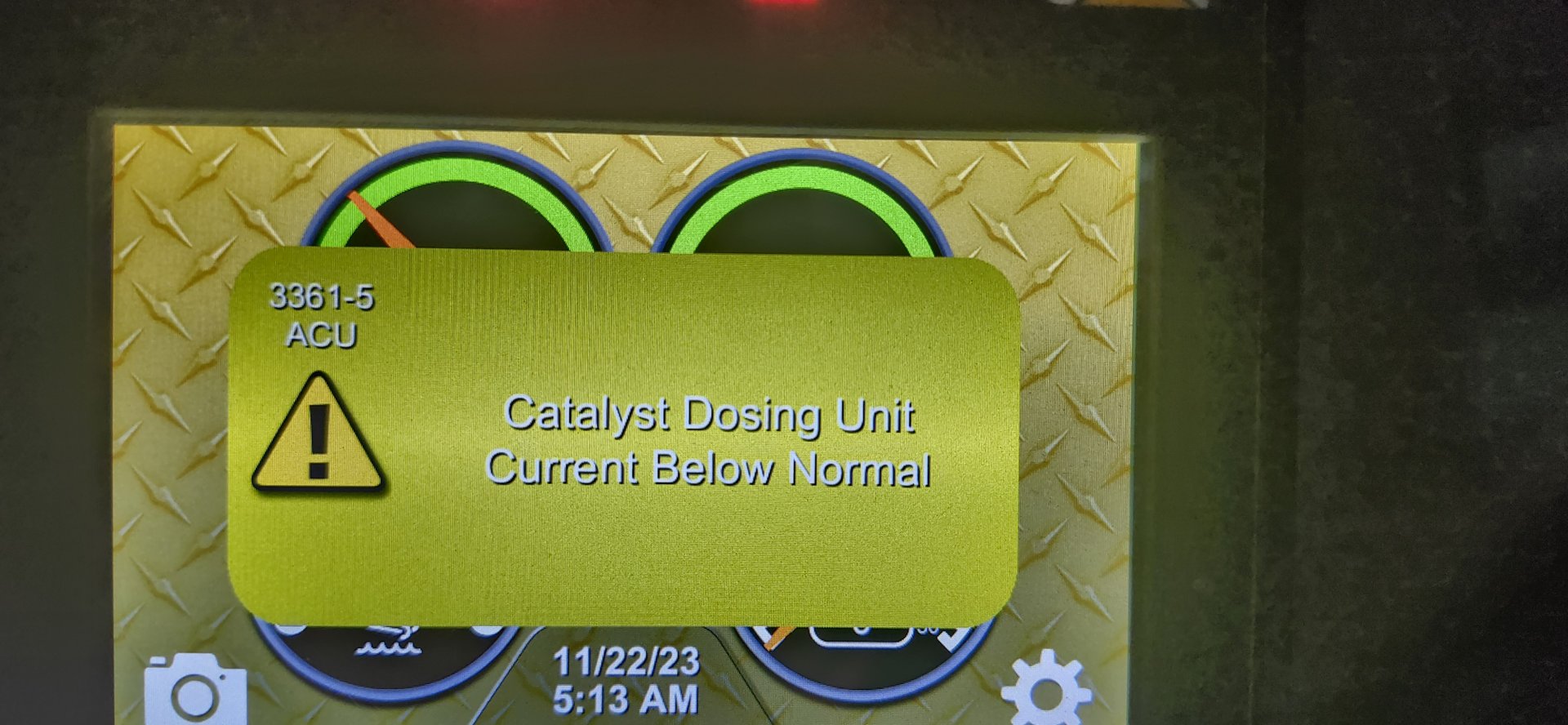

W Whitety1025 New member Joined Nov 2, 2023 Messages 4 Feb 28, 2024 #1 2018 Caterpillar 299d code 3361-5 Seems to be running fine so far but I haven't used it with the code on Any help on how to clear this code would be appreciated, thank you. Attachments 20240228_105038.jpg 265.7 KB
OP OP W Whitety1025 New member Joined Nov 2, 2023 Messages 4 Mar 2, 2024 #2 Just an update for everyone. The problem was the Line came loose on the def injector. Plug it back in and it's work in perfect..
