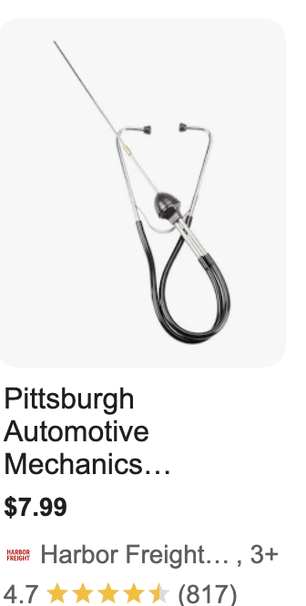

It difficult on a video clip as the noise we hear on the clip isn't always what is happening in real life...but if it was me.....I would get a cheap mechanics stethoscope from Harbor Freight or amazon and start by trying to work out if it is the top or bottom of engine, then if it is the top i would pull the rocker cover off and check the valve rocker clearance and springs are ok. didnt really sound like bottom end to me which i expect to be more of a dull knock, but as I said it not easy on a video.
