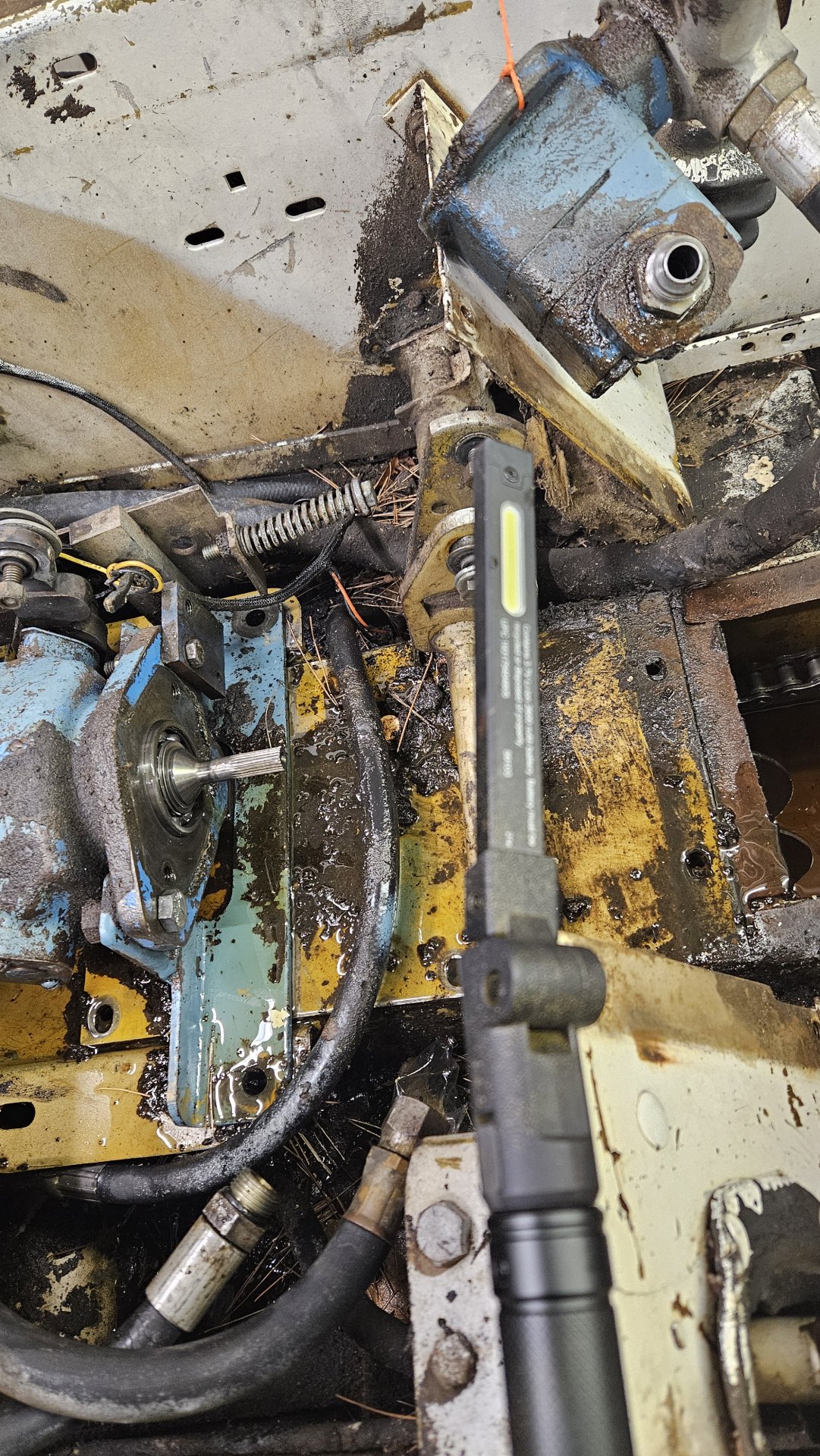

Well I got the front pump valve thing off tonight. The book shows a o ring part #6519704 that should have been between them. There was nothing when I took it apart.. No gasket or oring. Have you hade yours off yet? It is the block that the fluid goes on from the tank.

I've never had the front portion of that pump apart. The back section I took apart uses a gasket that is pressed steel almost like a head gasket, but I don't see anything like that for the front. I'm looking at the diagram too and I agree, it looks like an o-ring is the only thing needed. I got some hits when googling that part number, but I see a lot of "backordered" on the sites. If you have a Bobcat dealer nearby with a good parts counter guy you might be able to get some help tracking down that o-ring.

I have the 4 bolts out of the pump and it separated about an inch but wont come apart any farther? Has a hard stop like the shaft don't want to come out. Am I missing something? Is that shaft got some kind of keeper that wont let it come out more than an inch or so?
It's been a while, but I think mine pulled apart with no problem after I got the 4 bolts out. I worked on the side of the pump that connects to the engine. I'm not sure if the opposite side is different. I looked through the service manual, but it is pretty light on details about that pump. The parts diagrams don't provide many clues on it either.
It was actually catching on the plate underneath. Pried up a little and pulled right out. Stuck a wrench on the axle bolt and it wont budge. Cant start mine like you did to loosen it..Going to sleep on it tonight and come up with something tomorrow I hope.
