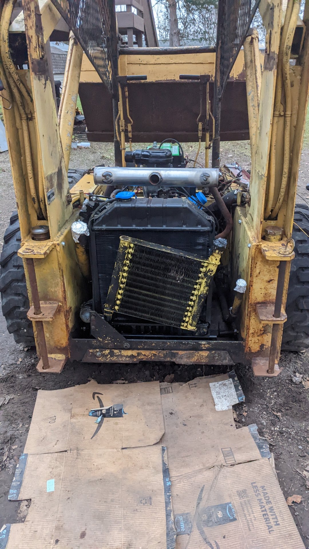

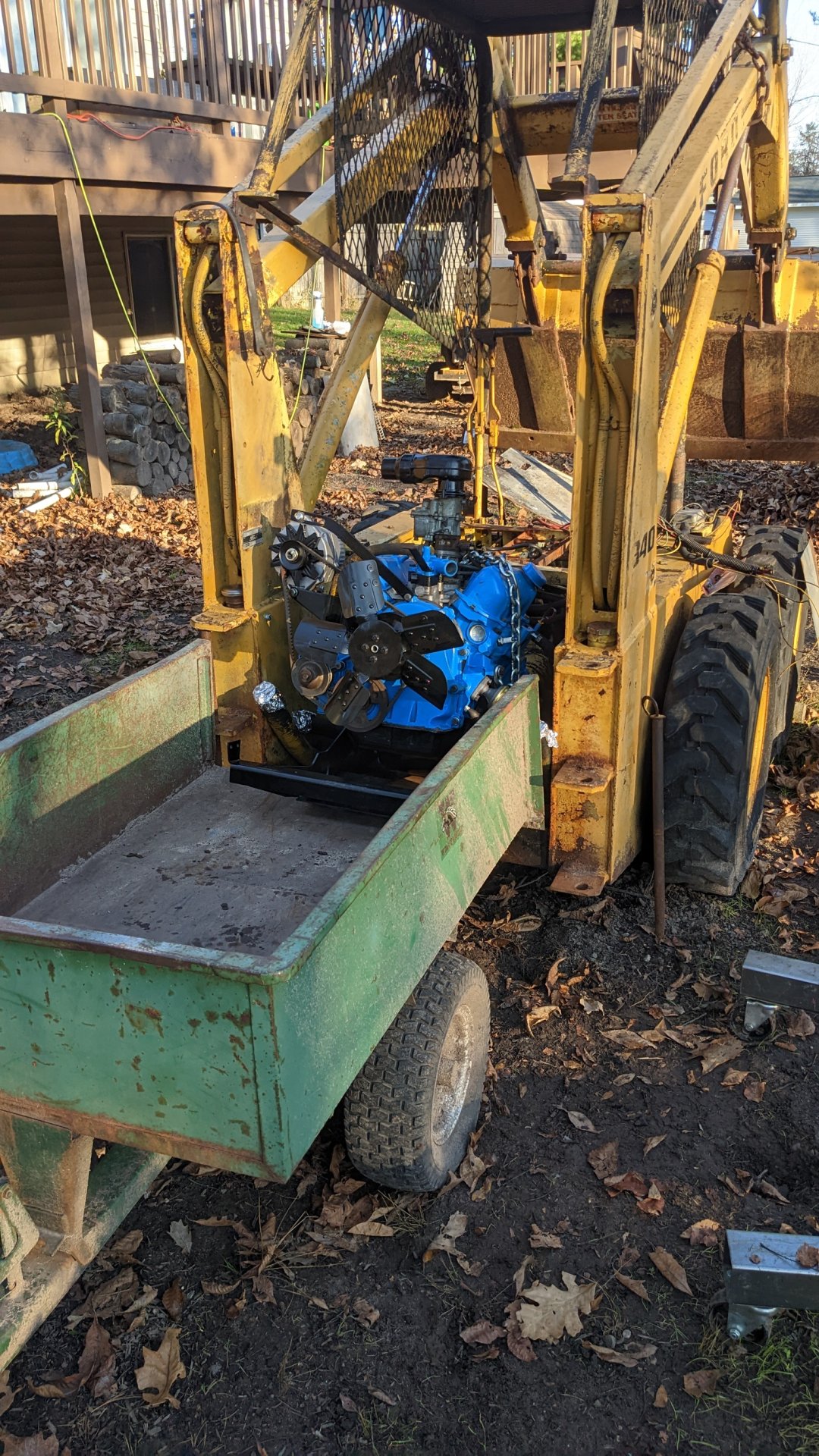

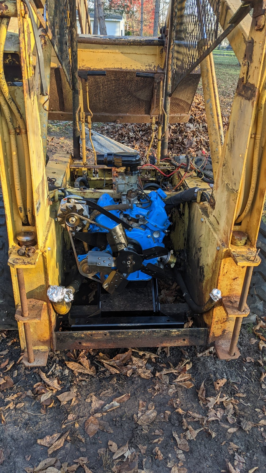

So I finally got the engine out of the garage. I set the engine into my small yard trailer and then backed it up to the skid steer and was able to slide it out and into place. Got it bolted down just before it got dark.

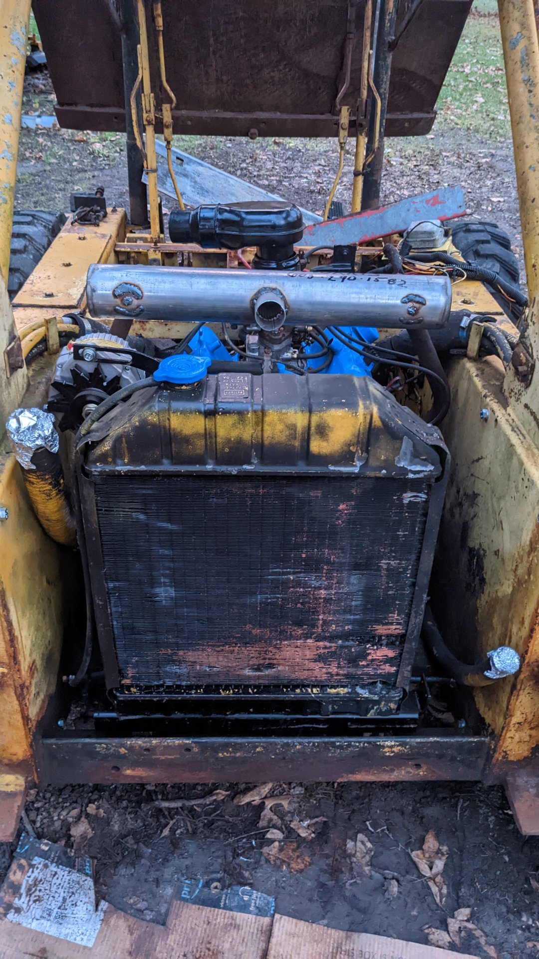

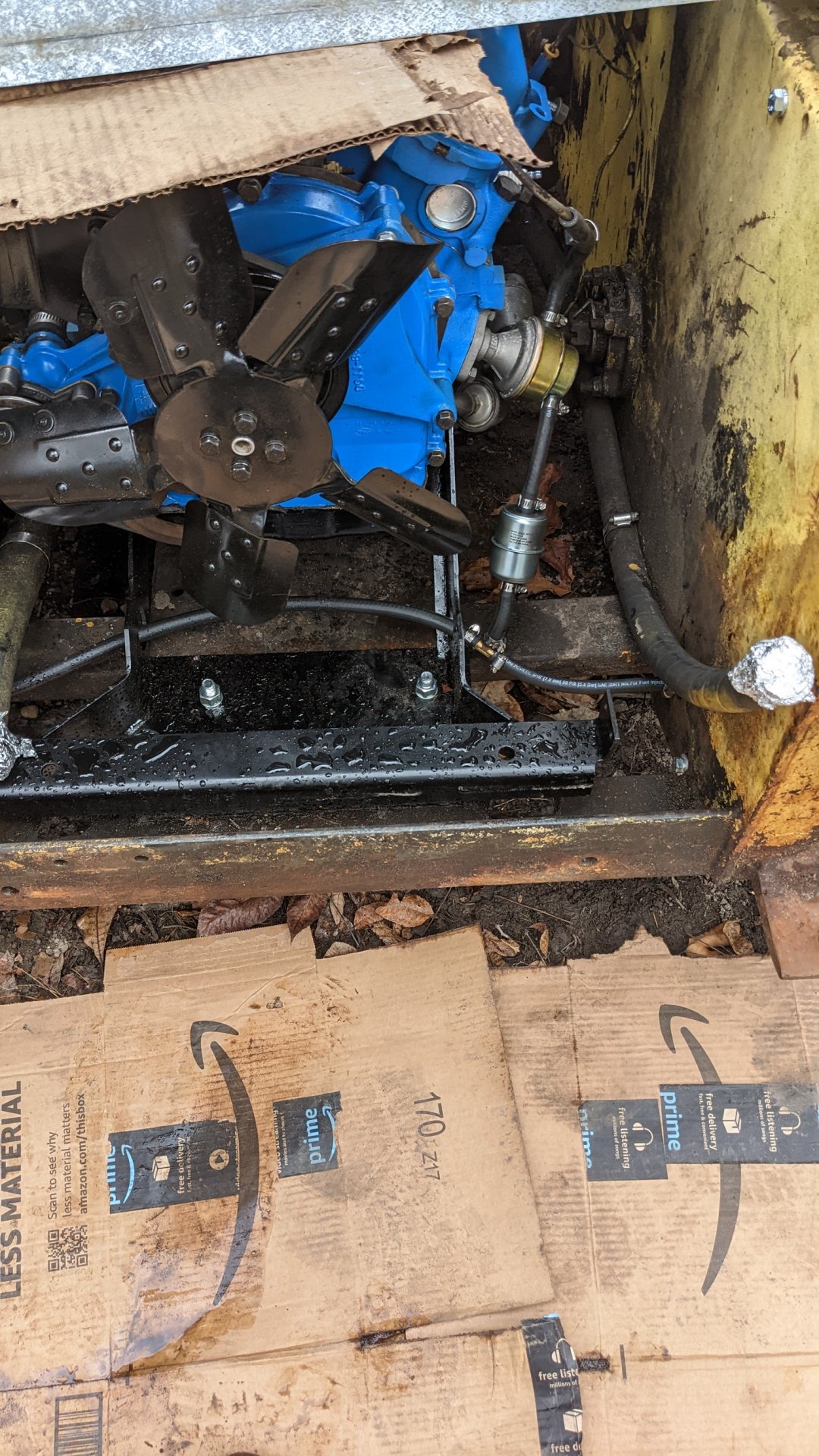

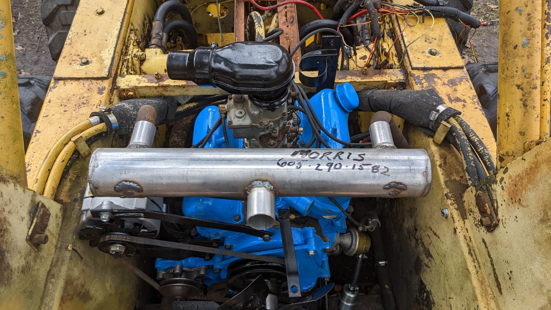

Well I got quite a bit done this week, but we have had a lot of rain so I have been fighting the weather trying to get things done.
So from the last post you can see I got it all bolted down but quickly found out that I had to unbolt the engine and slide it forward to be able to install the 1/2" bell housing plate the hydraulic pump mount to, as well as the hard coolant line that goes around the back and the bracket that holds the throttle linkage.
Installed the new fuel lines and fuel filter in place.
I also learned that when I set the timing with the distributer that my clocking was too far one way because the vacuum housing was hitting the cross member so I had to reset it so that it was clocked counter-clockwise so it cleared the cross member. Also installed the new spark plugs and wires.
Also got the header pipes and a brand new muffler installed. I got the muffler from John @ fordv4parts.com it bolted right up, I hope it wont be too loud but its going to be better than the two tiny mufflers it had before.
And finally I installed the radiator and all cooling hoses.

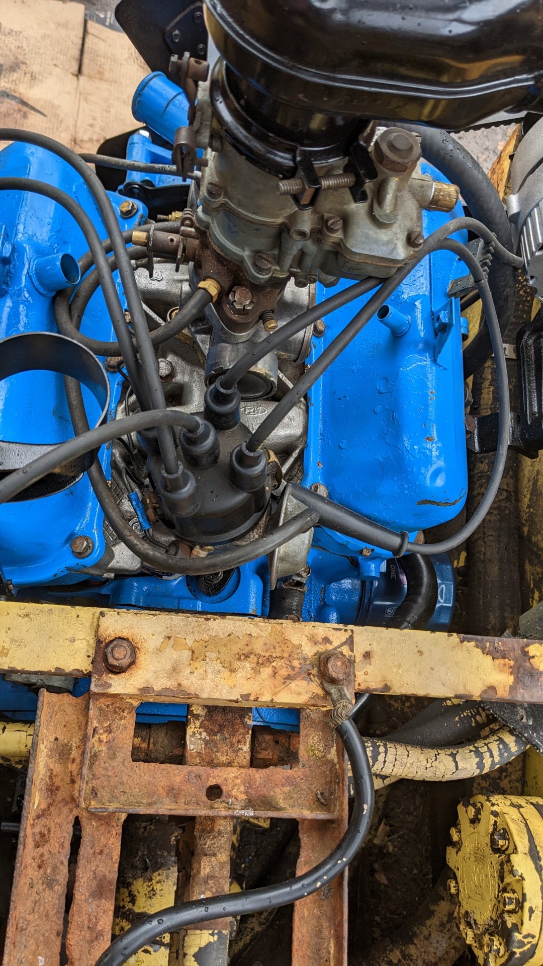

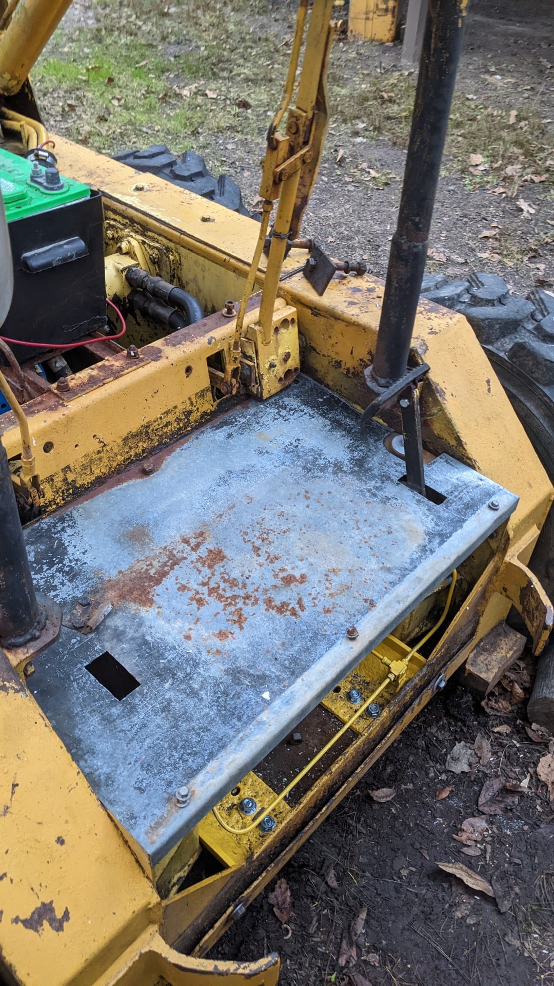

So I got the floor panel and brake pedal pad installed. Also got the hydraulic fluid radiator installed.

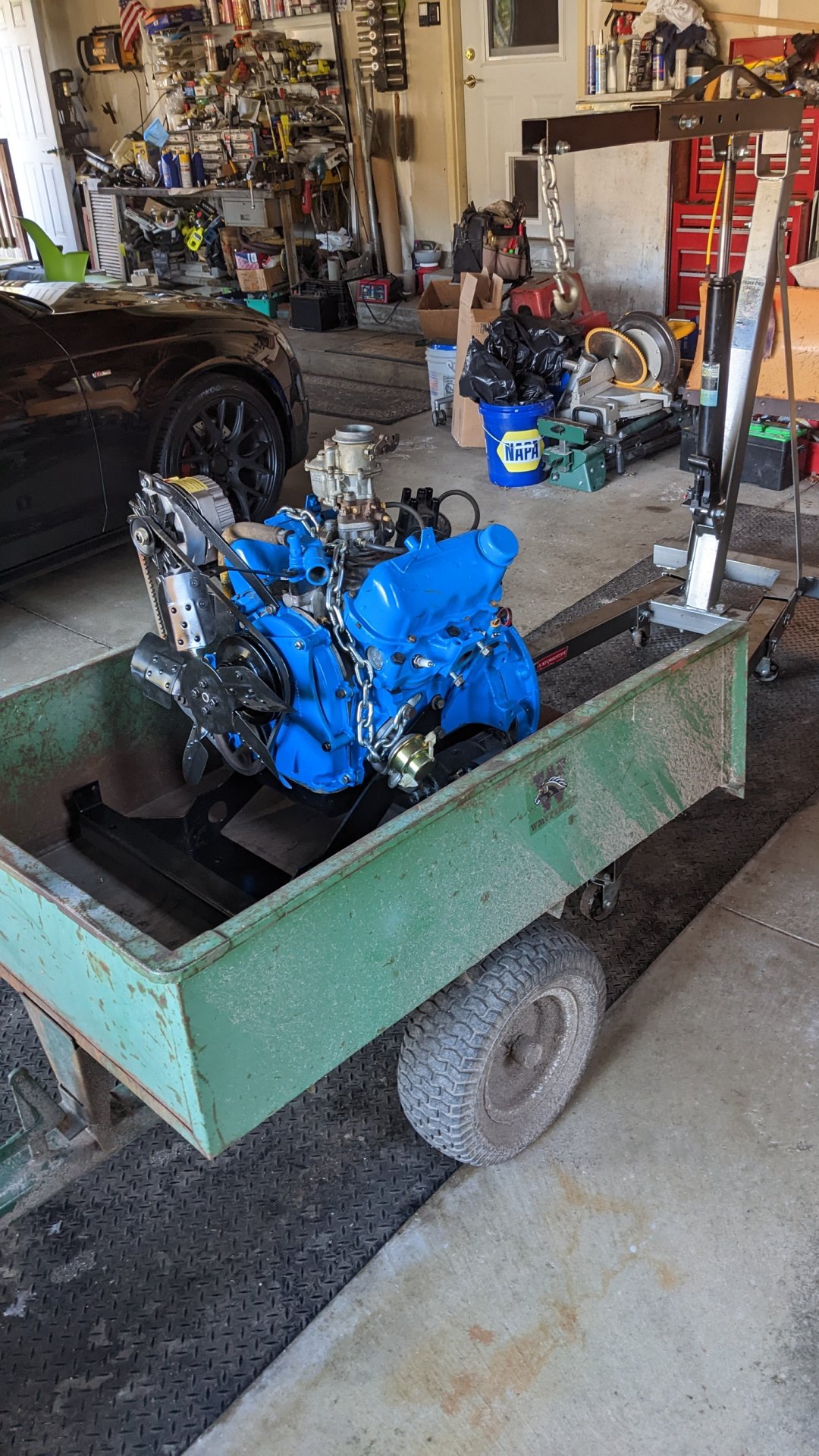

Another thing I did while waiting for the machine work was to redo the brakes. I took the access cover off and found that master cylinder was gone? Took the brakes apart and cold tell right away that the wheel cylinders were toast, there was plenty of pad left on the shoes but they were soaked in grease because someone must of pumped a ton of grease through the wheel bearing!
Spent the next couple of nights scouring the internet for part numbers but could not find anything because its so old. So I decided to start looking at old ford brake diagrams on Summit and found a match, $29 for the shoe set and $13 each for the wheel cylinders. All the springs were still good but I needed one of the adjustable spreader thing at the bottom $5 at Autozone.
