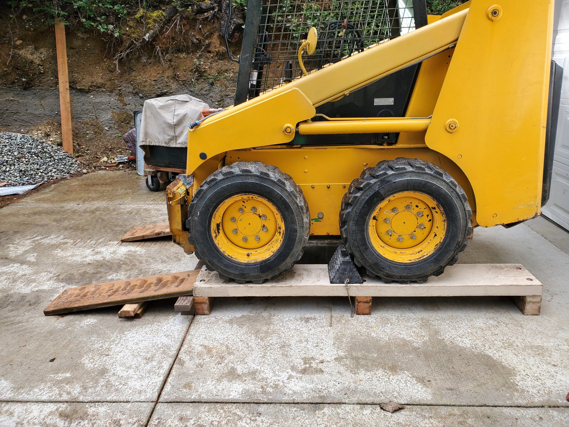

I built a pair of ramps from 4x12's, 2x12's, 4x4's, and 2x4's. Also works well with the dozer and mini excavator.
